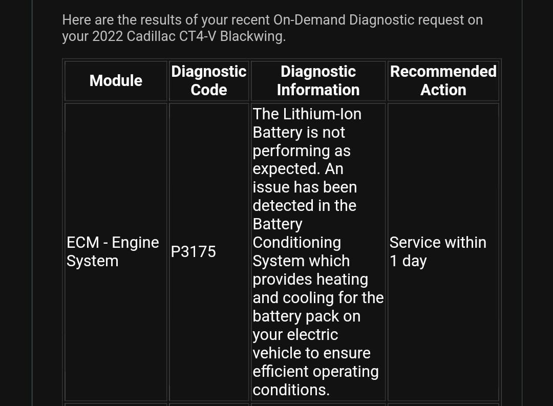

I've had some on and off CEL issues the last 3 days in the cold. Today it was on and wouldn't remote start so I called onstar and they ran a diag. Apparently my car now identifies as an EV. Has anyone had this happen?

Regardless of your car's identity issues 😁 , remote start is inhibited when there is a CEL. It's an annoying protection scheme even when the CEL is something minor.
Some other member posted about taking delivery of their ct4bw with the cel on and this was one of the two codes present. There was no follow up by that member in regards to the outcome though.
Maybe your car just needs some counseling.
Searching that code around the interwebs, it seems your car is not confused but whatever service that provided that code description definitely is.

So the issue is the active exhaust valves. Dealer called and said they needed to order thise, then he went on to say an entire exhaust system. I don't believe that I have aftermarket exhaust, but now I'm wondering.... I bought the car in September with 12k miles.
