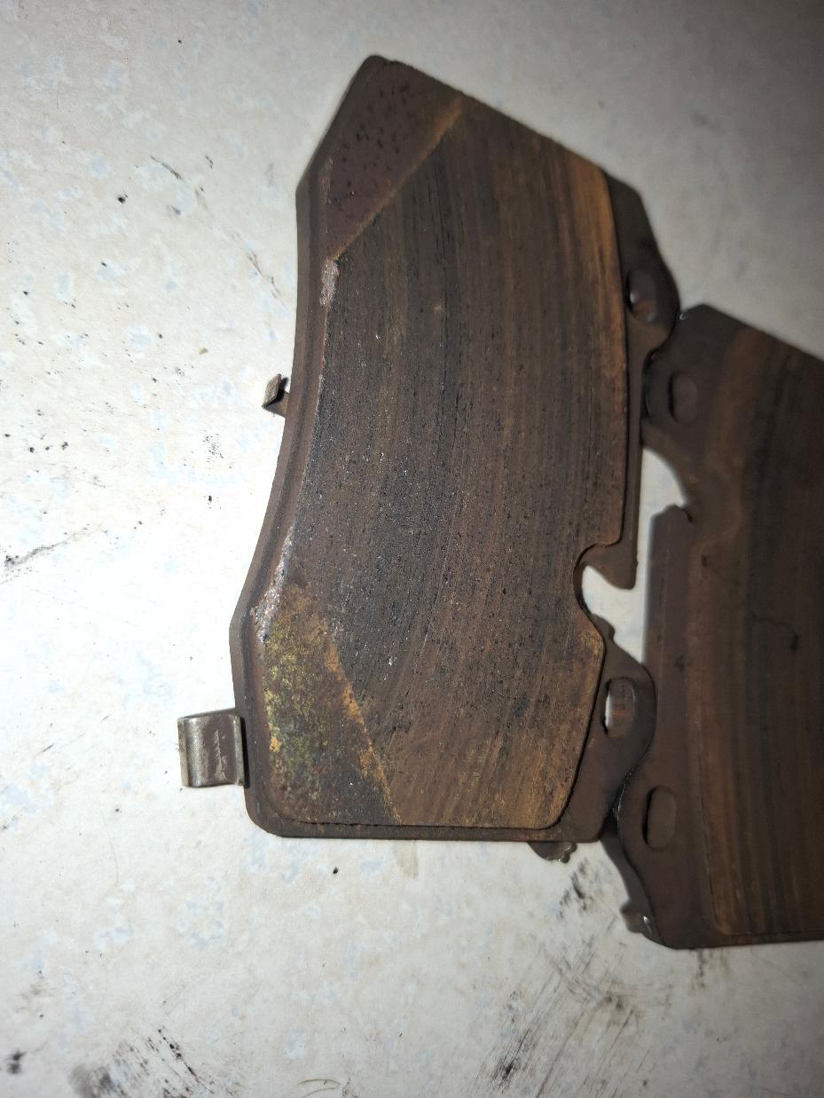

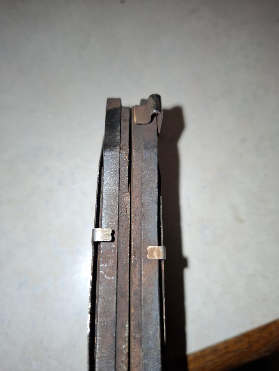

I got 15k street miles plus 11 track days out of the OEM rears. Changed the OEM fronts at probably 60% worn and have about 50% wear on the replacement fronts over the same 11 track days.
I'm using Porterfield AP2444 R-4 and AP2445 R-4's. Around $600 for the set. Big gain in bite! They are a track pad, but I find them to act completely normally on the street. I don't know how they might act in the cold of winter.
These are the OEM rears that were just replaced.

I did 3 track days and 6K of street driving. Maybe I am braking too much 😁. Mine were a little thicker than this but not much in the front. Did your squeeler tab hit? It looks a little worn. Mine had not yet.

Once you’re really cooking you may have the same issue that i do with pads tapering their wear. In that case they may not hit the squealers. It’s hard to really hear the squealers on track too. It’s important to check your pads after each session. Typically the inside pads will also wear faster than the outside and you can’t easily see the inside. It’s why the OEM sensor is on the inside.
