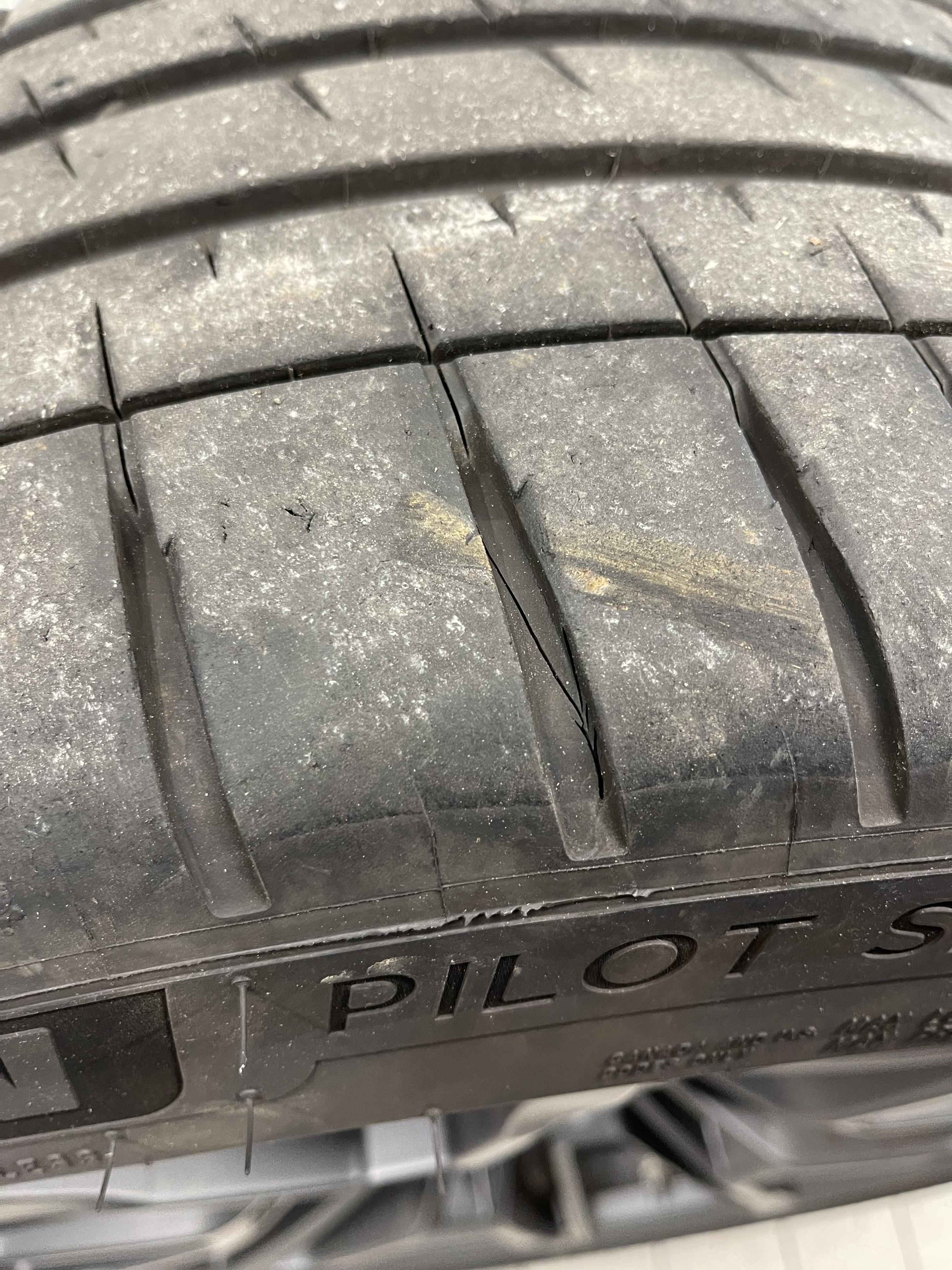

The truth is, these high performance, summer tires do crack in very cold conditions. I was on another forum recently and we were discussing the same thing and guys were sharing pictures of their actual tires that had large cracks in the sidewalls from below freezing temperatures.

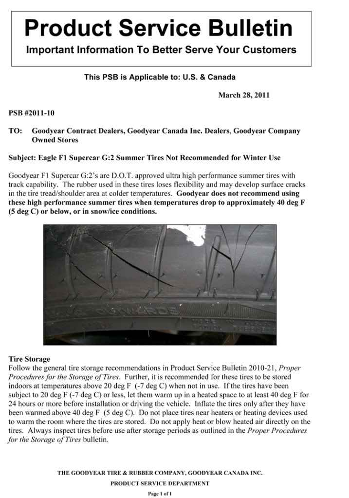

For anyone who is interested:
Interesting, thanks.
I recall reading the same storage and warm up recommendations for the PS4S tires that are on the Blackwing.
To follow them I don’t put the summers back on my car at the first sign of warmer weather but after at least a week or so of it so they’re properly warmed up (they’re stored in an unheated garage).

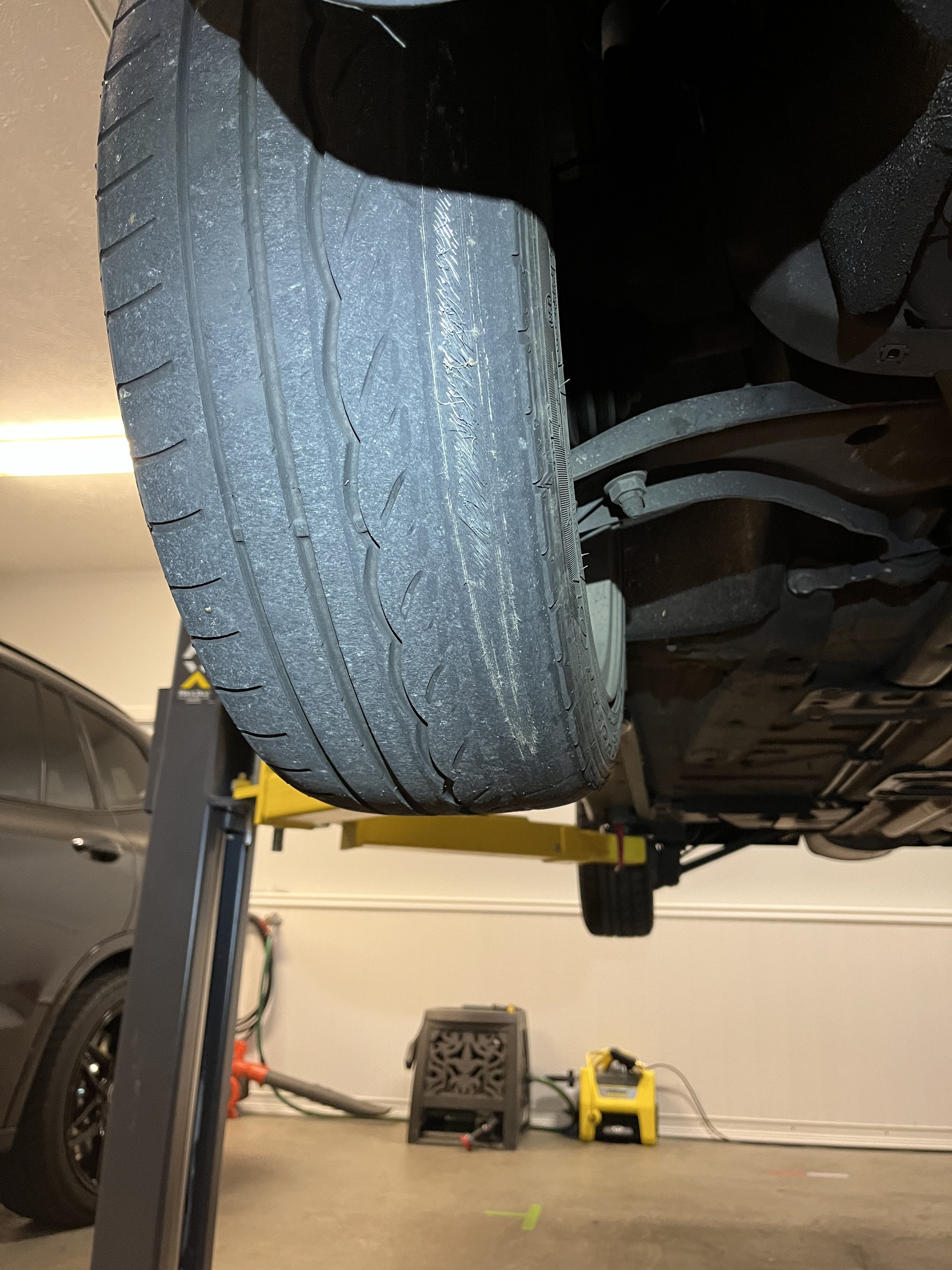

Example of a failed tire... Drove a Mini as a spare run-around through the winter with summer-only's on it. All was fine until the first highway trip in the spring. The tire literally wore out in 100 miles. The photo may look like an alignment issue, yet it was not (I verified it and had the local shop verify it).
Thats an alignment issue, reaaaaaaly bad toe will eat that tire faster than bad camber. If its tire failure, you'd be chunking it.
To your point, it may not have failed due to the winter-spring cycle.
Yet, it was not an alignment issue. Please let me explain... The replacements had over 10k when I sold the car, and they were perfect. I am confident that they peeled apart in that one trip because I had just pre-inspected the car for PA inspection the week before (8/32). After making the 100 mile trip, the car had a shimmy. That is when I found the tire like that. Maybe it wasn't the freeze-thaw cycle, yet the appearance of cracking and the accelerated wear led me to believe it was.
