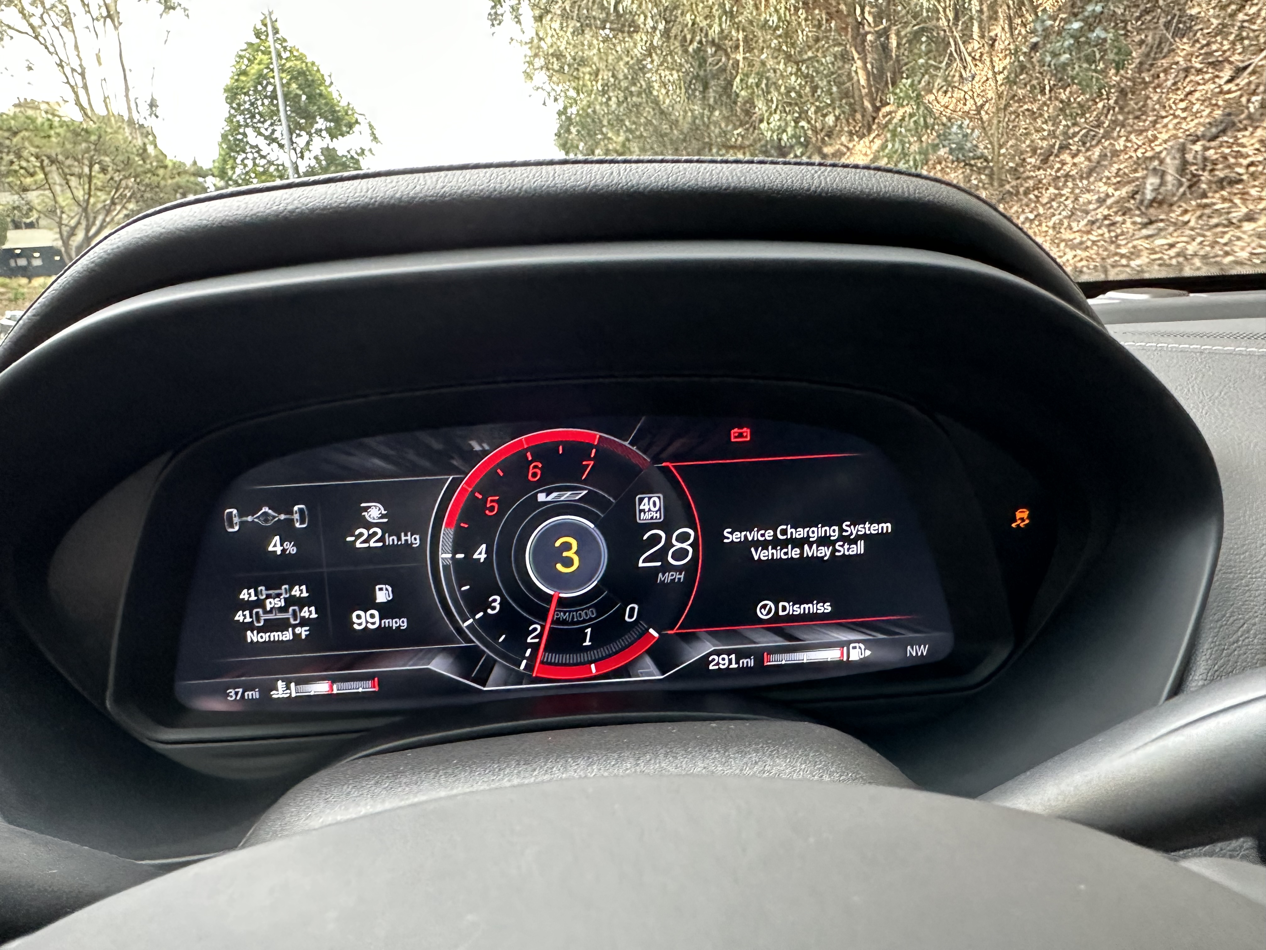

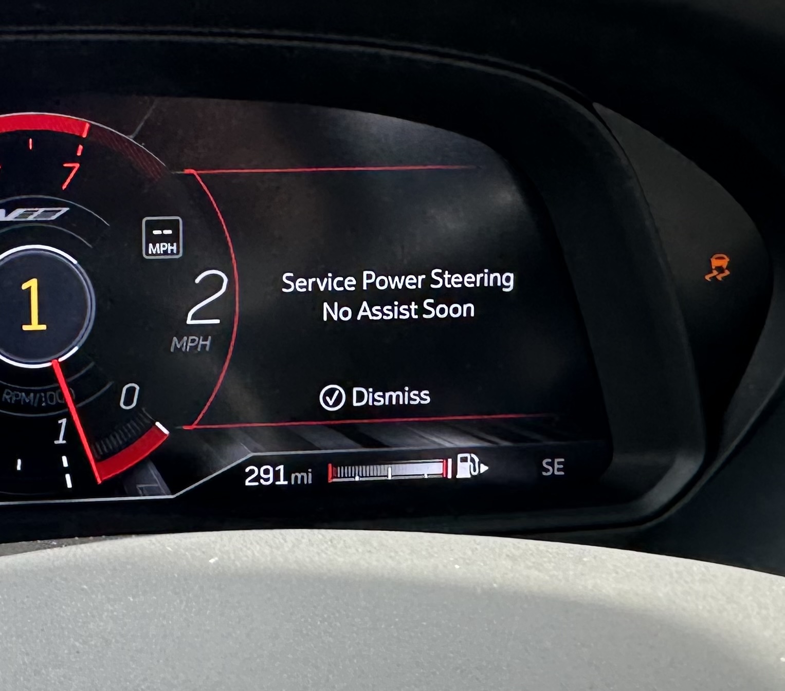

Picked up my 23 CT4 blackwing manual and driving off from the lot I get a warning for power steering needs service, decide to drive on a little longer.
Soon the alert system pops up all kinds of warnings and I lost power steering. Steering just behaves like a totally manual steering wheel.
Alerts/codes
  • Rear axle system off
  • Service ESC,ESC disabled
  • Service charging system (vehicle may stall)
  • Service power steering (No assist soon)
Limp back to dealership, got dropped at home in a Cadillac certified service vehicle.
FML.

Pics and videos of codes.

Could be interesting...best scenario would be something like an old battery (wouldn't surprise me if batteries started backing up during pandemic/supply-chain crunch) or a grounding issue somewhere.
We'll all be watching for the answer. Sorry for your pain!
Yeah I am thinking its battery/alternator/grounding related too. Too many disparate systems failing and the "Service charging system (vehicle may stall)" seems to point at something electric related.
Do you have the date code from the battery? If not, try to call the dealership in the morning and see if you can get it before people start tearing too far into the car.

These cars are very voltage sensitive.

So, the steering rack replacement did not fix the issue- Car still lost power steering and other warning lights at random intervals regularly.
GM sent out a Field service engineer and -
The FSE found a small portion of the main engine wiring harness exposed and causing a short in the system (at times). He has approved us to have the harness replaced.
