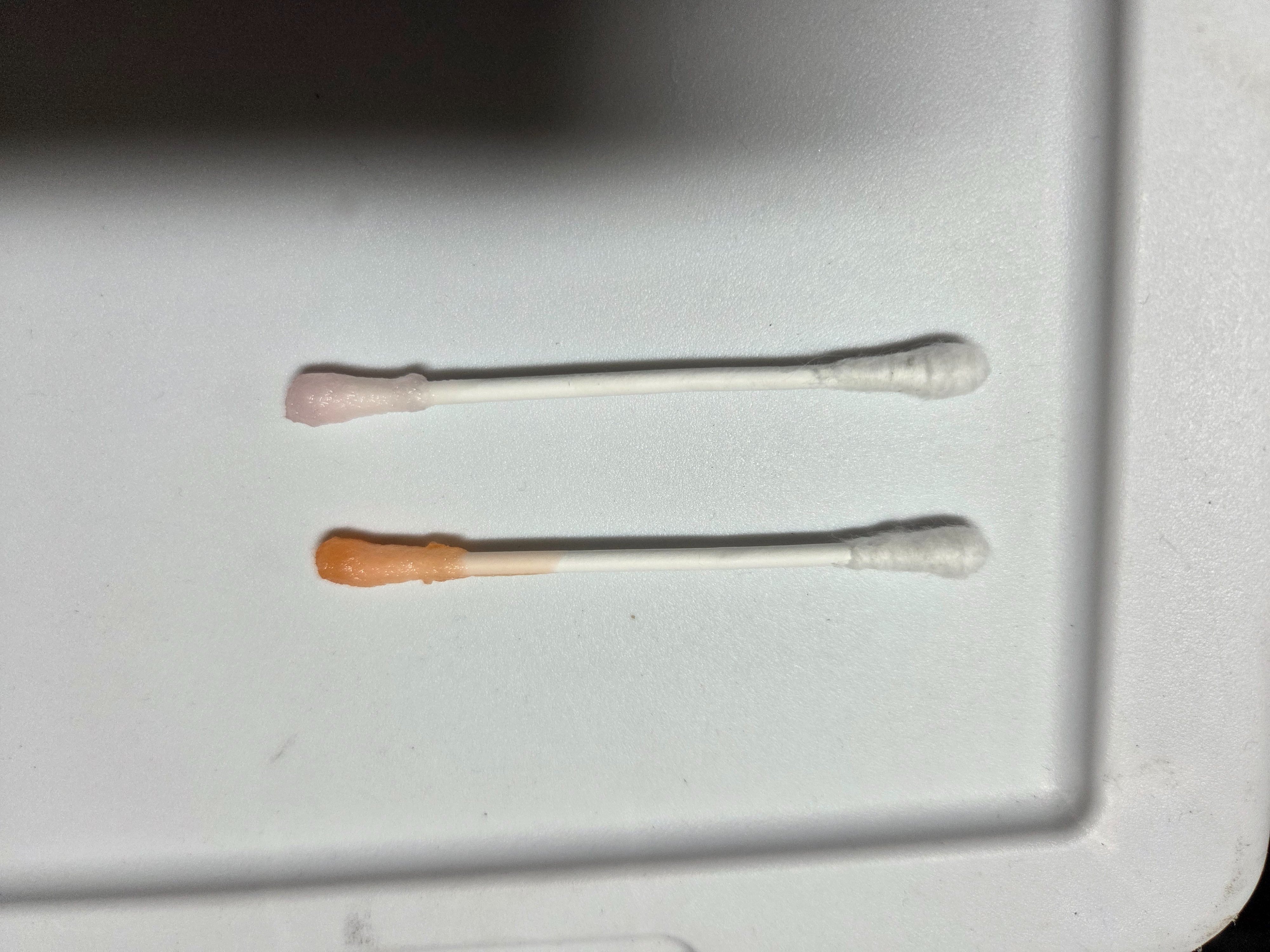

My new 2026 5BW I noticed the coolant level cold was about a cm or 2 below the fill line. The manual doesn’t really say to check it hot or cold. When hot its about half way higher but still not to the line.
Anyone else have coolant that wasn’t filled all the way from the factory? Hopefully I don’t have it leaking somewhere.

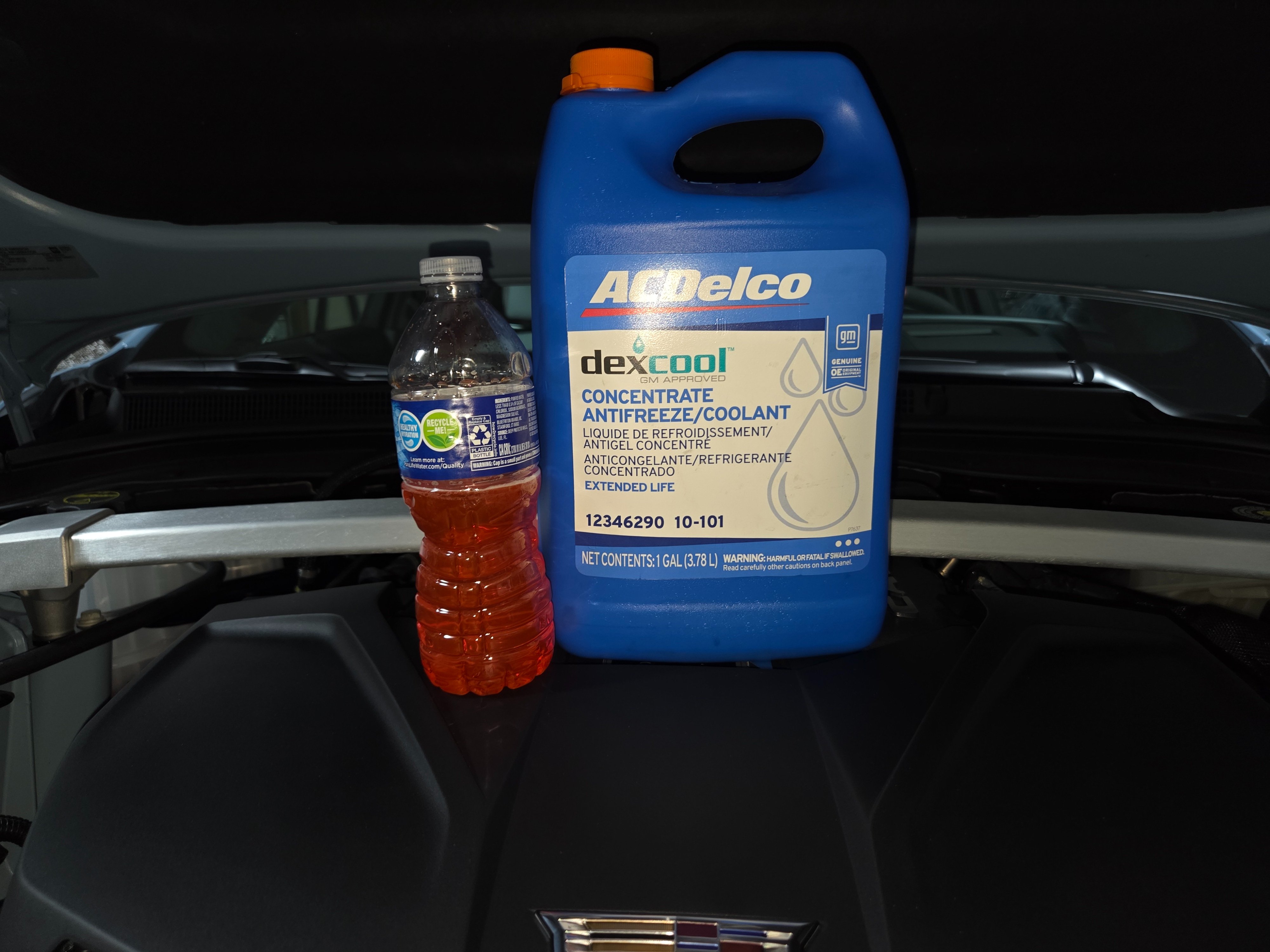

The manual also doesn’t say that’s considered low, but maybe it makes sense to buy dexcool premix to get it exactly to the line.
One more thing, it looks like the coolant is pink through the reservoir, but dexcool is supposed to be orange. So hmm…
Thoughts?

I checked my car and read the manual and it turns out there is not a low mark. Rather the manual says check when cool (and on level ground), and if the coolant isn't at the full mark (the tank seam essentially) then add coolant to that mark. Mine was below the mark, added maybe 6-8oz to get to the full mark.
