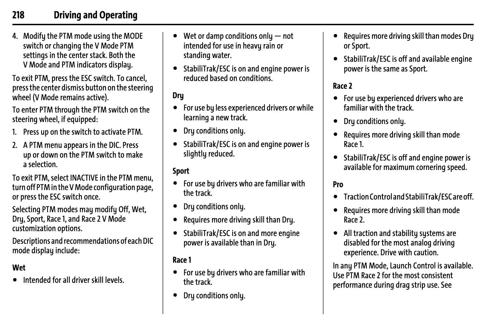

The 2025 Owner's Manual references a 6th PTM level higher than Race 2 called PTM Pro, but this setting doesn't seem to exist in my 6MT BW. Anybody else with a 25 also missing this setting?

Did find this though and it indicates the car needs to be in Track mode to select PTM Pro.

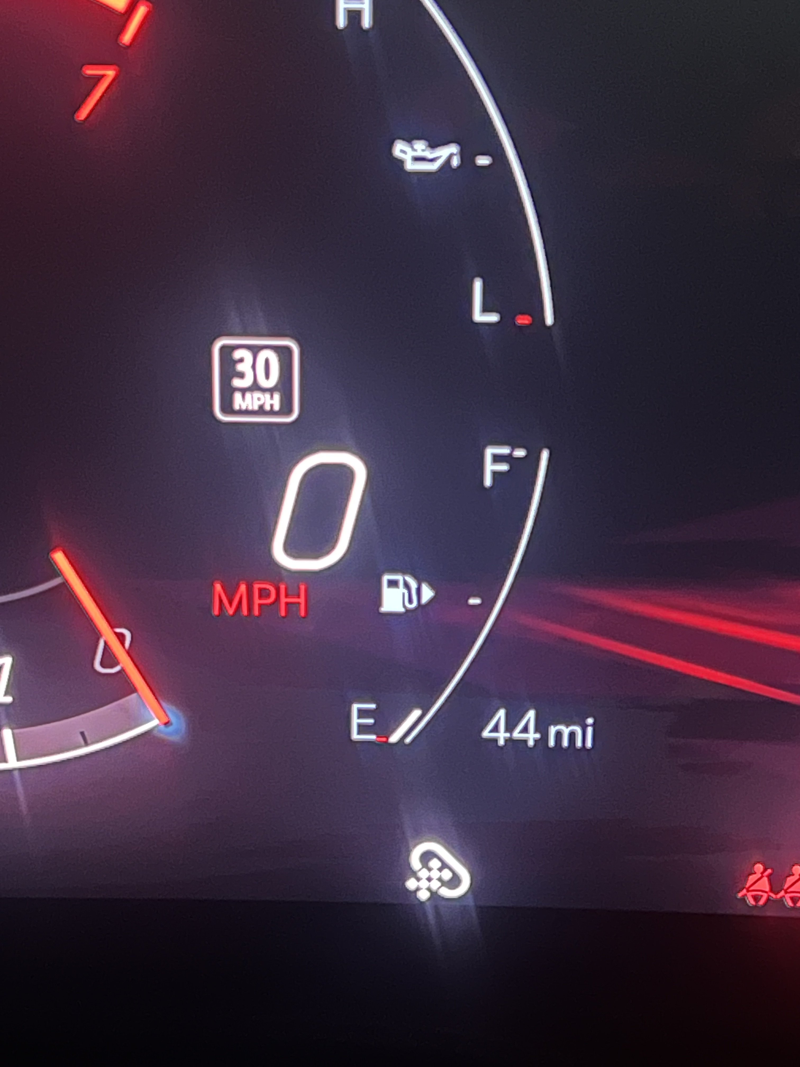

Enter Track mode, press traction control button twice and then twist the selector knob past the last PTM mode. It won’t show anything in the RH side anymore but down in the bottom there’s a new icon. Looks like this:
