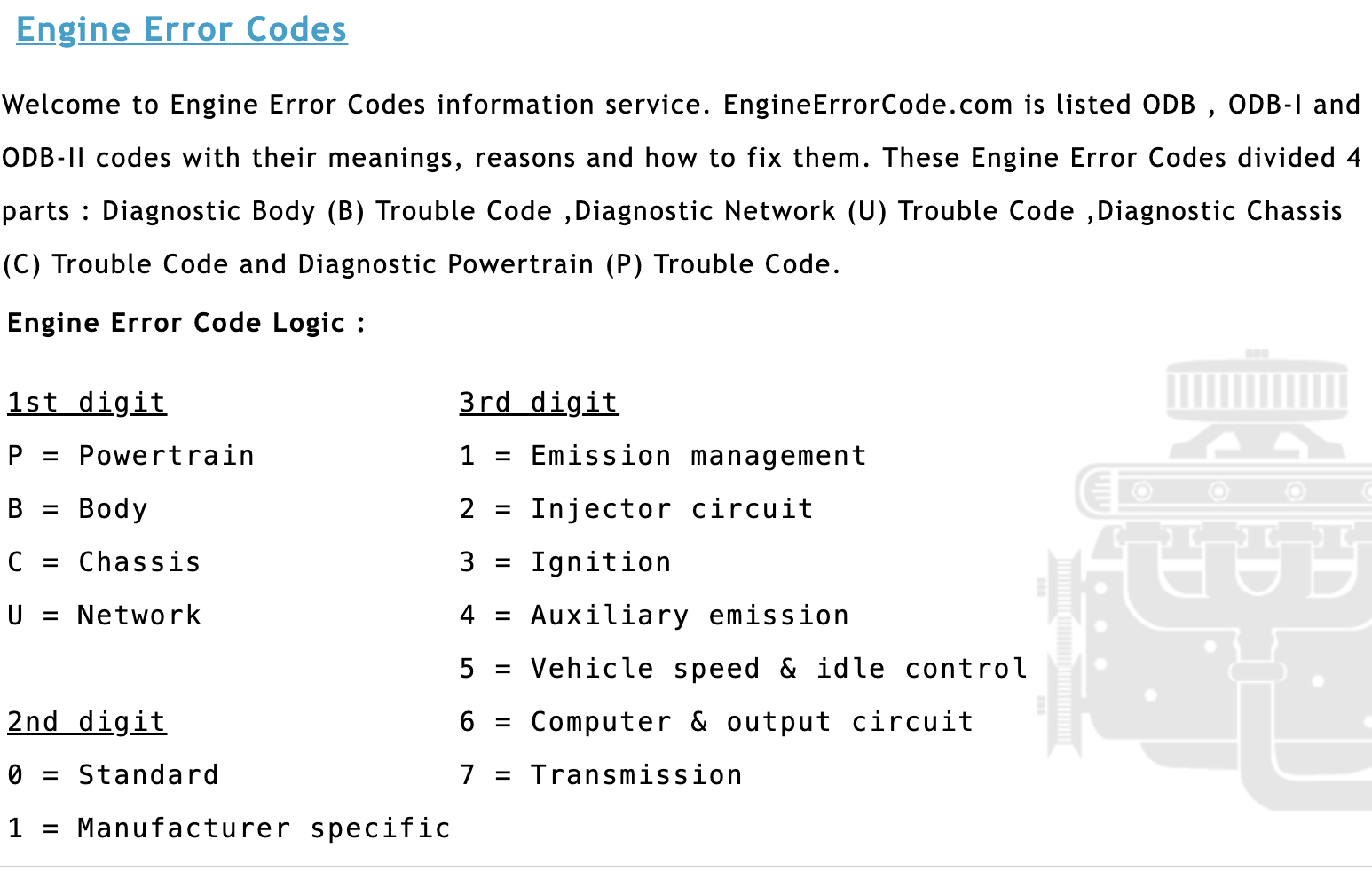

You can plug them into this site to get an idea what systems they refer to.

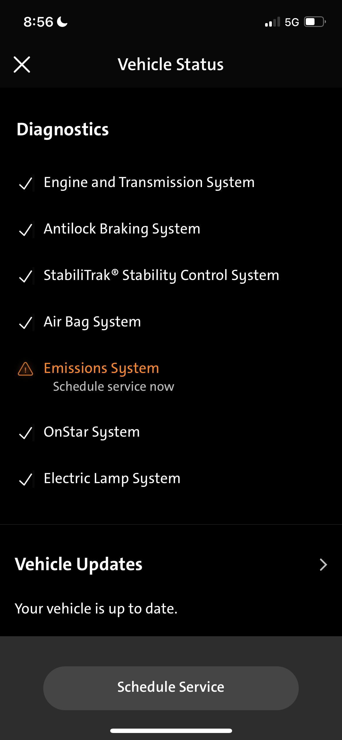

Here is what the app shows me. No luck with retrieving a diagnostic report through onstar, latest one is from 1/15. Will likely clear codes and see if they return.
