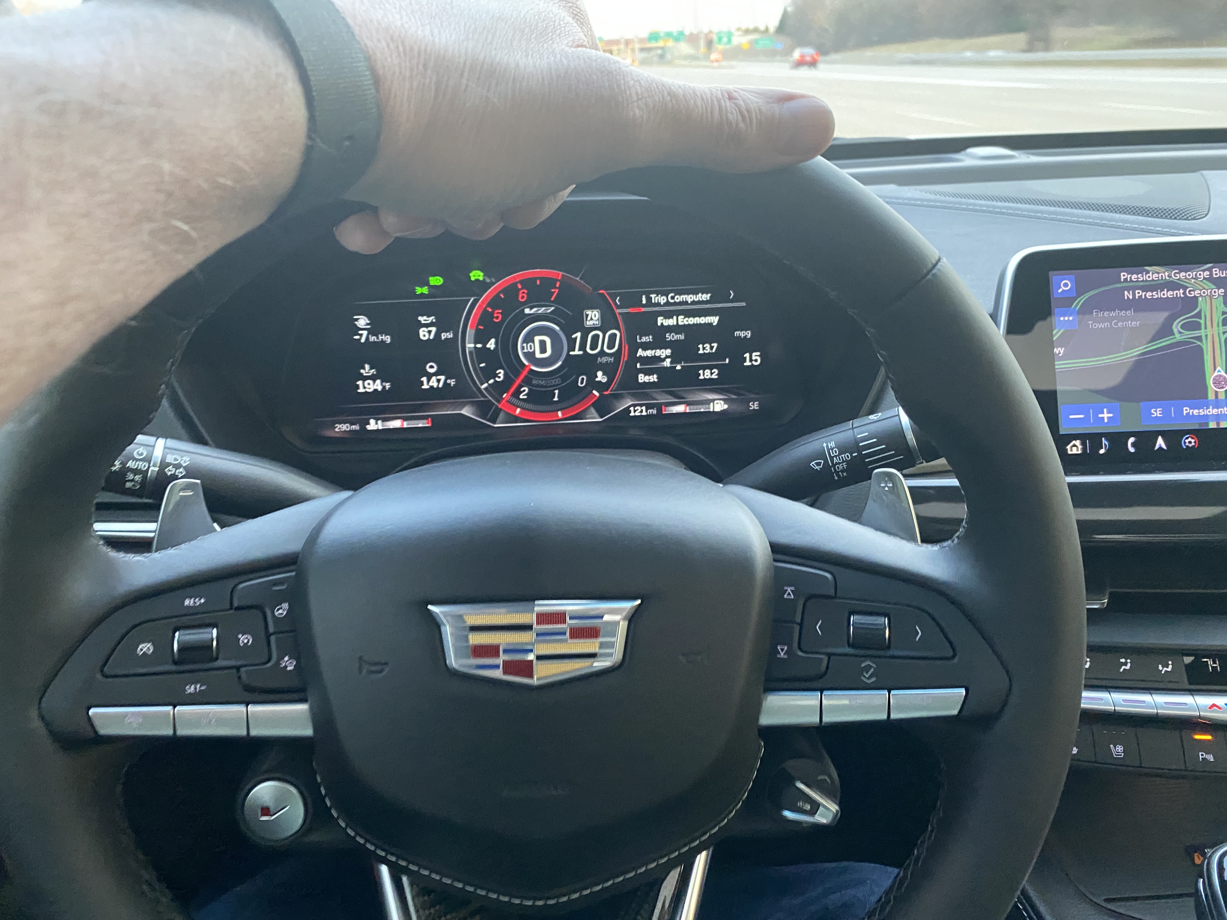

So I pulled up to my office today at 498 miles. I am too dense to figure out a poll on here, but my question is: Do I listen to the tach and let er' rip at 500 or do I RTFM and stay out of it until 1500?
Just curious what everyone else is doing or has done.

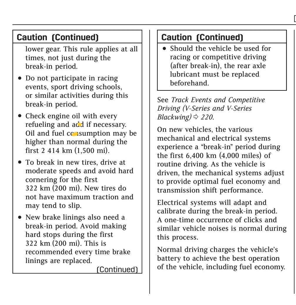

If you've gone past 500 mi, then the ECU has given you permission to launch so to speak, but keep these instructions in the back of your mind:
