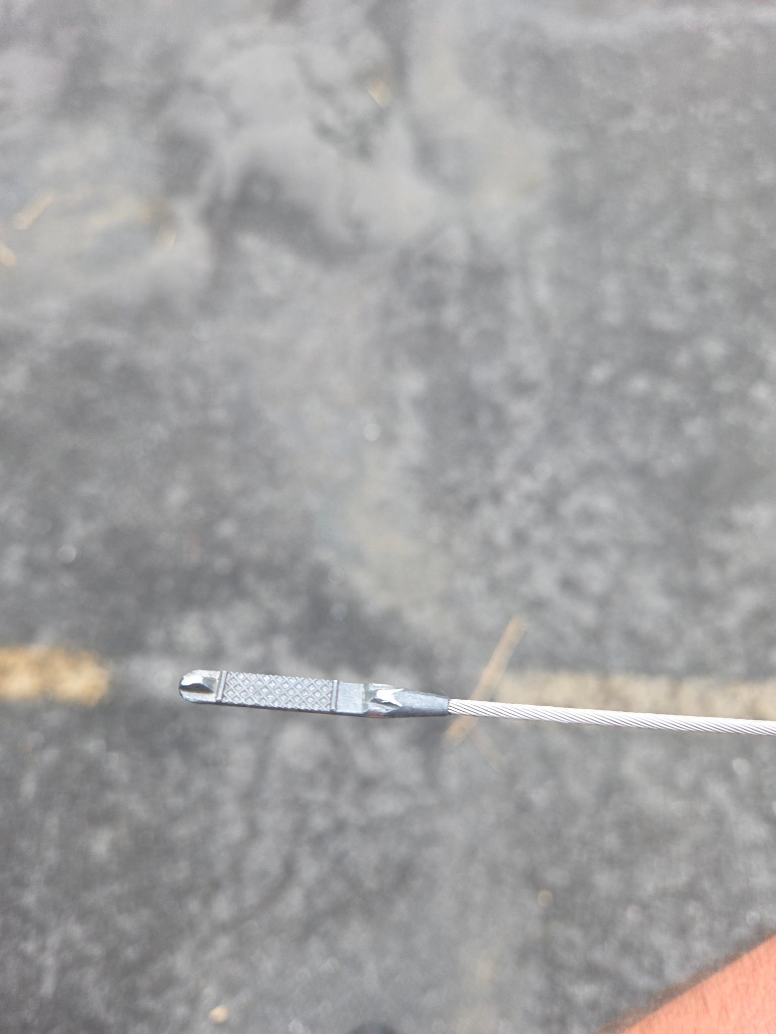

I checked the oil after driving 1,100 miles since they did the oil consumption testing (8/7/2026). There was ZERO oil on the dipstick.
