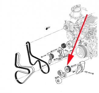

Some customers with a 2017 Cadillac CTS-V that falls within the VIN range listed in this service bulletin may comment on a Scraping or Moan Noise heard best when the engine is idling.

ConditionCustomers may comment on a Scraping or Moan Noise heard best when the engine is idling
CauseSupercharger Idler Pulley Assembly
<tbody>
</tbody>
<dl><dt>Correction</dt><dd>If the vehicle falls into the VIN's listed above Replace Idler pulley Assembly – P/N 12668046
</dd></dl><dl><dt>Parts Information</dt><dd>
Description
Part NumberQty
Idler Assembly126680461
