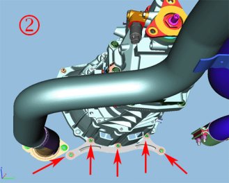

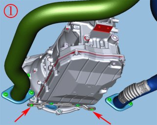

This condition may be caused by loose converter brackets nuts or a normal characteristic of the turbocharger (TC) wastegate.
</dd></dl><dl><dt>Recommendation/Instructions
</dt>
<dd>
Inspect the M8 nuts that secure the catalytic converters to the exhaust bracket. RPO LF3 (1) and RPO LF4 (2) as shown above. If the nuts are loose, it is necessary to replace them with new torque prevailing nuts.
If the technician finds that the nuts are torque correctly, DO NOT replace the turbocharger assembly in an effort to eliminate this brief rattle or tick.
