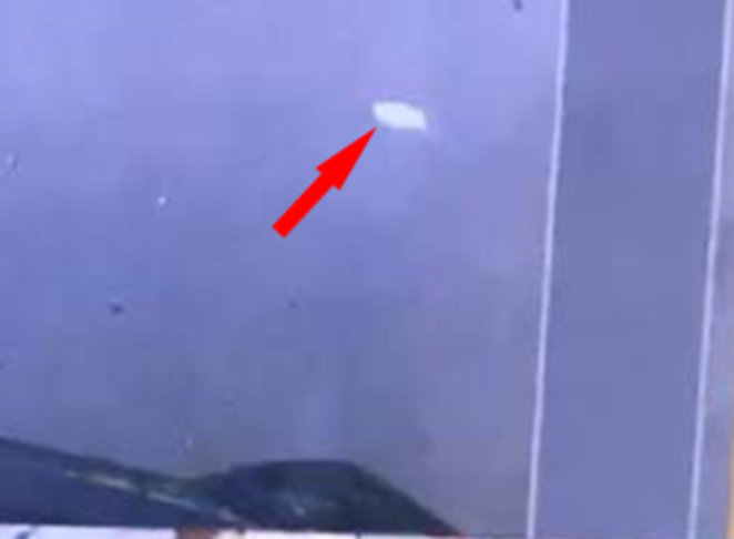

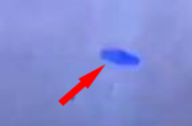

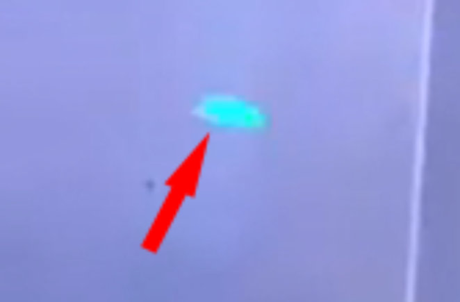

Some customers may comment on a flashing light present on the radio display when in Reverse and with the rear view camera on, usually is corrected by an ignition cycle. ![]() ![]() ![]() |
Correction |
Please communicate to the customer that the rear view camera system and radio display are functioning as designed and this is a normal condition of their vehicle. Please share this information with the customer, including a copy of this bulletin. Technicians should verify that no other conditions are present and return the vehicle to the customer. |
