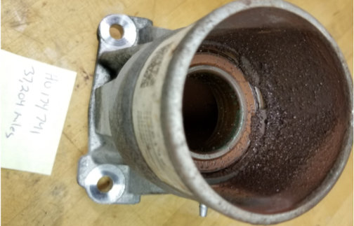

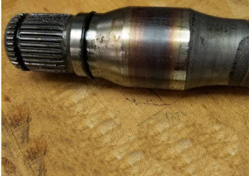

This condition may be caused by fretting between the Front Intermediate Shaft(IDS Shaft) and the Front Intermediate Shaft Bearing/Housing(IDS bearing). The fretting is the result of having a slip fit interface between the bearing and the IDS shaft, and combined with a bearing that has around 0.5Nm of torque to rotate(TTR). |

- Identify if the noise is at the Front Intermediate Shaft Housing
- Once the noise is confirmed and isolated at the front intermediate shaft housing
- Replace IDS Shaft and IDS Shaft Housing, refer to Front Wheel Drive Intermediate Shaft Replacement & Front Wheel Drive Intermediate Shaft Housing Replacement in Si.
