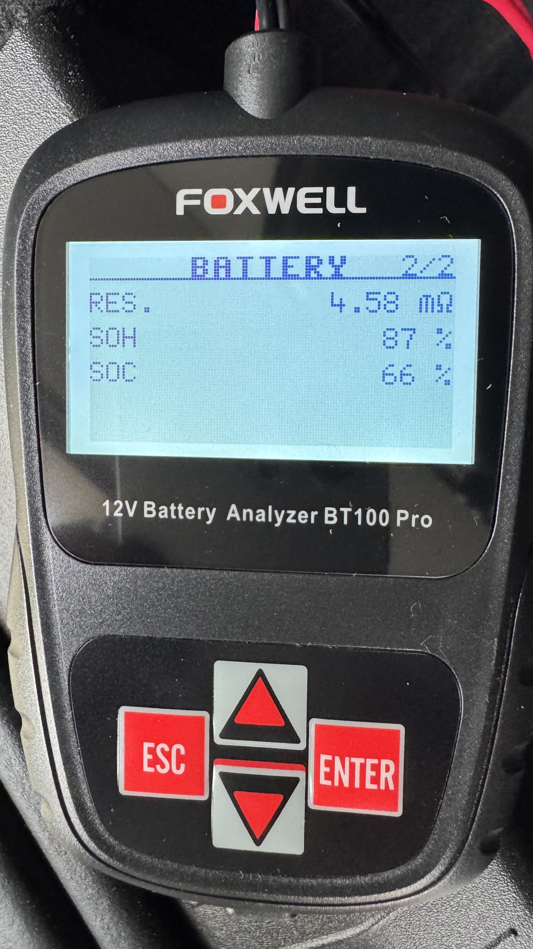

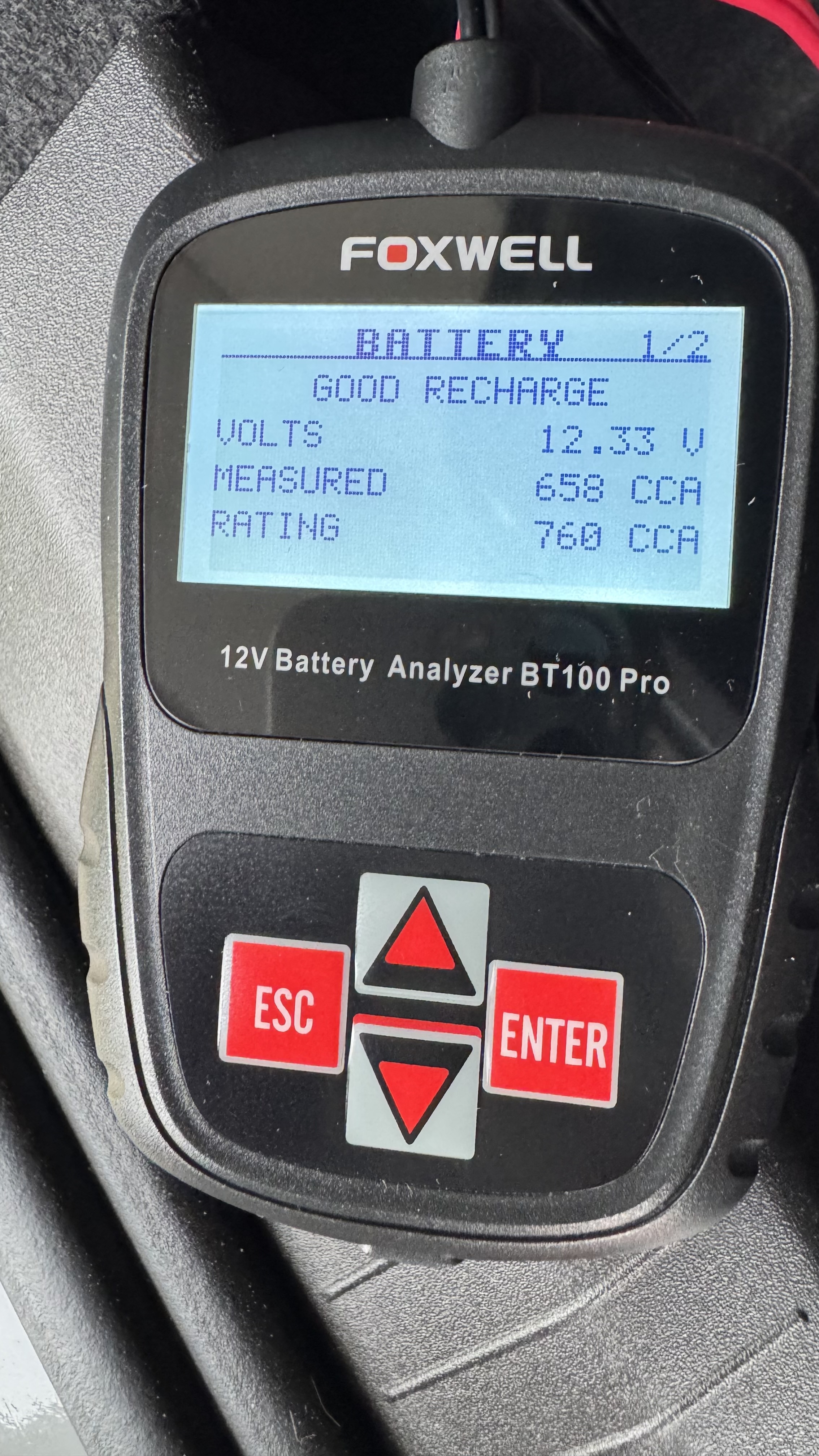

This just happened to my ‘23 5BW. It sat for 10 days without being driven, and the battery went completely dead. I had to use the blade key from the key fob to manually unlock the driver’s side door.
Now I’m trying to figure out whether I have a bad battery. I charged the battery and was able to get the car started. This morning, I connected a battery analyzer directly to the battery, and here are the results:
What concerns me is that the battery status is ‘Good Recharge.’ According to the analyzer, this means: ‘The battery is in good condition but has low power. Please fully charge it.
