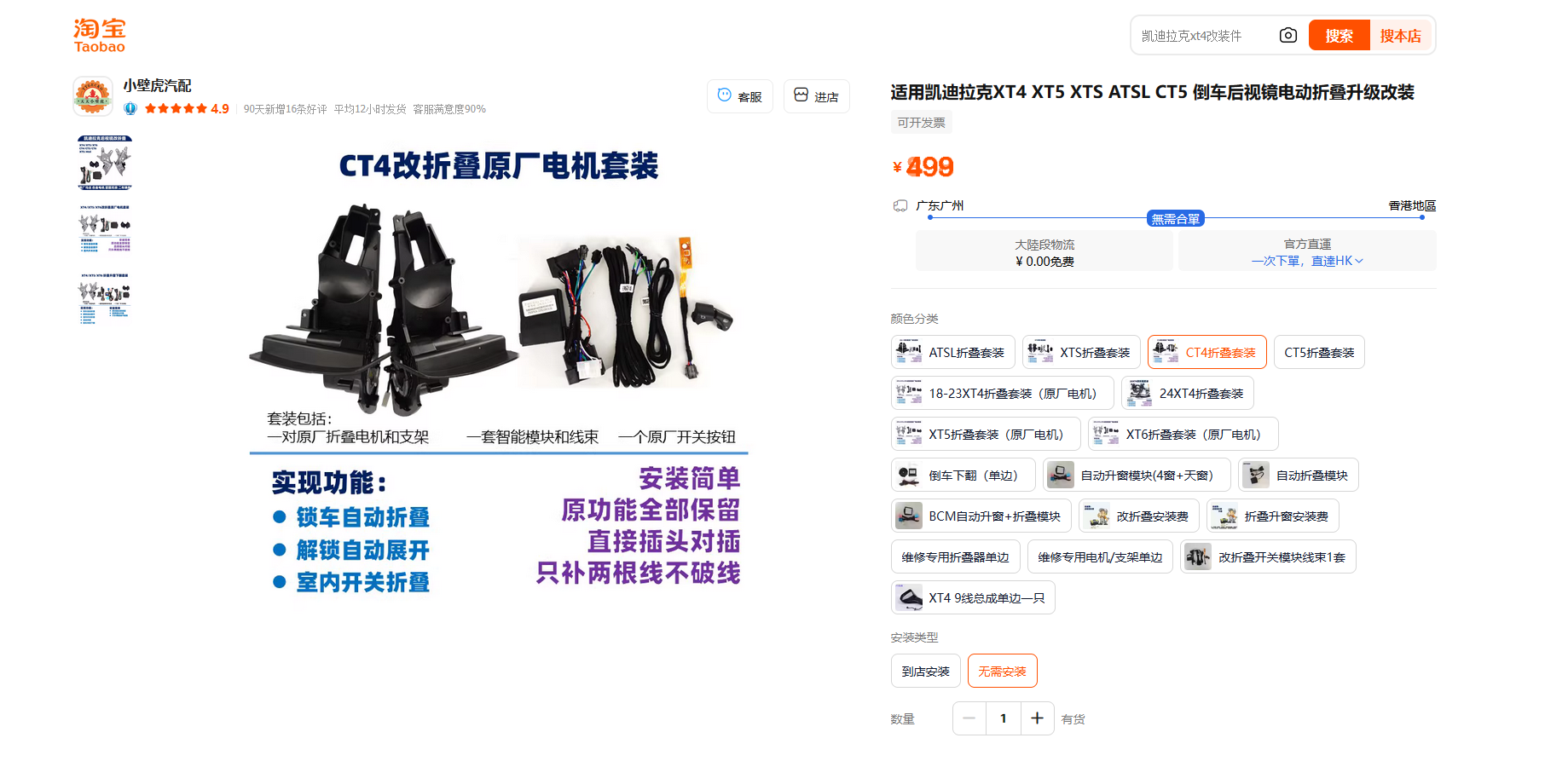

However it seems like it's a very common mod in China, there are motor kits available including all the wiring and replacement buttons. Even comes with a module that works with the keyless entry to automatically fold and unfold when locking the car.
Found a kit for about CNY 500 + shipping:
Kit's also available on Aliexpress, someone reported success over on Reddit: https://www.aliexpress.com/item/1005006584393675.html
Thinking of getting it... but I'm not 100% sure if the kit can fit North American spec cars.

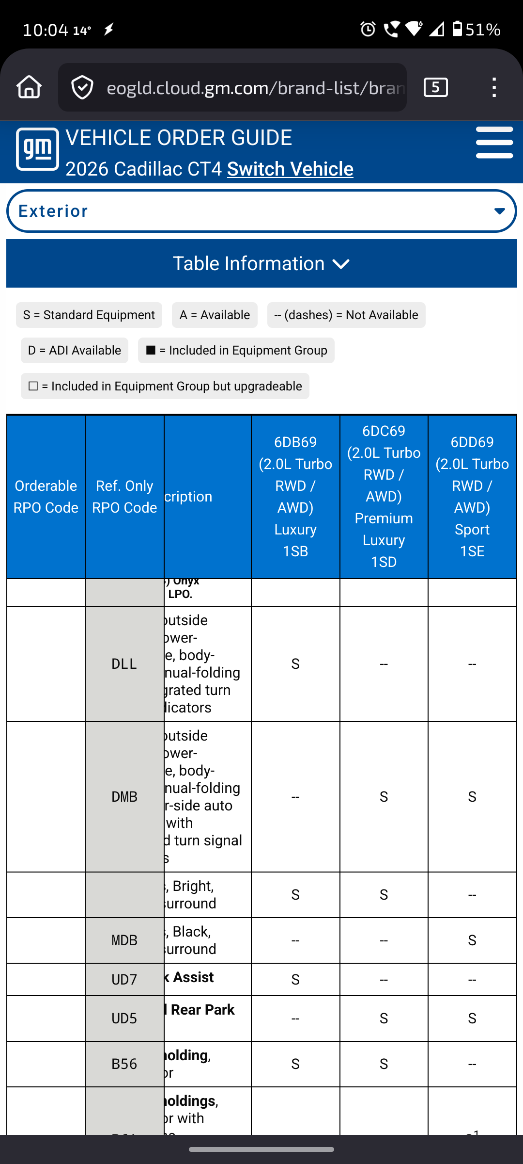

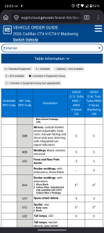

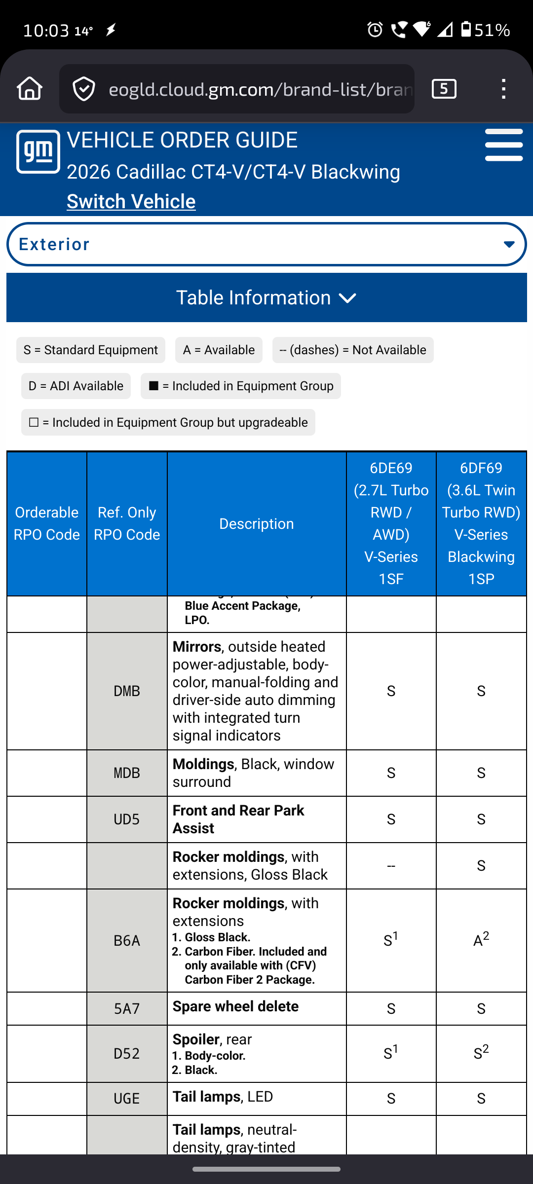

They are all folding but none of them are powered, not even an option for that available. Which is weird considering they did mention how to power fold them in the manual.
