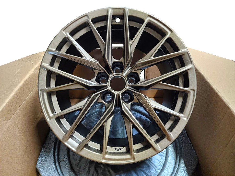

It seems there was supposed to be optional magnesium wheels for the Blackwings, but that never came to be. Magnesium wheels would be about 10lbs lighter per wheel. Anybody interested in forged magnesium wheels?
I've ordered a custom set of these OEM looking wheels. Aside from being magnesium, they will be:
18 x 10 ET15 - front
18 x 10.5 ET45 - rear

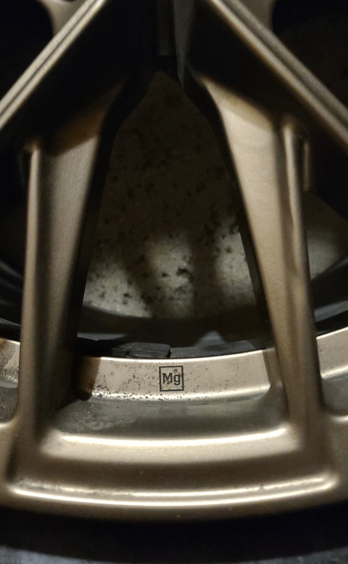

I have a hunch the bronze wheels were originally supposed to be Mg. I think I read on here that supposedly someone picked up a preproduction Mg set off of eBay a while back.
True story.

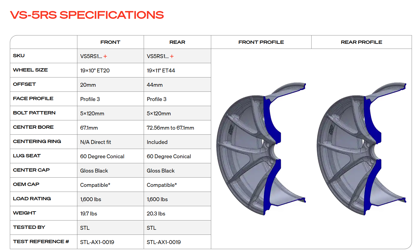

You can get an aftermarket 19" forged aluminum wheel that weighs right at 20lbs, Apex is one example, a similar magnesium wheel is about 17lbs.
