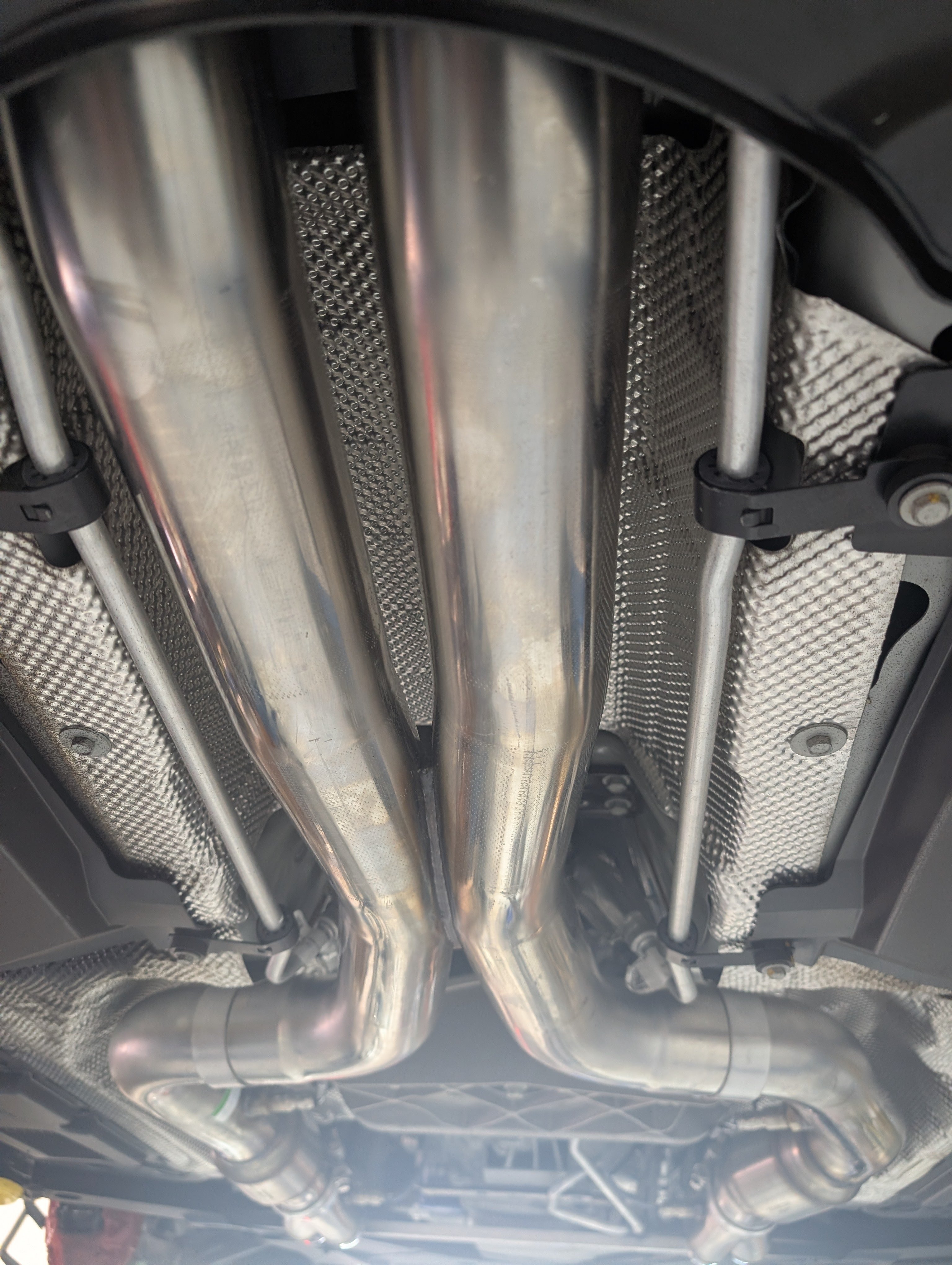

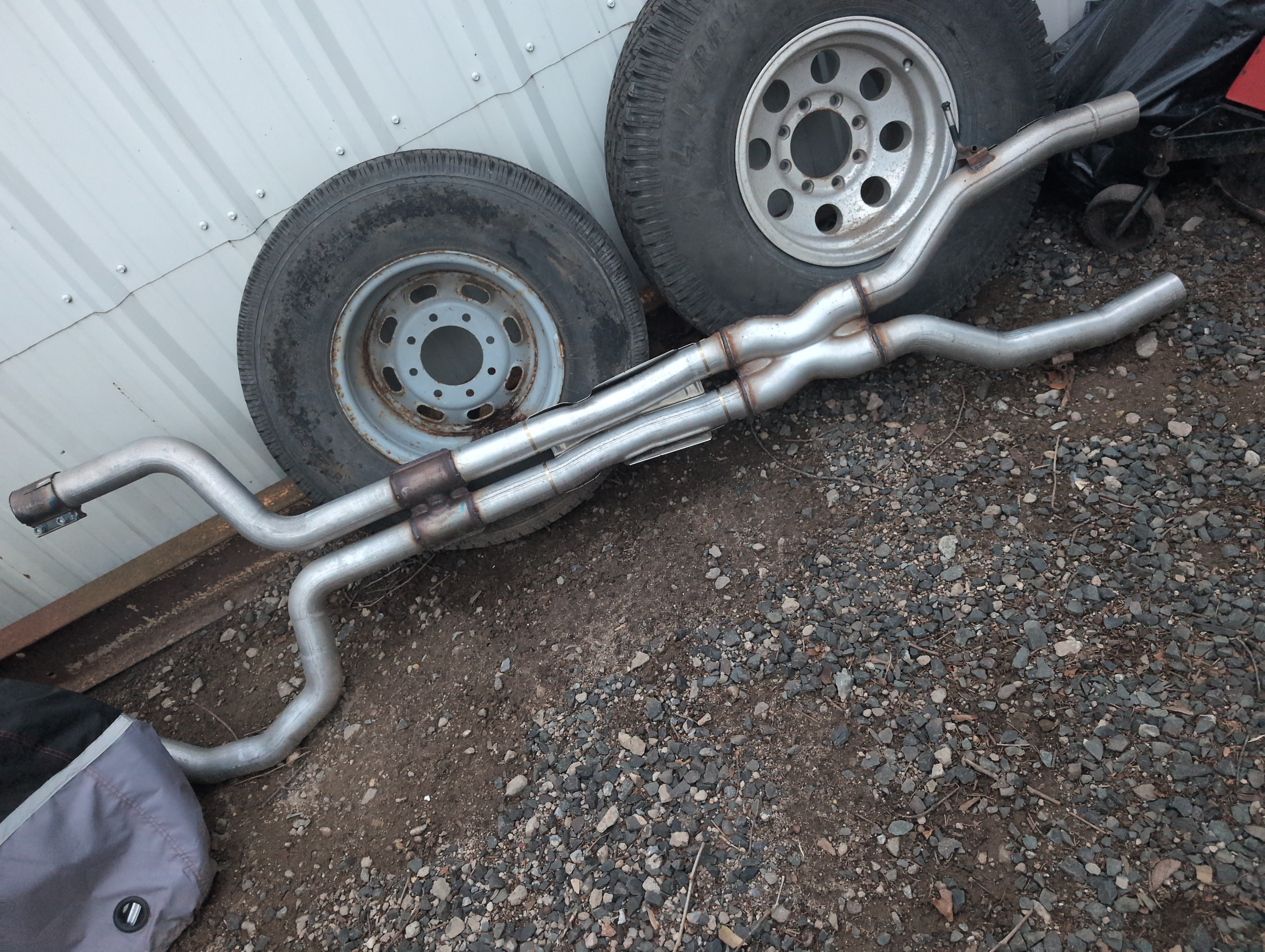

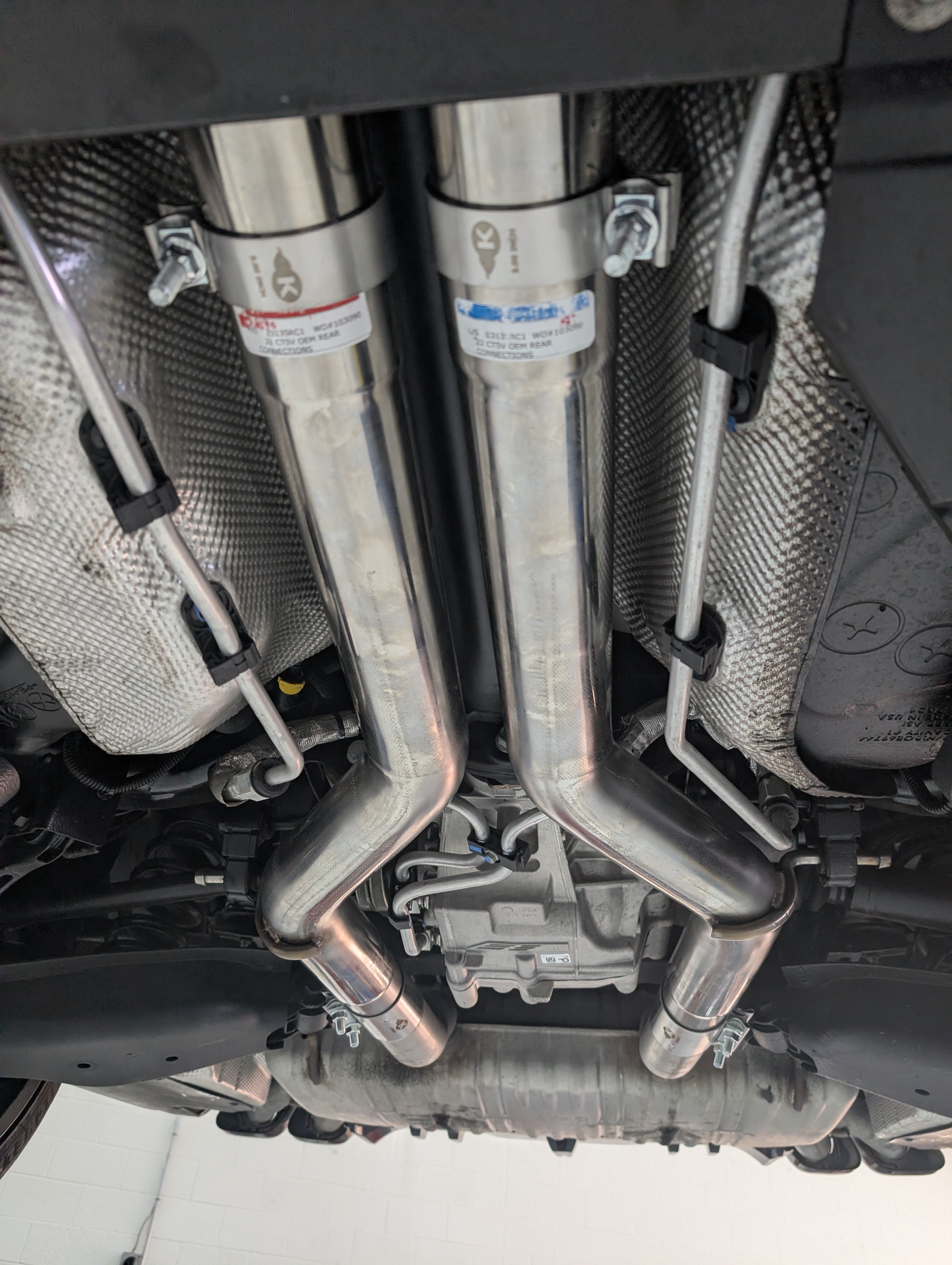

I recently had Kook's headers and green cats. For the possible loss of a couple of horsepower it's not worth the possibility of not passing visual state inspection. The Kook's cats have mid-pipes that join just before mufflers. Pictured is the OEM removed exhaust and the installed Kook's system. Can't give you a power increase for just headers as I had other mods done prior and tuned after all done. With valves open a significant increase in exhaust sound, closed barely above stock.

My biggest gripe tho is the usage of just a clamp on the mid pipe to the front intermediate pipe under the transmission tunnel. The clamp lets the mid pipe to sag and settle on the transmission tunnel cross bar and vibrate like hell. I ended up changing that clamp to a lap band to help alleviate the sagging.
