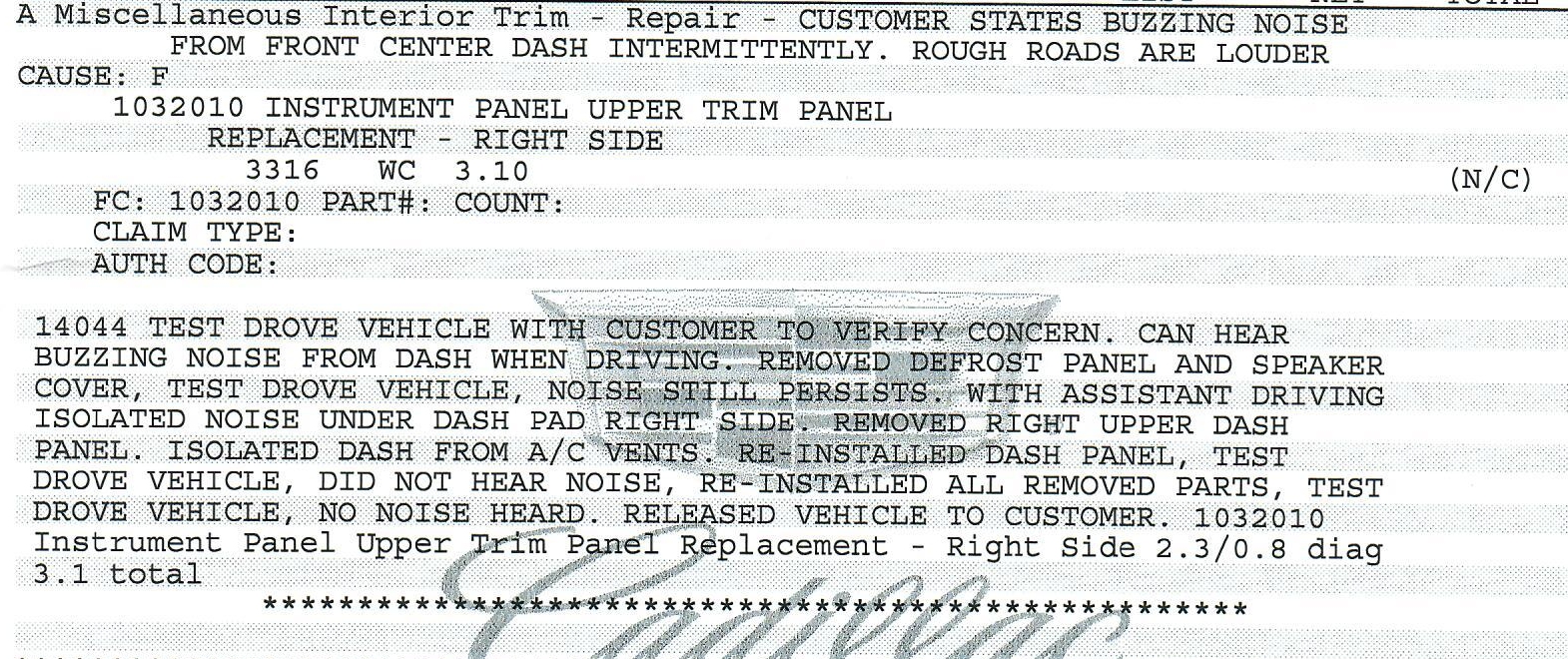

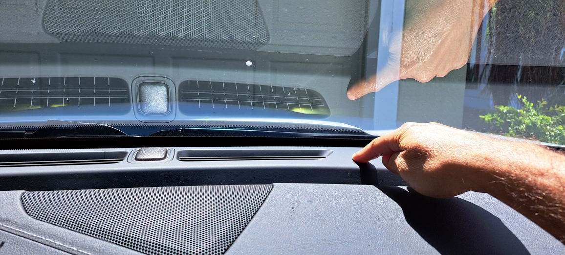

I had a similar rattle (buzz?) in my '22 4BW. Eventually I isolated it to the spot just right of the central vents in the dash by the windshield. I could make it stop with one-finger, light pressure - see first picture.. I showed it to the dealer's lead technician. Ran over some road reflectors to force it to make noise on the test ride. Once he heard/saw that, he was convinced it was real.
He fixed it after having it for a day. Looks like he replaced the Instrument Panel Upper Right Trim Panel, part (or procedure) 1032010. See write-up in second picture. 3.1 hours of labor, but no charge (under warranty).
FYI, I originally thought it was from the rear-view mirror housing, but I think the sound was bouncing off the windshield, which made it sound like it was coming from a higher position than it was.
Hope this helps!
