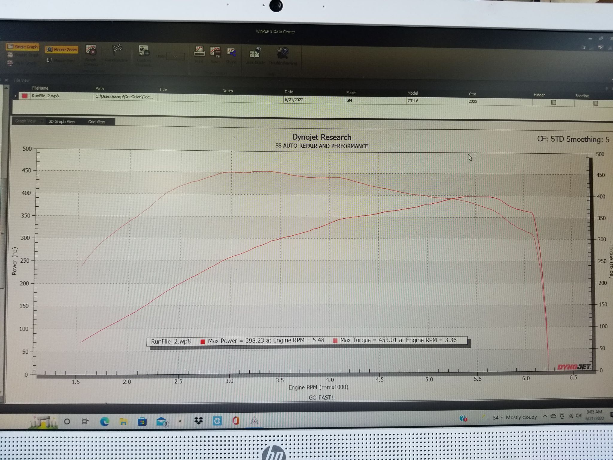

Just rolled over 500 miles. Figured it was time to spin the rollers
While I'd hoped for a bit more baseline power, it is quite torquey.
*67 degrees F, 92 octane fuel, 4th gear

Made above the crank rated tq, so thats encouraging. I may throw it on the rollers to see after the first oil change at 1000.
I would recommend starting your dyno pulls at 2,500 rpm instead of 1,500 rpm with this car. It will be much easier on your fuel system and safer for the engine in general.
