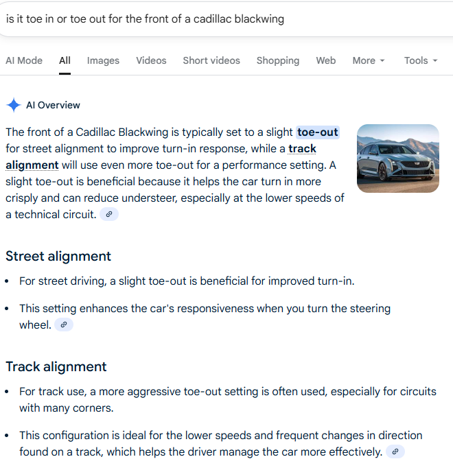

Granted, I know these AI generated answers are often wrong, so my second reference point is John Heinricy. He was a GM engineer in the Performance Division for 40 years and life long race driver. He presently runs a CT4-V BW in the SCCA Touring 2 class. I've been speaking with him and he's been advising me on the setup of my car. He's told me to use 1/16" toe out in the front and 1/16" toe in for the rear.

I watched your videos. In "What is Camber? A Simple Explanation" it says most vehicles use positive camber, but racing/off road applications use negative camber. We're dealing with a performance car and all agree we should be using negative camber, right?
In the "Toe (IN/OUT) in Car Suspension" video - re-watch from 4:00 to 4:15 in the video. This video indicates that for racing/performance applications one uses toe out in the front for quicker turning response.
Seems like the difference between toe in and toe out for a RWD car is the desired outcome. If your driving a regular car and your goal is maximum tire life one would use toe in. If your driving a performance car and want improved steering response one would use toe out.
If my conversion is correct 1/16" should be about .14 degrees (.07 per wheel)

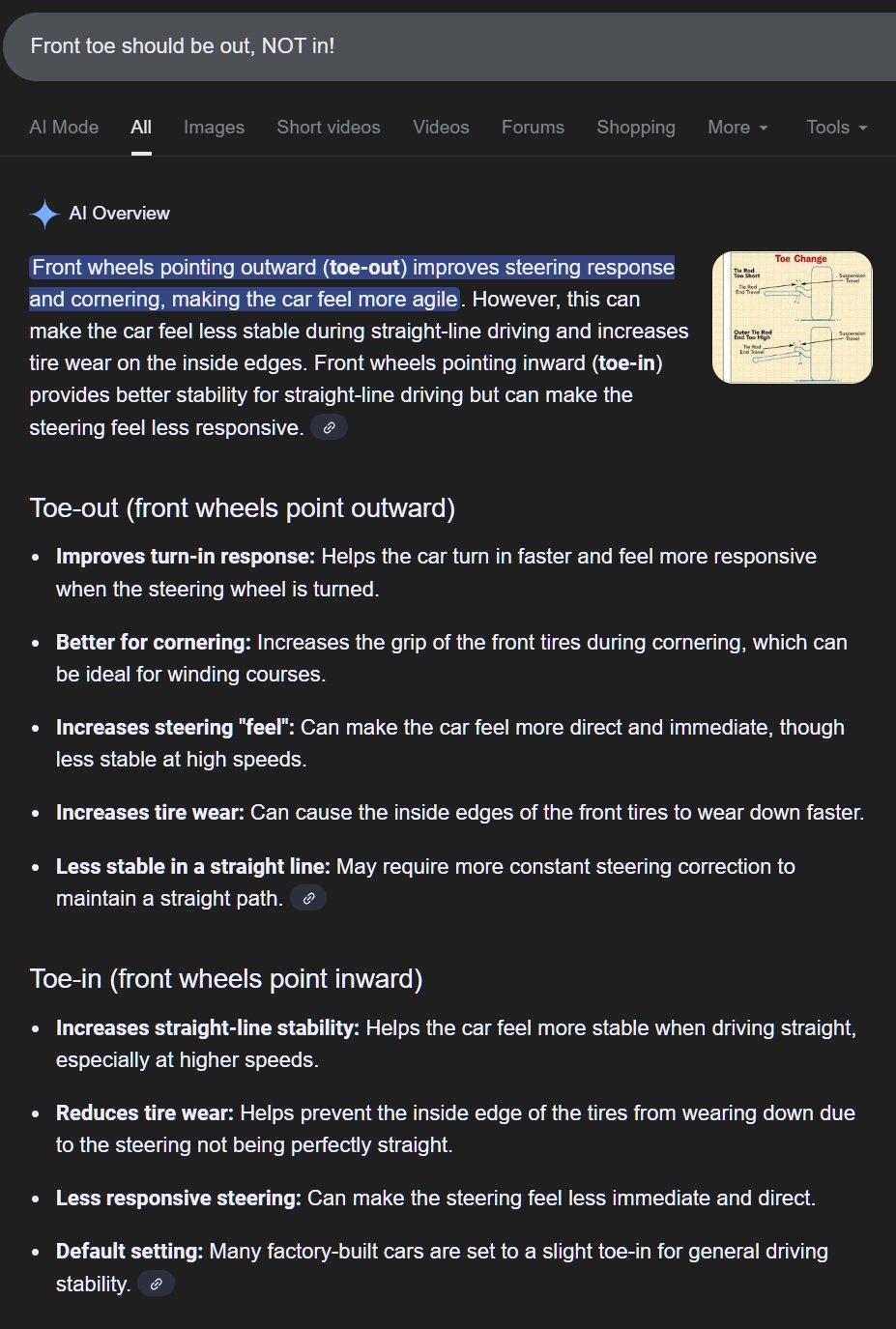

And here's another, using your AI tool, and your exact words:
Acting like everything is black and white, that there is only one answer, and your opinion is the only one that matters, is making you look pretty silly here.
Correct, it's not black and white. It seems to come back to what is your goal, improved tire life or improved handling characteristics? According to your video if the goal is tire life, one would use toe in, but if improved handling is the goal, one would use toe out.
Could you please be more specific regarding your point in your AI generated answer. Having read it, it seems to support the idea that toe out is what is appropriate for our cars.

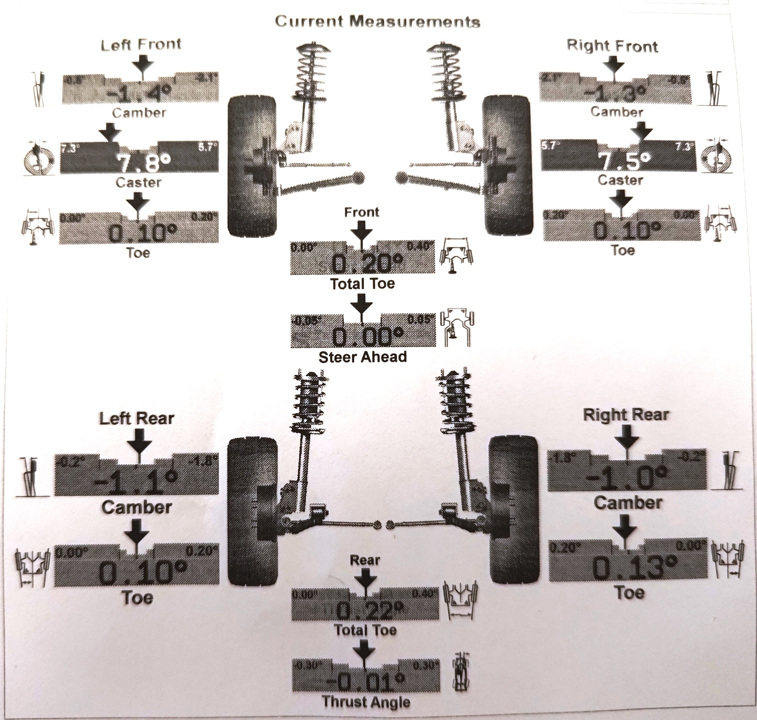

  4. Toe-in improves stability and ensures you never toe-out under acceleration squat. Aligning with approximately 0.2 degrees of toe-in provides added stability for street driving.
I’m happy to say I’ve finally found the formula that works for my car after three alignments and a fair amount of frustration:
  1. SPL rear toe arms – These address potential flex and reduce the risk of bolts loosening over time.
  2. Alignment: -1.5 degrees camber all around, with 0.18 degrees of toe-in front and rear (I asked for 0.20, just ended up at 0.18).
  3. Tire pressure: 29–30 PSI cold in the rear (approximately 31–32 PSI in the front).
Note: My car is lowered on Eibach springs.
This may not be the perfect setup for everyone dealing with this issue, but it solved it for me. The car now hooks the way it should given the power, and I’ve regained confidence in daily street driving.
