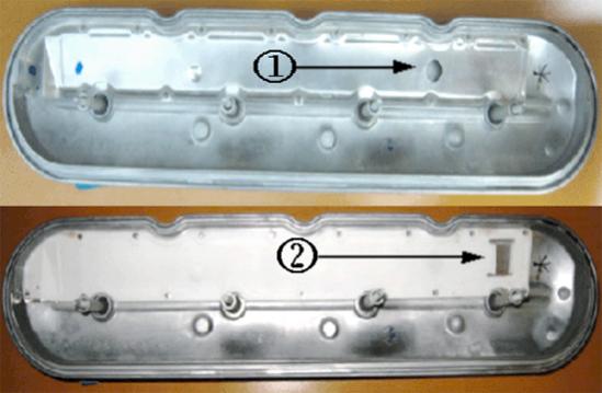

If the engine has been properly repaired and cleaned, inspect the left rocker cover (square baffle) (Fig. 3, #1 – old design; #2 – new design with square baffle) and verify that the baffles can hold water and do not leak. If any leaks are found, clean and seal the edge of the baffle with RTV, if possible, or replace the valve cover. Thoroughly clean and dry the valve cover before installation and/or resealing.
In addition, change the engine oil and replace the oil filter with a PF48E filter.
