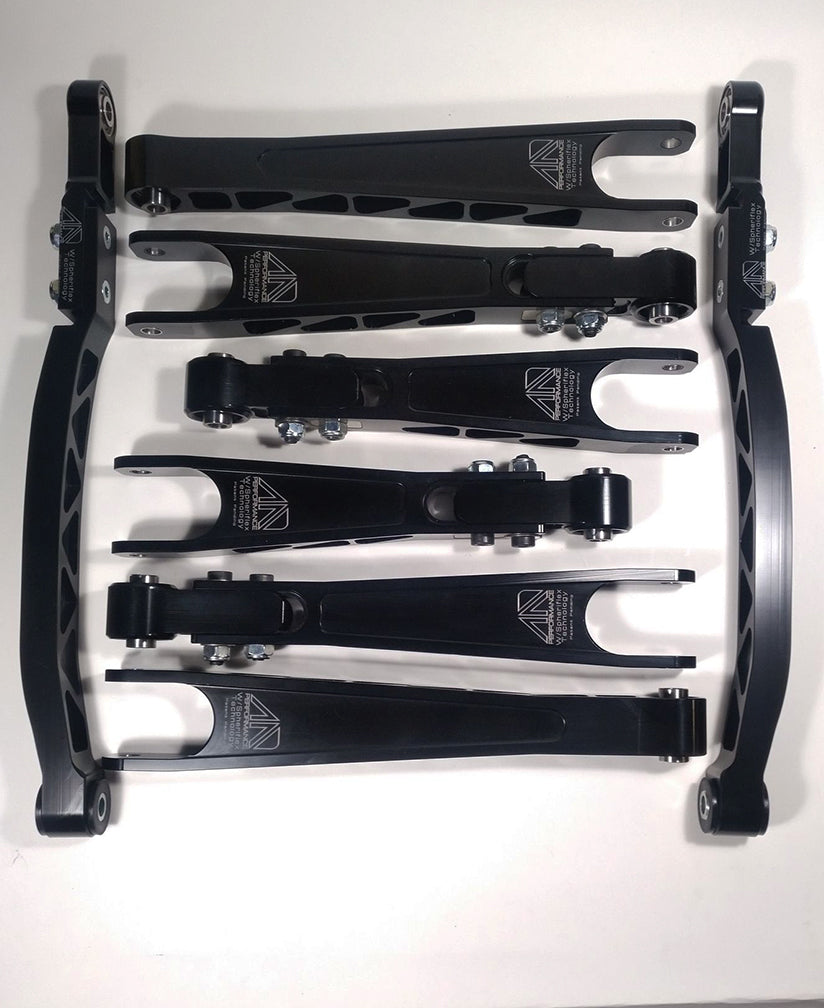

So for an update on the suspension work done to the Blackwing :
Rear AAD Performance Camaro 6 Drag pack billet arms
Swift Track Spec Springs from Rennick Performance
Also fresh set of PS4's, off the rack not Cadillac Spec.
Front Wheel Adapters 15mm thick
After 3 days at Tail of the Dragon , multiple runs on Dragon, Parkways and Skyway I have some thoughts.
Car is setup with 2.5 camber in the front, 1.5 camber in the rear. Left it to standard track alignment to get used to the setup , will target more camber next year. Same alignment I ran last year, wanted to see how the car felt without changing up too much.
Car feels twitchy on highway , drive down from Canada was over 8 hours. Car is insanely responsive, so it felt darty unless I was in V mode. Comfort mode / Touring felt like the rear end was a bit loose.
V mode brought things back and it felt more stable. My V Mode is PTM Race 2. Just the Double tap on the V button.
Speaking of V mode , never felt more comfortable in this car. I never used V mode PTM Race 2 before and this year I lived in it. Car was incredible in the turns and sweepers. Felt planted and grip was super predictable.
I now want and need sway bars. Minimal body roll but now it is pretty much the only complaint I have for the car. Looking into Camaro Gen6 sway bars and if they could fit and if they offer larger or stiffer options than what is already on the car.
Turn in is tight , car rotates at will and stays on line even in uneven pavement.
Launches and straight line grip is now perfect - in V mode PTM RACE 1 or 2.
I fell in love with the car all over again.
I can’t wait till next year , little more camber everywhere and less body roll and the car will be incredible.
Also worth knowing that with the lowering springs I was able to get 3.0 camber in front when I tried maxing it out.
The twitchiness is probably based on how much rear toe it has. Happen to have a print out of your current alignment specs? Also, unless you're tracking it heavily, I wouldnt want to run -2.5 for the front. Probably shoot for the -1.5 front and -1 rear for a more street care setup.
Toe is all in spec, .1 all around from my alignment. The camber up front made the car incredible in the turns , first year I went i have understeer issues with 1.5 in the front. Went last year and 2.3 gave way more grip in the turns but then the rear end felt loose. Now the car feels incredible, I just want more of it lol.
