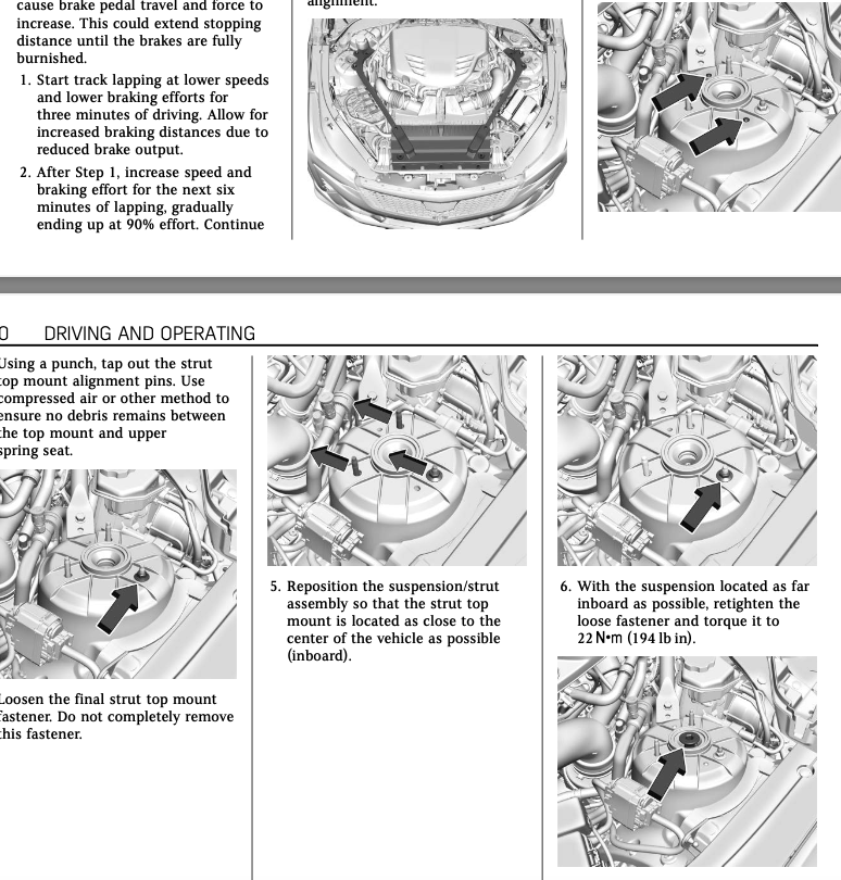

I took my car to a race shop for an alignment. My goal was to get -2.0 in the front as this is my daily driver and I was worried about ride comfort and steering 'wondering' with the -2.5 option as seen in the owners manual (removing bolt from the strut tower - similar to Camaro ZL1 1LE - See attached Pic) .
Sadly we could only get -1.6 in the front which I find odd. Even my non 1LE Camaro SS was able to reach -2.0 . I wonder if the tech was doing something wrong, like not loosening the bolts enough. No issue with toe (total 0.1 front and rear).

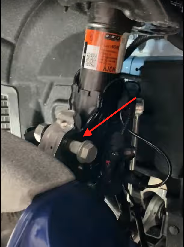

He was doing it wrong. These cars adjust near the wheel hub, not the top strut mount. There is a bolt that you loosen that allows you to rotate the hub. 1.5 deg negative camber is the standard alignment for these cars.
If you're looking for -2 then the shop will have to probably take off the wheels a couple of times to get it right.

Looking at the 5BW video makes me wonder if the 4BW also use a spline bolt that you have to hammer out. The alignment tech definitely did not tap it out, he just loosened it.

I just had my wheels off a couple of weeks ago and can confirm the 4 uses the same setup as the 5. If you watch the posted video you can walk your alignment guy through it and you'll be set.
Correct. The thing that took me a bit to figure out is that the bolts are like wheel studs. You remove the nut and then press (or hammer) them out - the heads don’t turn because there are splines under them.
Update: I followed @poor-sha video and it applies to the 4BW as well. I banged out the top bolt and just released the bottom nut. I was able to get around -2.0 in the front. The 4BW has another option on the shock tower ( similar to ZL1 1LE) to achieve additional -0.5 which I won’t use since it’s my daily driver.

Originally I just adjusted the steering knuckle as shown by @poor-sha on post #4. See pic attached. On this method, you do not use the "camber plates" as shown in the owners manual (shown on post #1).

Good questions. I had a couple of correspondence with @Mirza Grebovic on this subject as well. This is what I understood -
With the 4BW you have 2 options to create more negative camber in the front:
1. Use the owners manual instructions (punch the holes on the strut tower, or as a call them 'camber plates'). This will bring you right away from stock front camber to about -2.4
2. Use the method @poor-sha showed in his video. This method will get you to (with 4BW) around -2.0 .That's the method I used and was not so pleased with.

I'm going to try the owners manual "camber plate" instructions this weekend before autocross. Couple questions. Did you have to remove tires before doing this method? How did you push the strut assembly inboard? I've Never done this before. Any other tips would be appreciated.
If you do the owners manual method you do not need to take off the tires. You do need to jack up the front of the car. Once you punch in the ‘camber plates’ holes, somebody will need to pull the wheel assembly away from the car.
