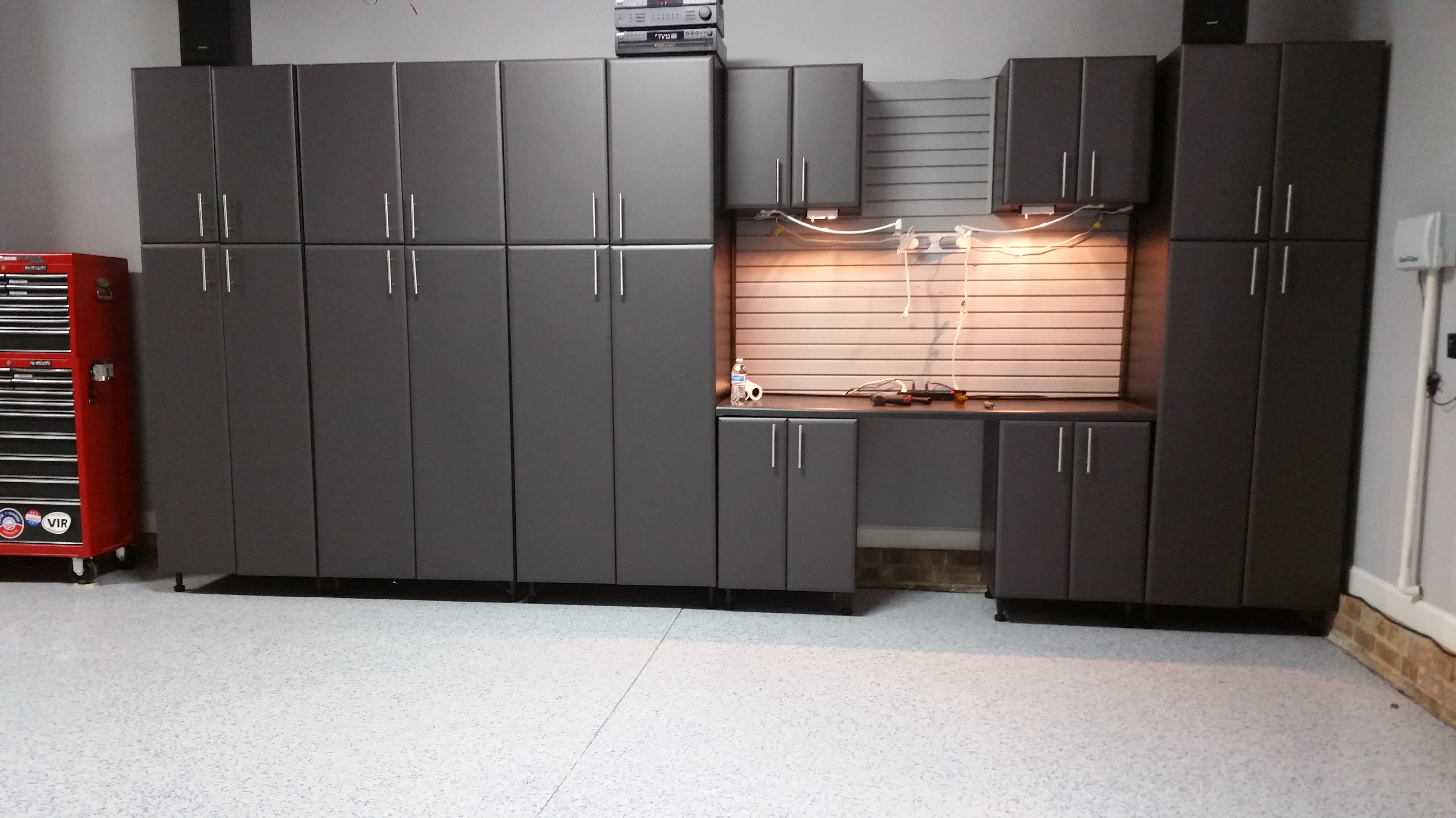

First, apologies for bringing up an old thread. It may be too late to help.
My epoxy floor installer used grinders to grind down the concrete before application instead of acid like most folks. That would likely do a great job removing any old finish.
In my case, the previous owner had put down those plastic tiles (RaceDeck?) which had become dirty and stained, it looked like they never cleaned it (I'm a bit OCD) and water, dog pee, etc. would drain between the tiles and dry on the floor, so the whole garage smelled a bit and of course when I took it up, I had patterns left behind. It was also noisy and did I mention dirty? I bet it looked great when it was new though.
I've been very happy with the epoxy, although all of my cars have had hi-po tires like the BW, so I've got a smidgen of staining as well. I clean/scrub the floor usually twice a year and can get up most of it. I figure that most of the time the car is parked there, so I can't really see the stains.
I also have huge cabinets, and I paid my installer extra to move them all outside and do it right. They tried to weasel out of it, but I insisted. It was a major PITA for me to remove all of the screws and whatnot holding them together and to the wall, but in the end it was worth it.
