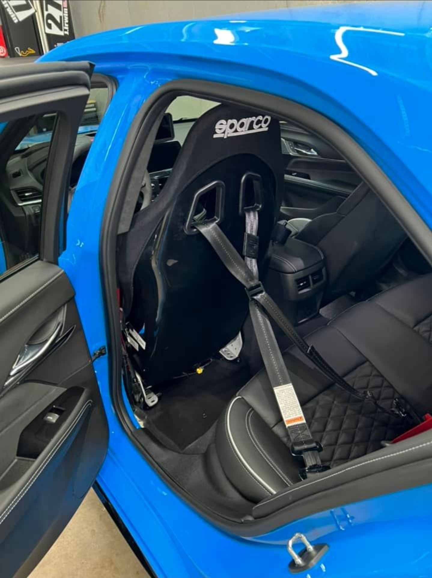

Please let me know if you have a recommendation for a harness bar. I did a few quick searches and came up empty. Thank you.
IMHO…harness bars are a recipe for disaster.
Use a Simpson Hybrid S and/or get a Scroth 4-point that uses OEM seat belt attachments.
OEM seats are designed to ‘break-away’ in a lay flat position in the event of a rollover. A harness bar would prevent that from happening.
I will second this opinion, If you want to run in a fixed position your better off having a roll bar and a proper racing seat.
Agree with all of this. I've used the Simpson for years. Works great.
I'm willing to accept the risks to get more headroom.
