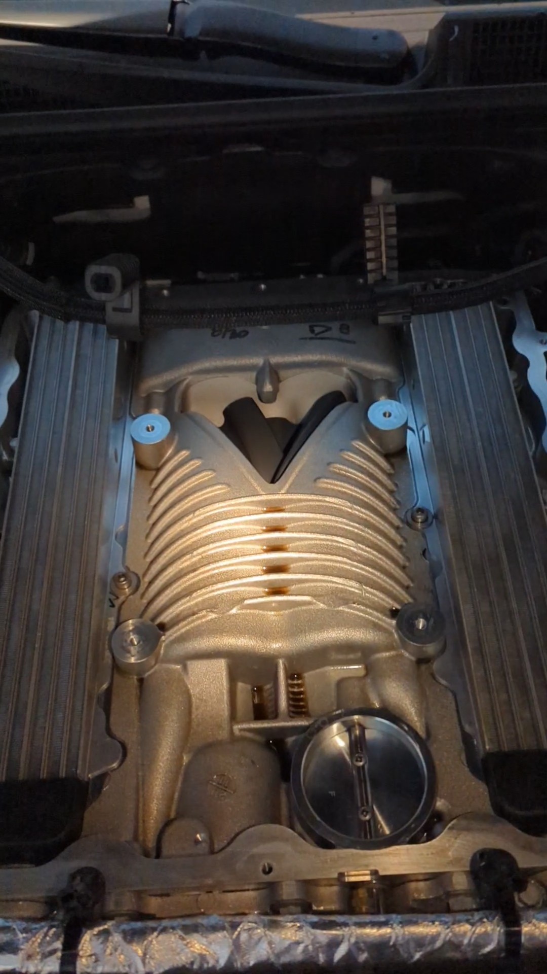

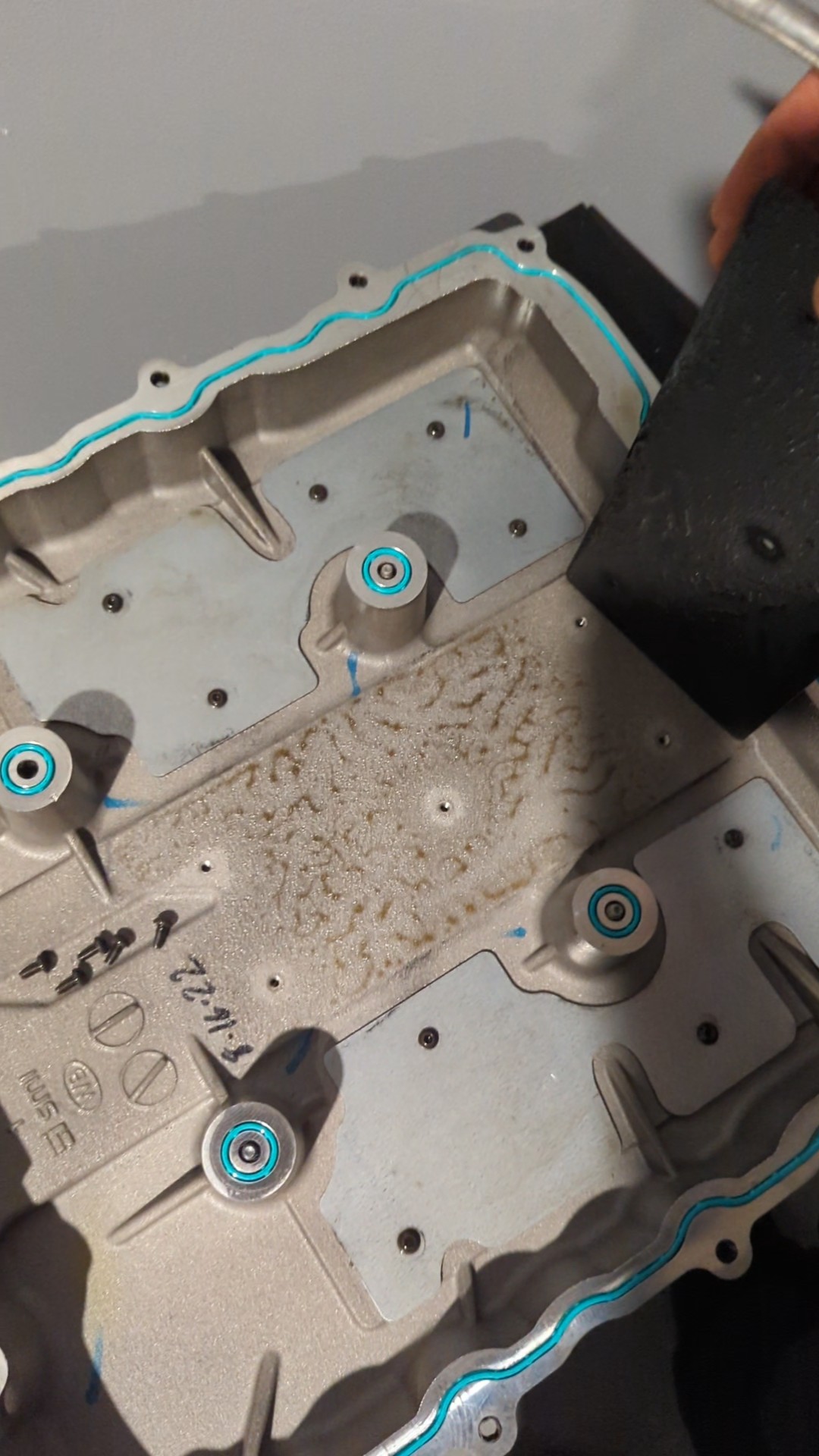

I just completed the Elite Engineering E2X catch can install for my 5BW a week ago, and with only 1,300 miles the SC intake was already covered with oil. I am doing a 1,500 mile break-in (Yes I know it is only 500 miles. I'm anal, and plan to track it) and have not broke 4k RPM yet. Even with never going full throttle there was a lot of oil. I would recommend a catch can install to everyone with a Blackwing CT4 or CT5. If this much oil was on top of the blower at 1,300 miles imagine what the valves will look like at 30,000 miles.
The install was pretty simple. Hit me up if you want the torque specs and order for the bolts on the SC cooling cover and for the SC. I attached some pics of the SC intake cover removed to show the oil on top of the blower. Also I did not have to cut any factory lines. There is a great guy on you tube that I got all the connectors needed not to cut the factory lines. Look for Garage King on you tube. He has all the information you need to keep from cutting factory lines on the 5BW. If you use the Elite engineering PCV diverter you will have to file down part of the barbed end. They said they are fixing this.... but I don't believe them. It seems to have been an LT4 issue for a while, and they have not fixed it.

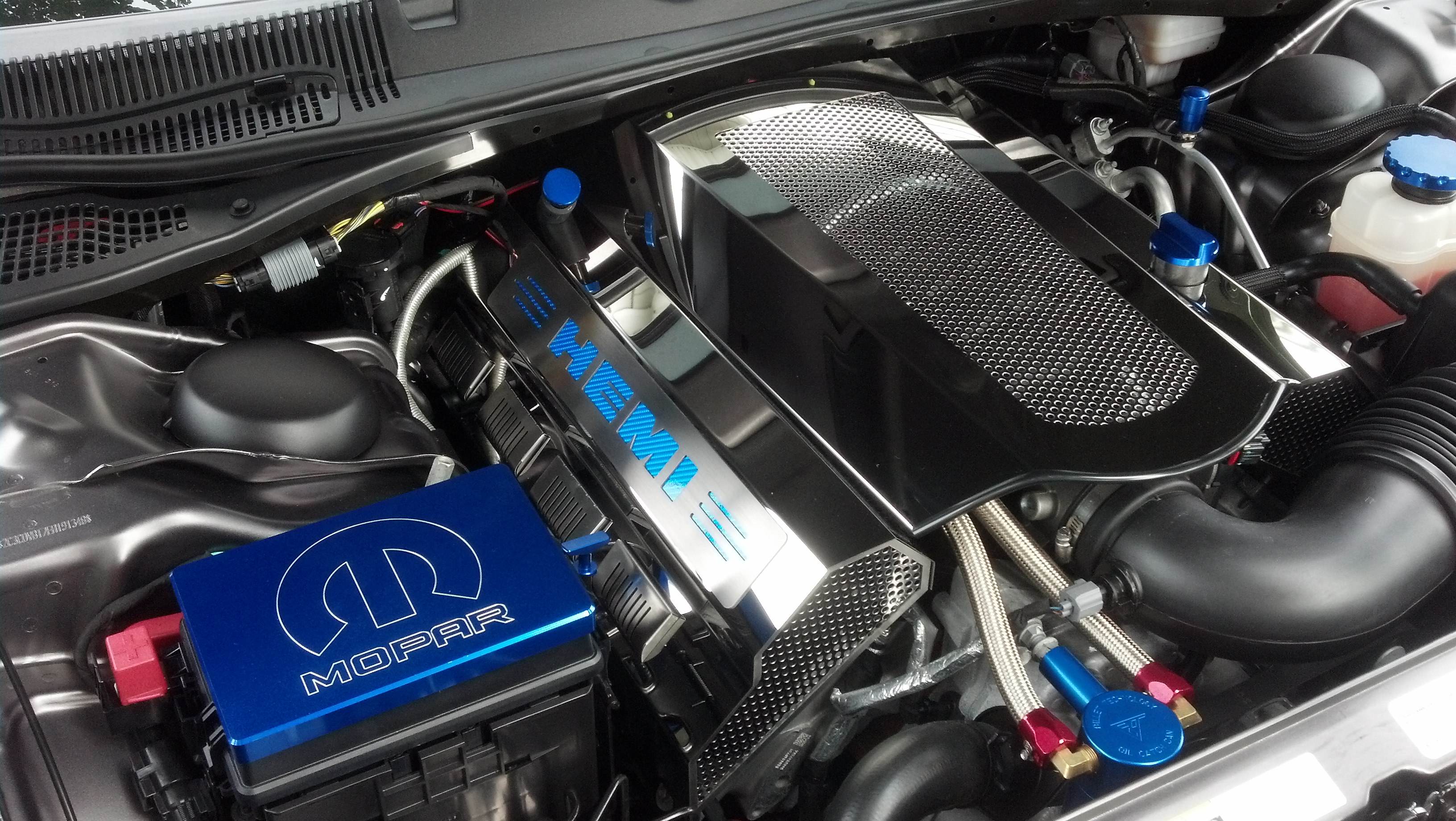

I have a catch can on my Challenger 5.7 HEMI. I have to manually empty it at every oil change and I get about 2 shot glasses of oil out of it. After 36,000 miles of driving , I have collected 20 ounces of oil ! If there is an "internal" catch can, how does it get emptied ? Post a picture of what your placement of a catch can in your 5BW looks like. Thanks.

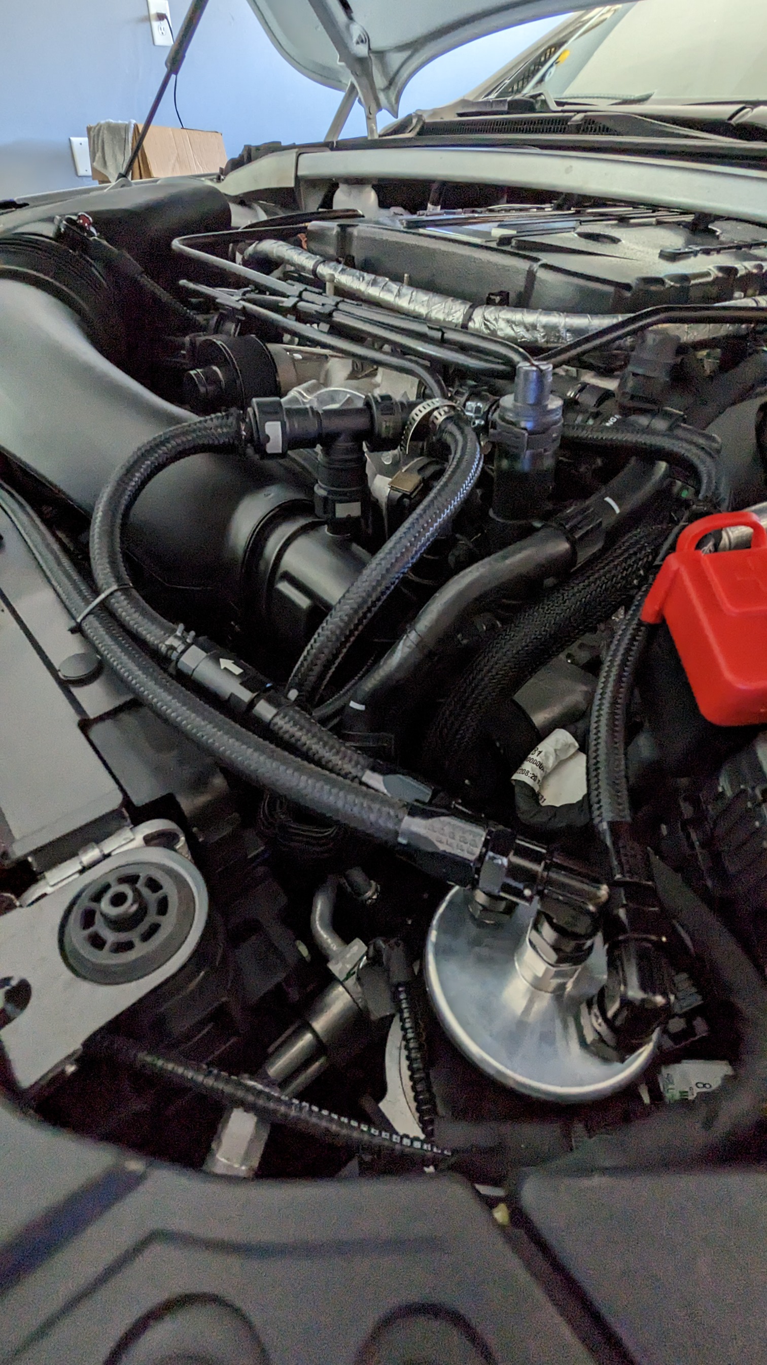

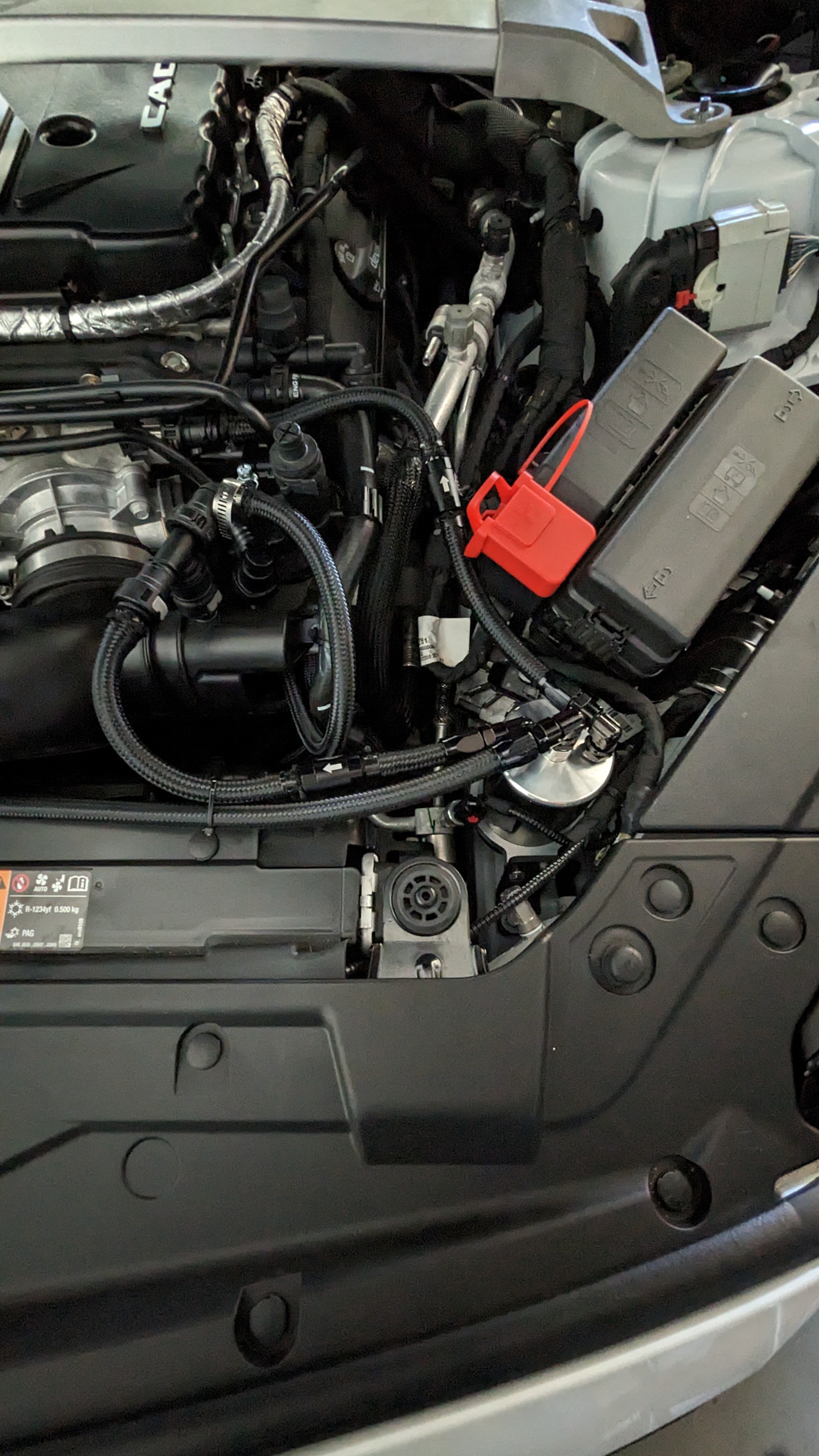

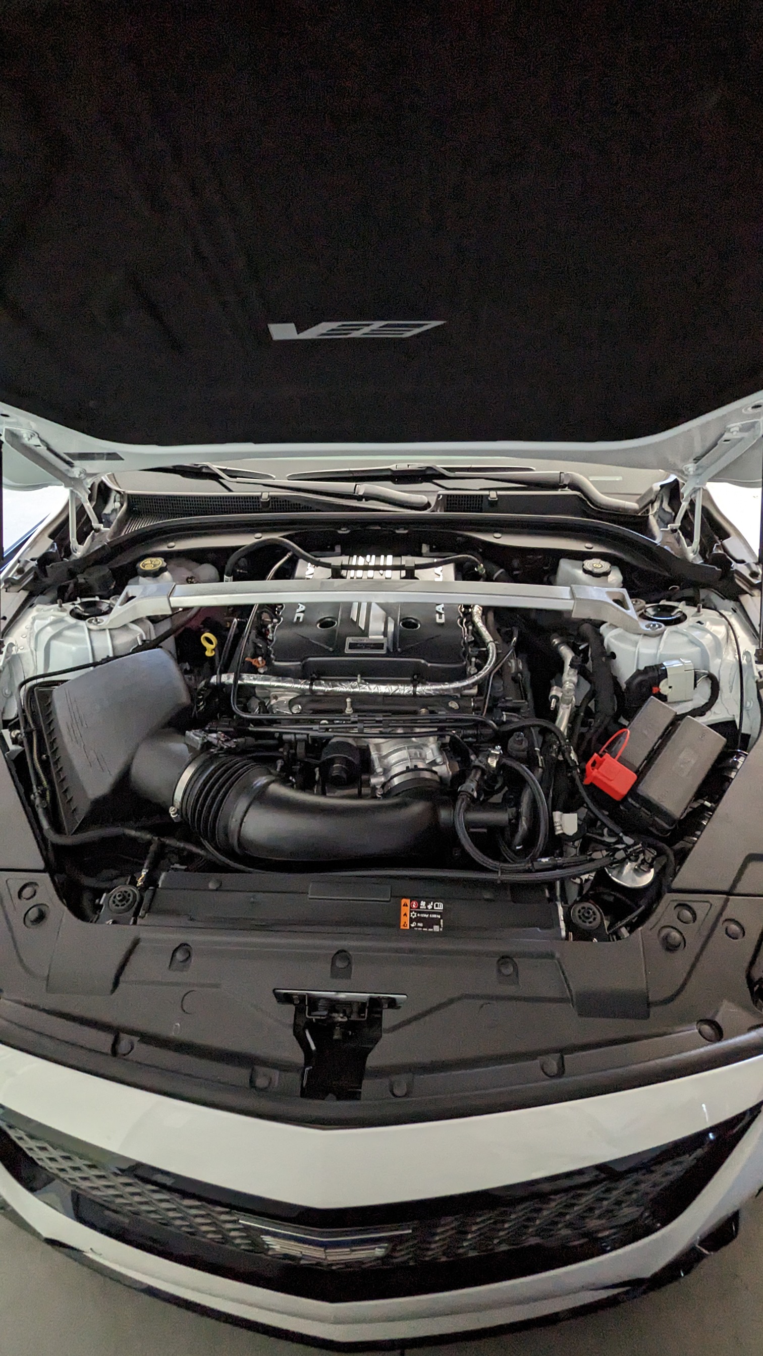

I attached pics of the almost finished product. I need to clean up the routing of the lines and put some heat shrink over the ends of the lines to cover the frayed black nylon and SS braiding from the cuts, but it is good for now.

My Billet Tech catch can was a simple install on my Challenger. Just needed to pick a convenient spot for access. It takes me less than 5 minutes to unscrew , empty, replace. It only has two lines (in/out). Your photos looks like it's in a tight spot . Is it a pain to empty ?
Now your just showing off!! That engine bay is DOPE!! I haven't had to drain it yet, but it shouldn't be too bad. There is a simple valve to turn at the bottom of the elite catch cans. I would just have to put a cup under it to catch whatever comes out.
My catch can on my ATS-V was similar. I just have to make sure whatever cup I use is big enough to not overflow. The elite kit also came with a hose to remotely locate the drain somewhere else. I didn't use it yet though. I want to confirm how fast the can fills up. Once I confirm I can just drain at oil change interval I will place the hose under the car somewhere to drain during oil changes.

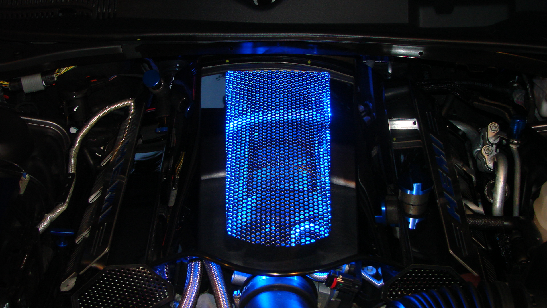

Now I'm showing off ! The engine bay has blue LED lights for night car shows. My 5BW is in storage for the winter. Next time I visit , I will check to see wear I can easily install a catch can. I downloaded Elite Engineering website. Can you post a photo of where your hoses are attached, away from the catch can. I see that some catch cans have only 2 hoses and others have three. Thankx.
