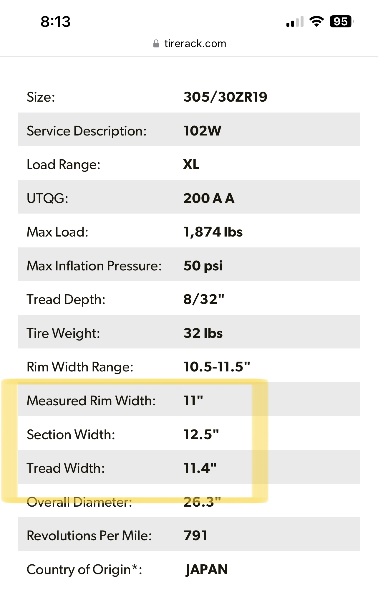

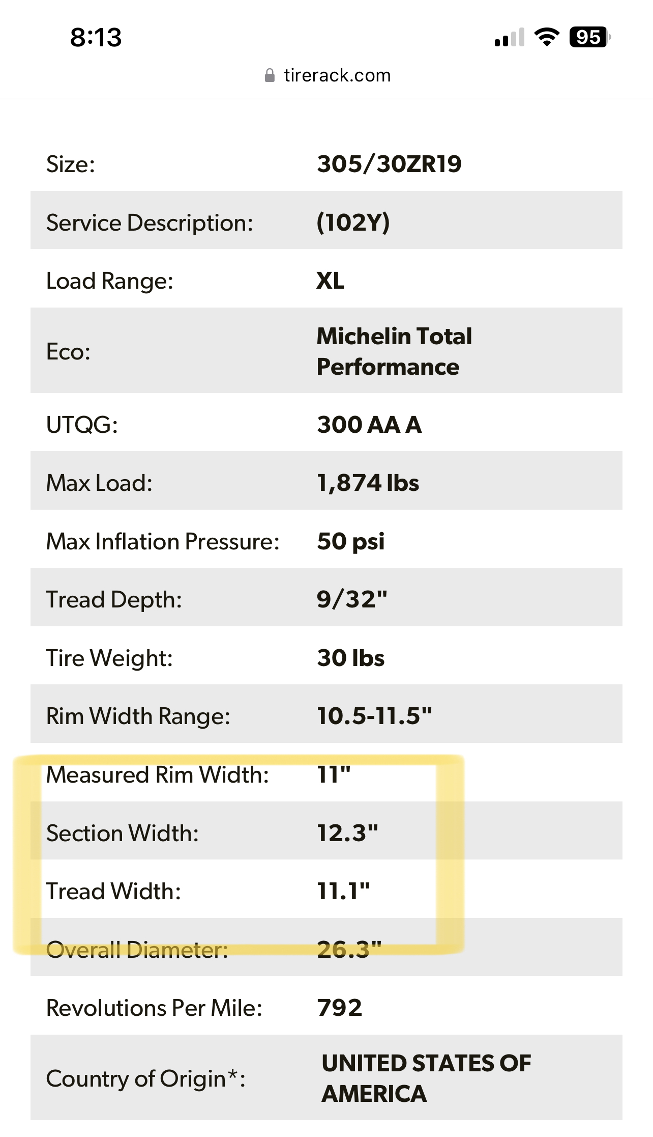

Almost certainly a 315. But honestly, it depends on the tire.
The Falken RT660 305 is wider than the Goodyear SC3 305 and RE71 305.
In the 200TW space, all the big manufacturers are at war to be the best tire. Some cheat with compound, some cheat with size.
A good resource is on the Tire Rack website under the ‘specifications’ tab for each tire you are interested in.
I attached the 305 RT660 and OEM PS4S for illustration.
Hell, you can look up every PS4 for the same size and they'd be difference thread width between OEM manufacturer. Audi and MB seems to like their version to be narrower.
