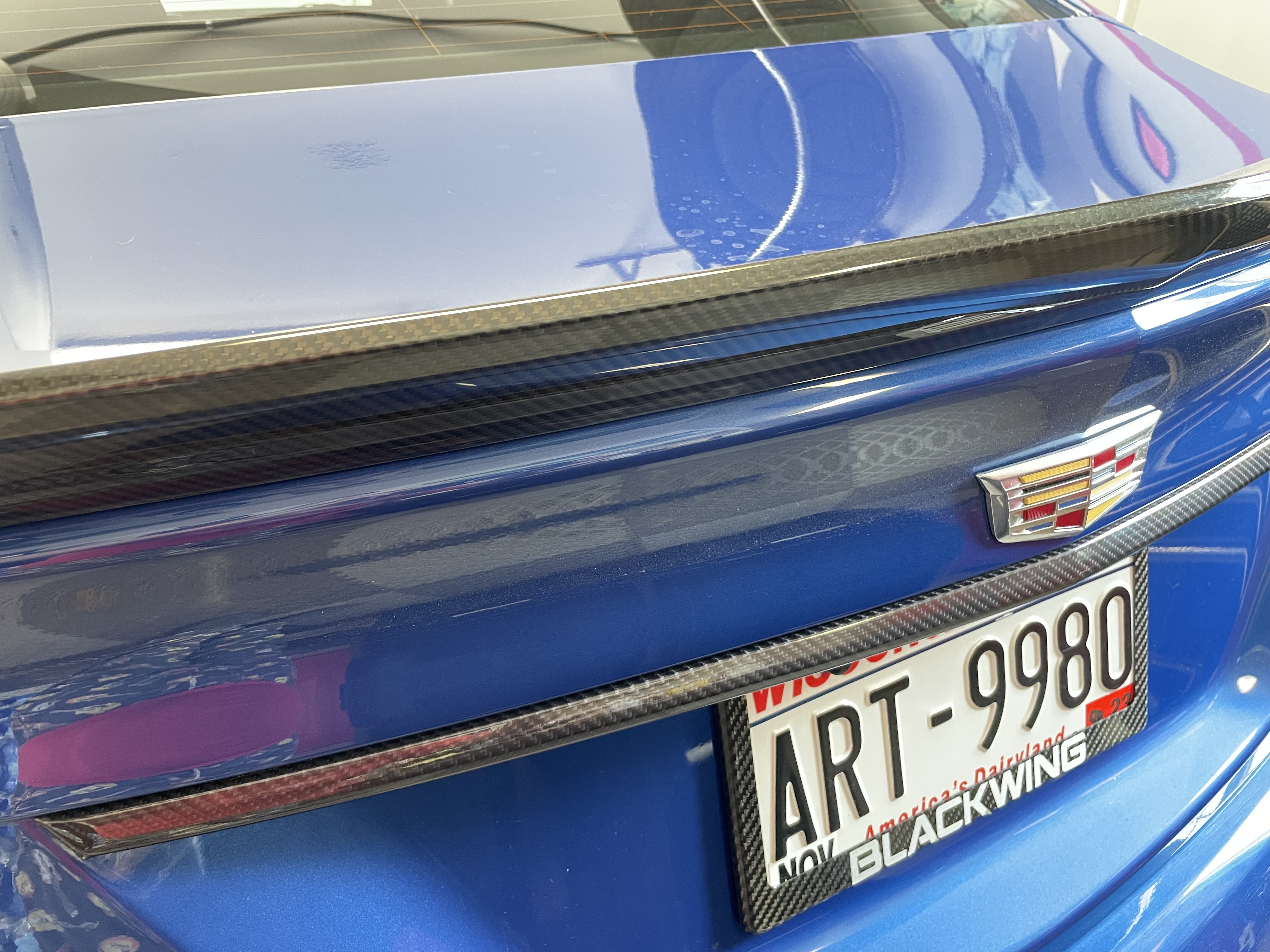

I've been wondering about wrapping the entire front grill surround in Carbon fiber? I did the rear trim piece on the trunk lid and it looks pretty good. Match to the spoiler is not bad. I included a picture.

Where did you get the trim piece for the trunk (just above the license plate)? Part number?
That trim piece above trunk is not carbon. I wrapped it quickly to see how it matches. I didn't even remove that trim piece to do it (not sure how).
