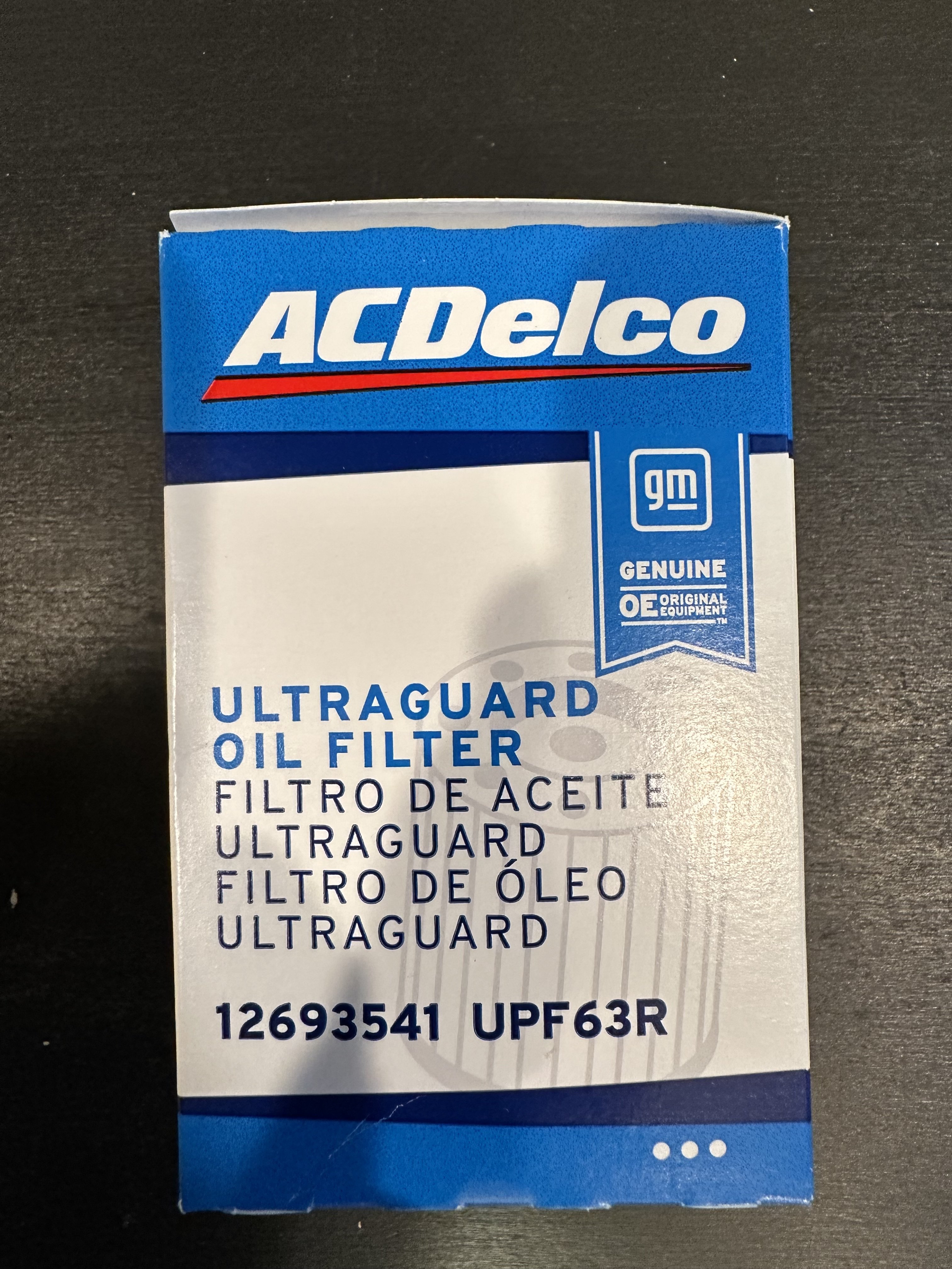

The UPF63R is the higher performance/quality version of the AC Delco PF63 filter. It does fit our LF4s. Think of the UPF version as the XP line from Wix or the Gold version of a Napa filter, all of which are noticeably more robust when compared side by side to their standard filters. It is the only filter I have used on mine. Buy a bunch from Rockauto and the unit price is the best around.

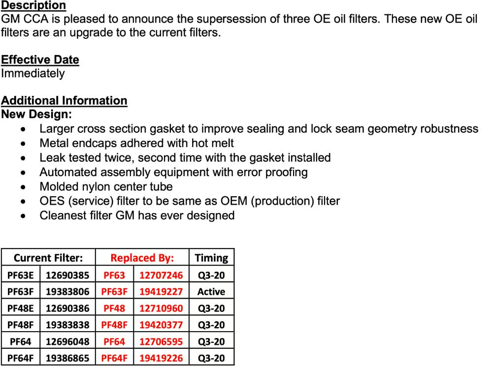

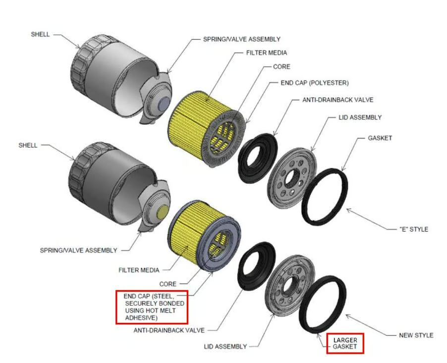

The PF63E is actually not newer, its been discontinued, it was implemented as a fix for the older, original PF63 (part# 89017525). AC Delco revamped their filter line, discontinued the PF63E, issued a new part # for the PF63, and that is the current state of the world.
The UPF63R is a viable option if you feel you need a higher bypass pressure. As far as construction differences, the UPF has a perforated metal liner and the PF has a plastic liner. Also, the PF has more inlet holes and they are of a substantially different design than the UPF. Both have a rubber gasket and rubber anti-drainback valve. The body metal of the UPF is a bit thicker but both are rated to something like 250+psi burst pressure.
Its tough to nail down specific performance but UPF says it can filter 98% of particulates down to 25-30 microns and the PF63 just says it filters down to 30 microns. Its also worth noting that according to some Youtube vids that deep dive oil filters, the PF63 has about 20sq. in. more filter area than the UPF63.

This is from mid 2021 showing why you want the new PF63

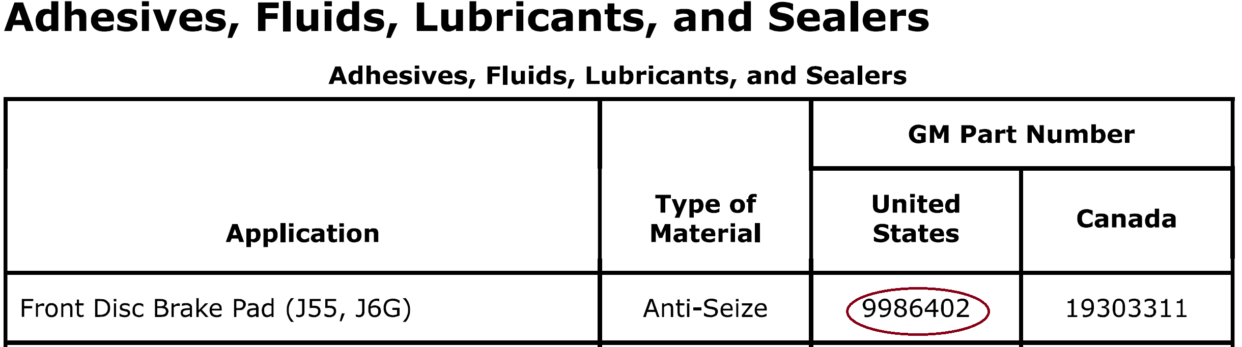

(2) Getting the actual correct information - is the listed part the correct part for your specific version of the vehicle question. Example: I am still looking for the Front brake pad Anti-Seize lubricant. I went to 2 Cadillac and 1 Chevy dealer. It is a bad part # Bt you need this part o performed a front brake pad replacement per the manual:

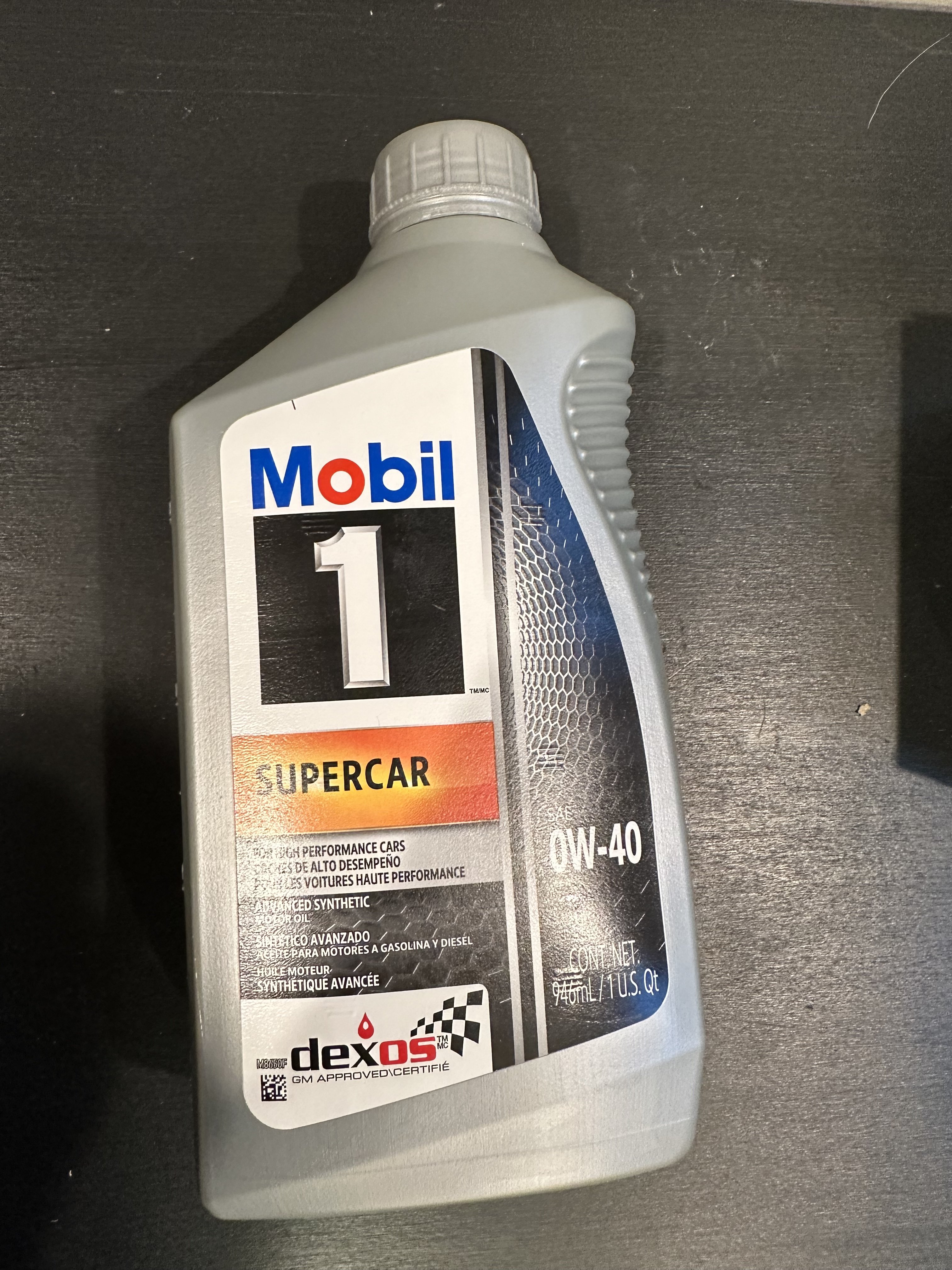

Coming back to your oil filter question, the current Cadillac CT4V Service manual calls for an Oil Filter replacement using 12707246 - PF63. The same manual calls for 5W-30 19293000 OIL. But we know that the new guidance is to use the new DEXOS R - Mobil 1 Super Car oil.

Below are the parts that I am using:
They are higher spec/more expensive than the Service manual calls for. However, since they are going into my $80K car, I would rather spend $25 more in parts for an oil change. I am also changing the oil about every 2500 miles.

Filter Part # 12731742 replaced part# 12707246. My cadillac dealer used the 12731742 when I had my oil changed recently.
Thats...strange. That part number only shows up on 2 wholesale parts suppliers and both list it as a special order item.
AC Delco and gmparts.com dont even acknowledge that part exists, neither does Rock Auto

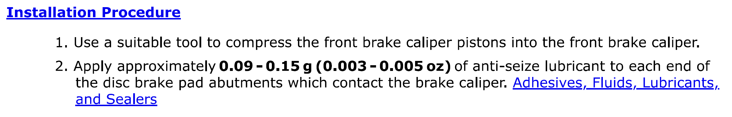

Yes, confusion continues. The brake pad procedure references the use of the anti-seize compound and notes to check the Lubricant Sheet.
But the Lubricant sheet has bad info.
@jodakid69 I wasn't able to make the V-Club Tech Talk last night with Brembro, but watched it this morning and didn't see your anti-seize part mentioned or asked about, so I e-mailed Ryan Bates who will forward the question along to Ben at Brembro and hopefully have an answer for you.
As for the brake fluid, Ben said that some "race fluids" are "too corrosive" for cars that's aren't purely track vehicles and can damage ABS systems, brake lines, etc. He DID recommend changing your fluid to Brembro LCF 600+ or to Castrol SRF if you plan to track your vehicle above a novice level.

@jodakid69 I received this response from Ben at Brembro
"The lubricant he's referring to is a copper paste that is applied to the abutments (ends) of the brake pad backing plate. It's not intended as an anti-seize, but rather to help with brake noise (it decouples the pad from the caliper body).
It used to come in the brake pad kits, but GM had us remove it and now all GM dealers are supposed to stock it.
I have a bunch of 5g tubes that I can send to your club member. Get me his name and address and I'll get some shipped out."
