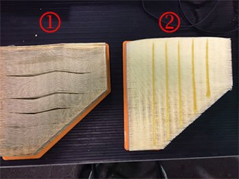

Inspect the air filter for damage from being collapsed*shut*as shown below by filter #1.*
Replace the*air filter if it is incorrect
attachment.php
  1. This is the incorrect air filter with no glue lines
  2. This is the correct air filter with glue lines
Note: Technician must ensure that filter has glue lines (call out 2 above).

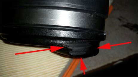

If this is encountered the air duct should be replaced with the air filter.*
attachment.php
When the air duct collapses it may come in contact with the*supercharger idler pulley*
Do not replace ECM, Throttle Body.
