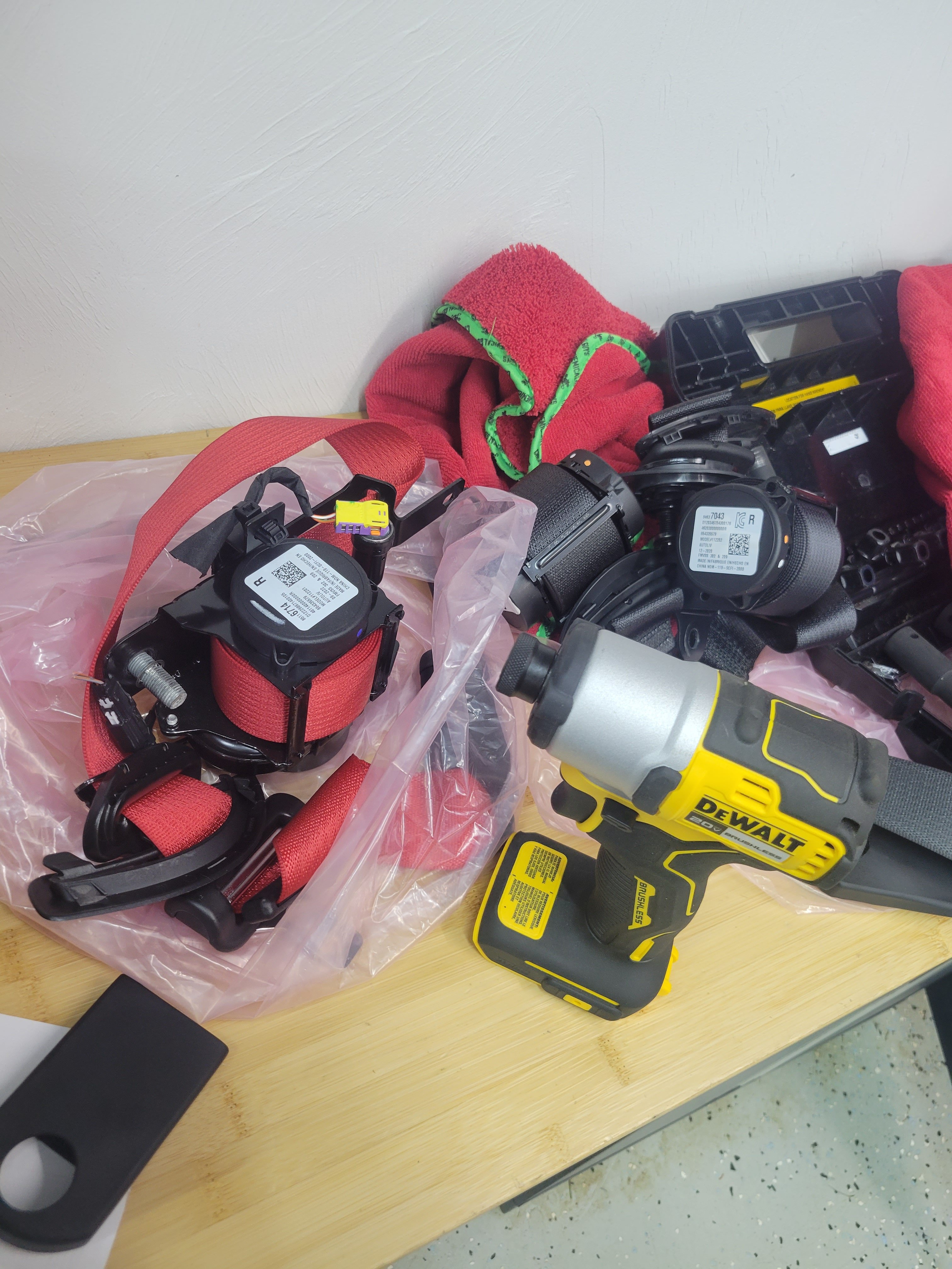

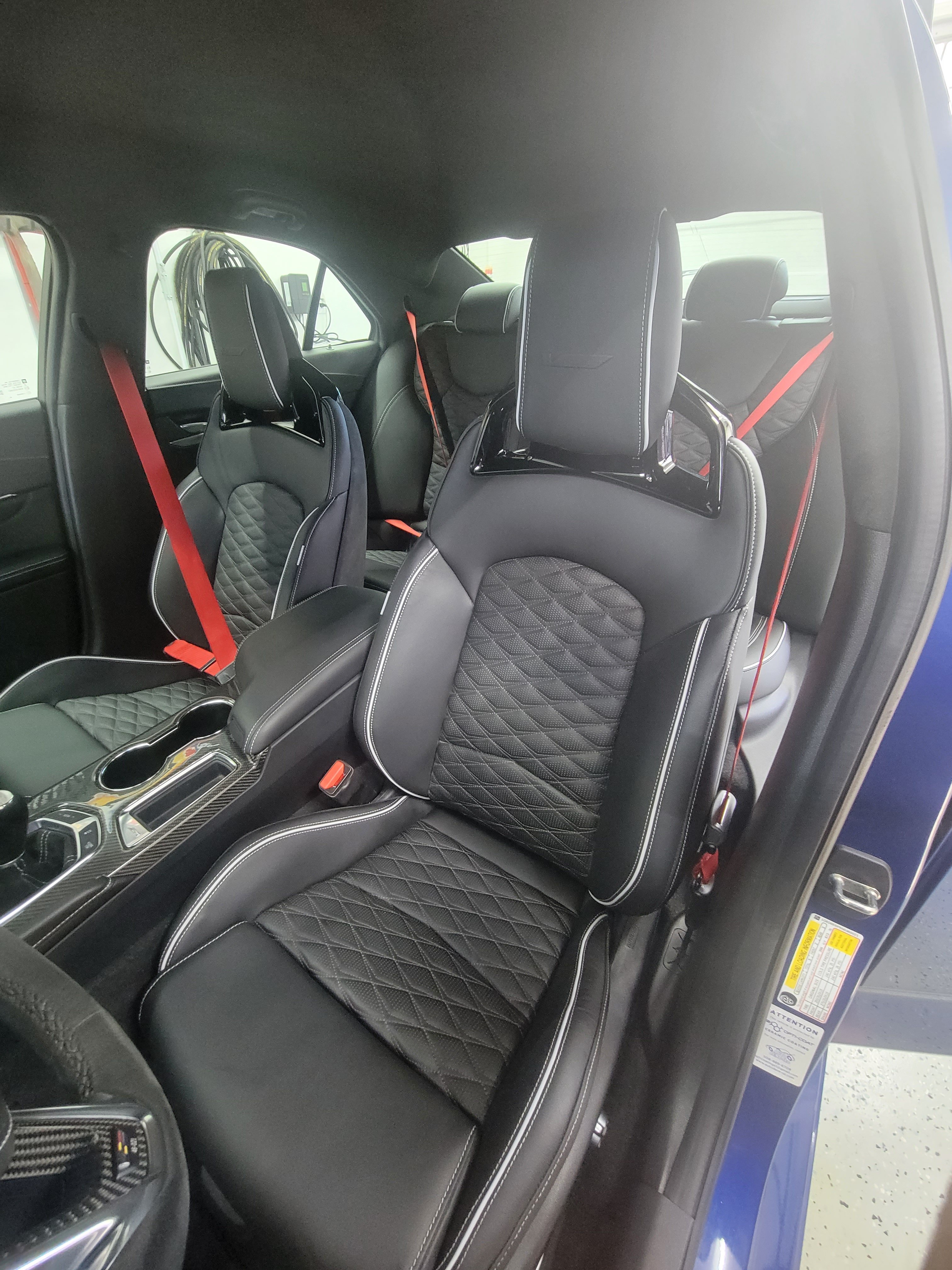

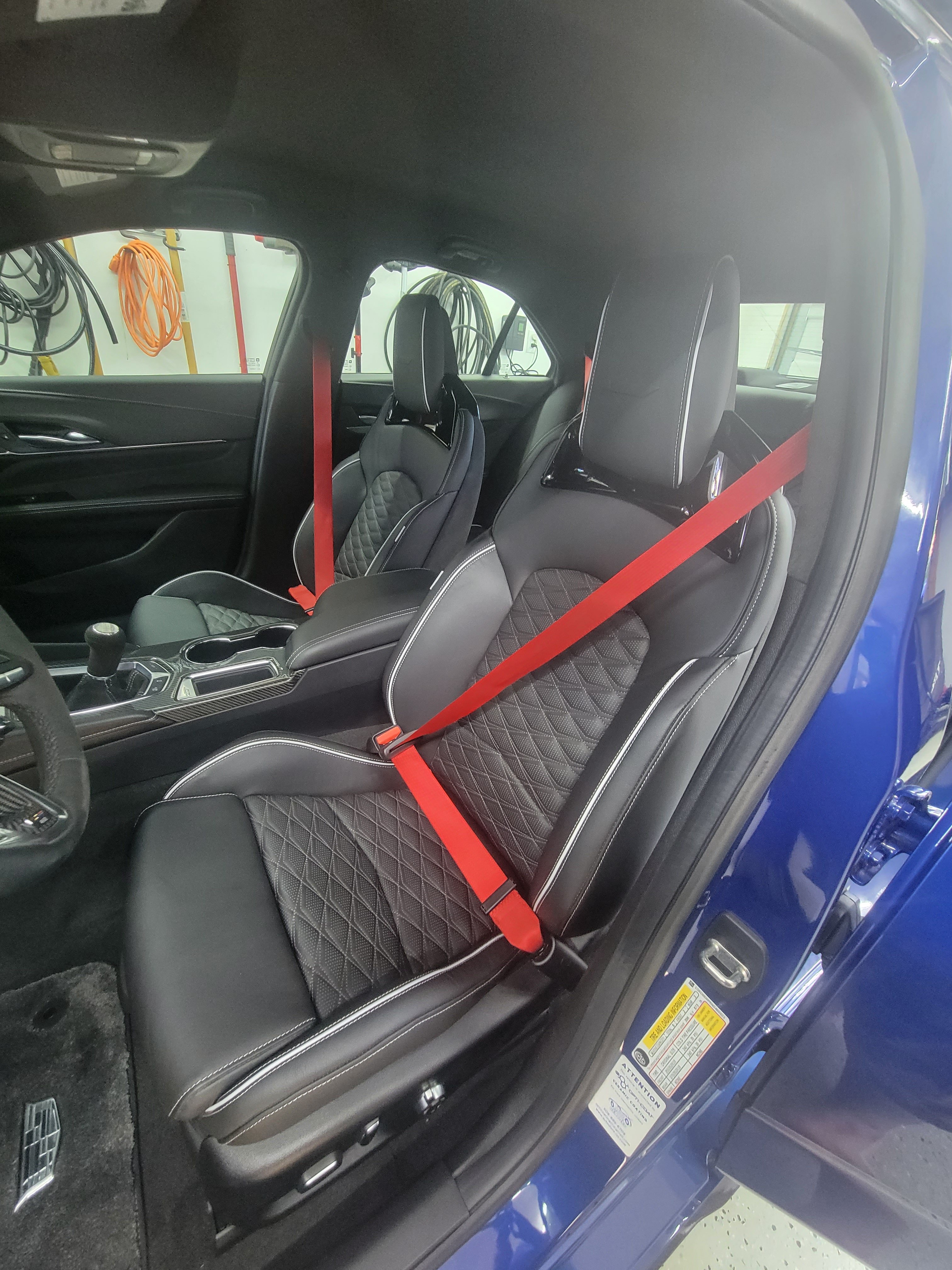

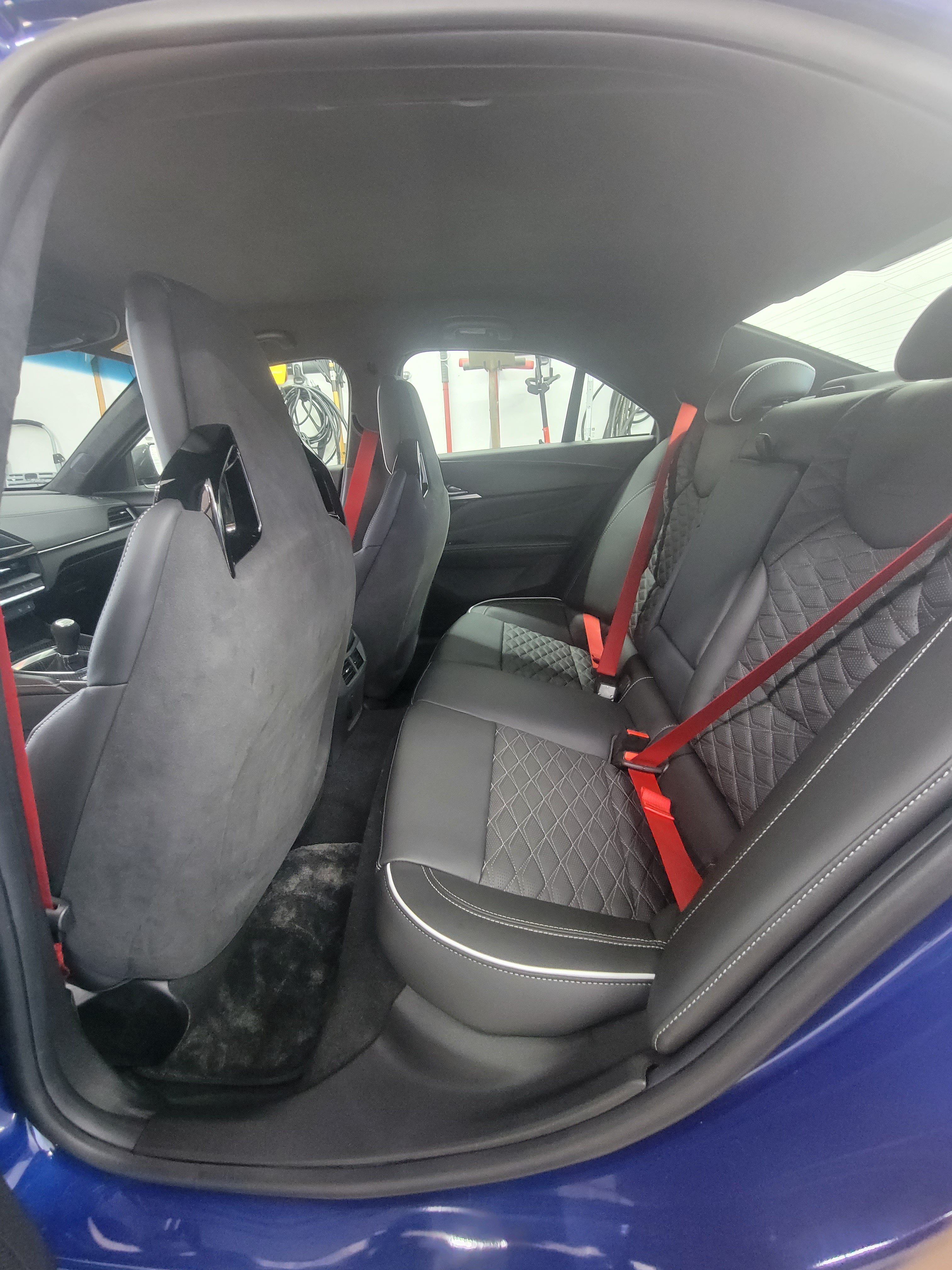

Anyone upgrade to red seat belts to replace your black oem ones i did 😆.

How hard was is, what was the cost? Looks awesome and I regret not checking that box everyday!
This looks great! It also looks hard to do…
Don’t the front ones have pretensioners?

yes on the pretensioners.
glad I went with the red belts on my build

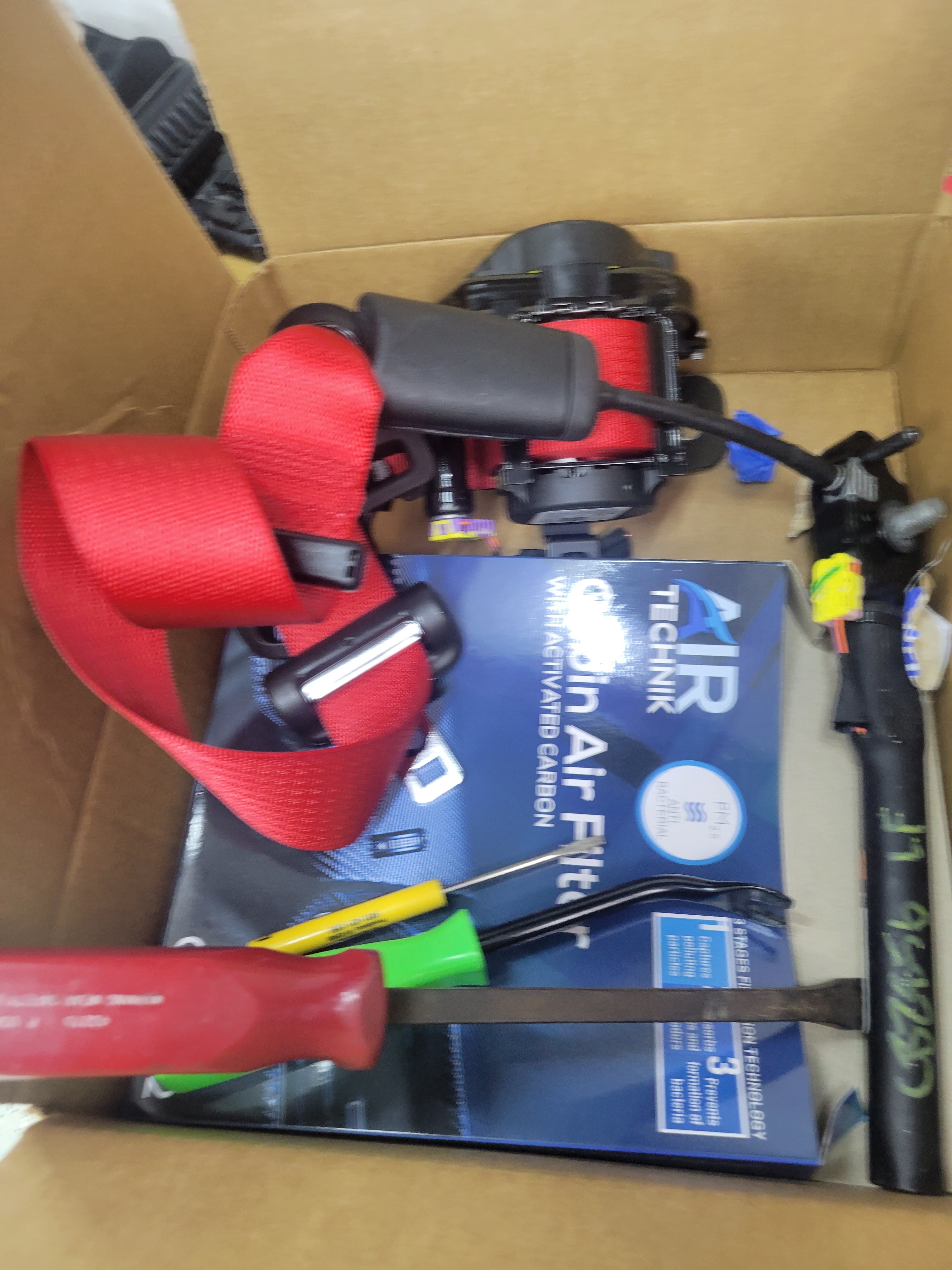

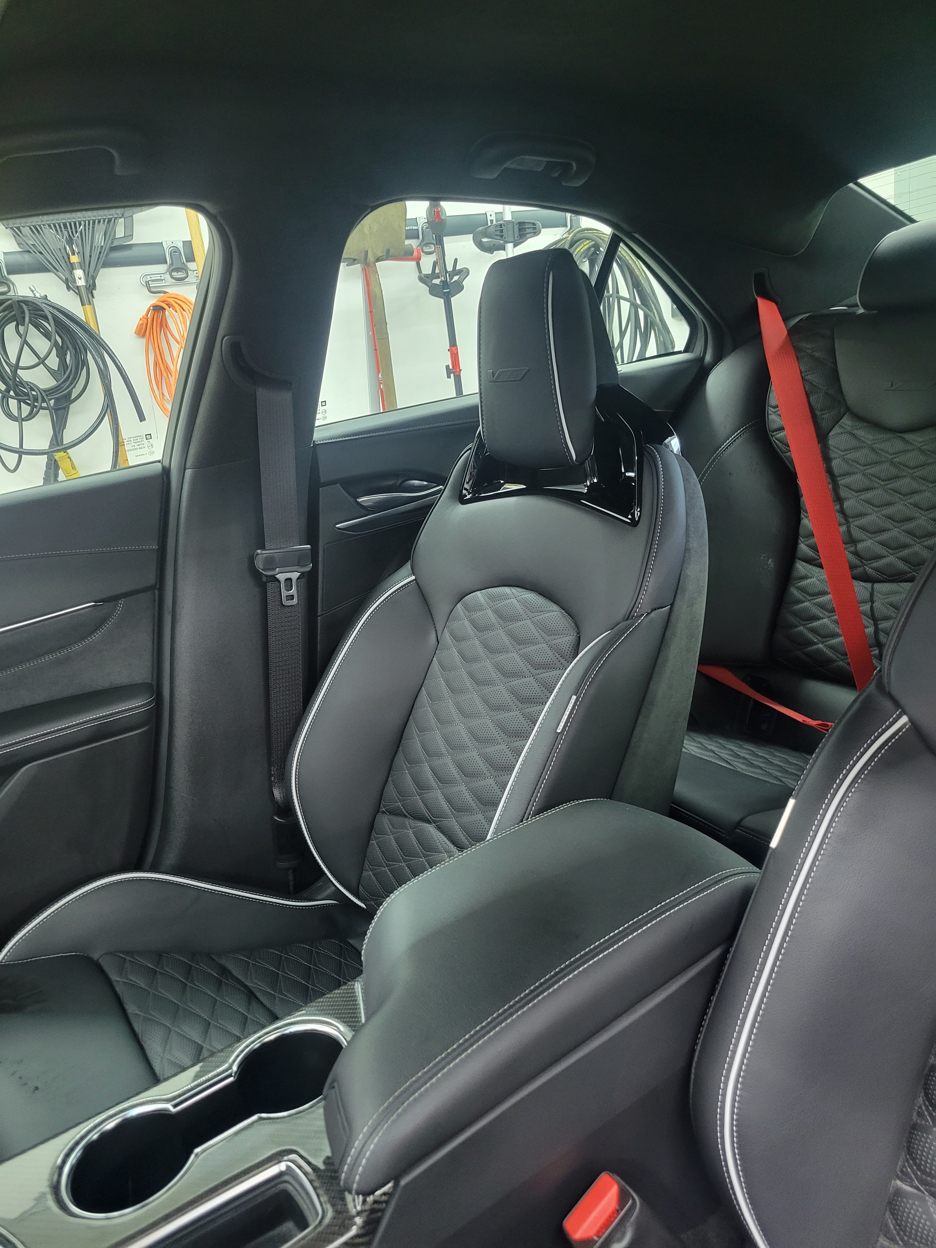

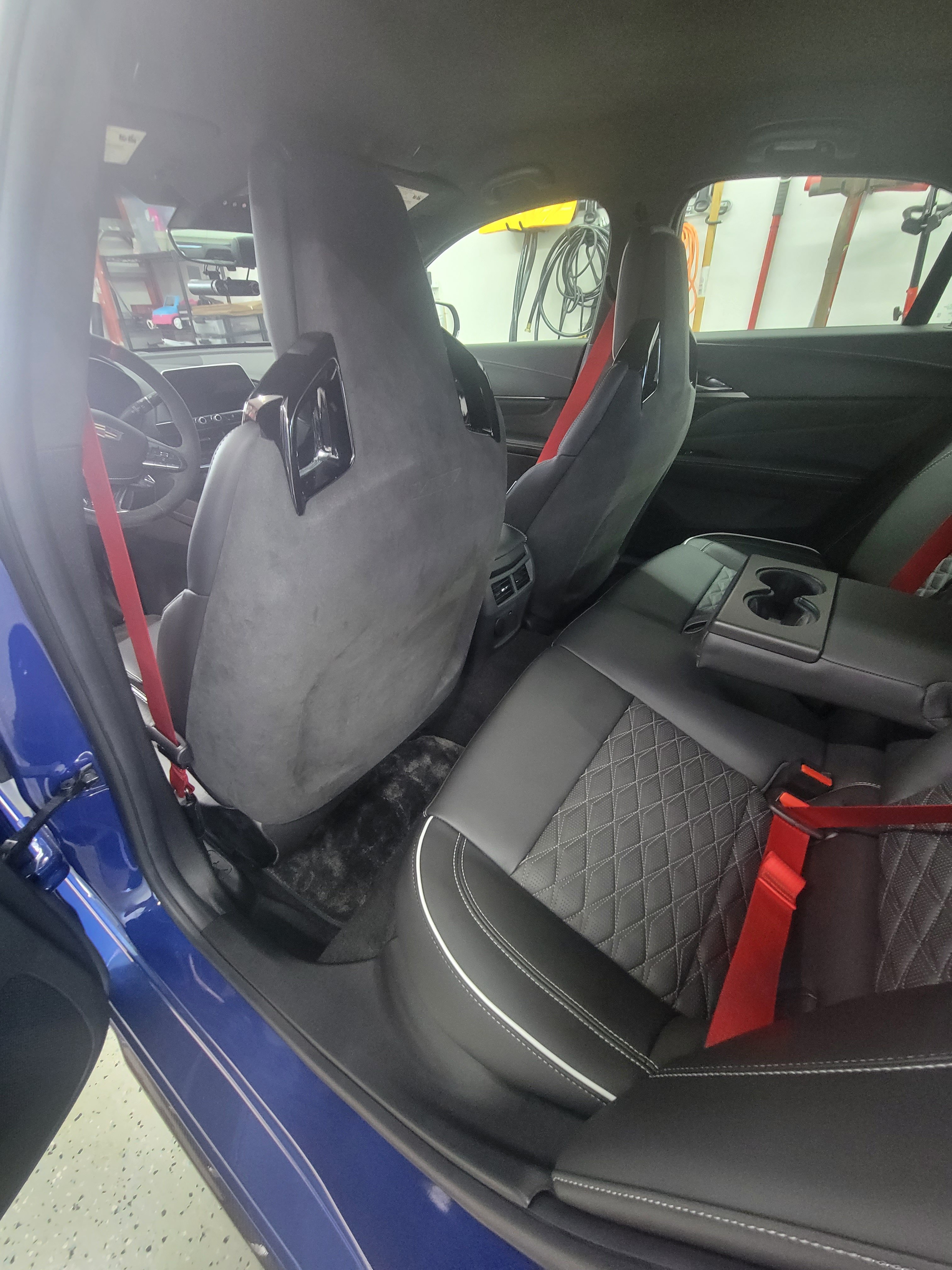

Seat belts are all installed no airbag light and the pretensions all working like they should.

How long was the install
vs. $400 upgrade?

Go to acdelcotds and pay the $22 for a 3-day subscription to the service manual. It’s rather straightforward. If I had the part numbers for the 5BW, I’d have already done it.
5 BW Red Seatbelt part numbers are as follows:
LF 85641155
RF 85641159
LR 84815184
RR 84815180
Verified 22/23 are the same
