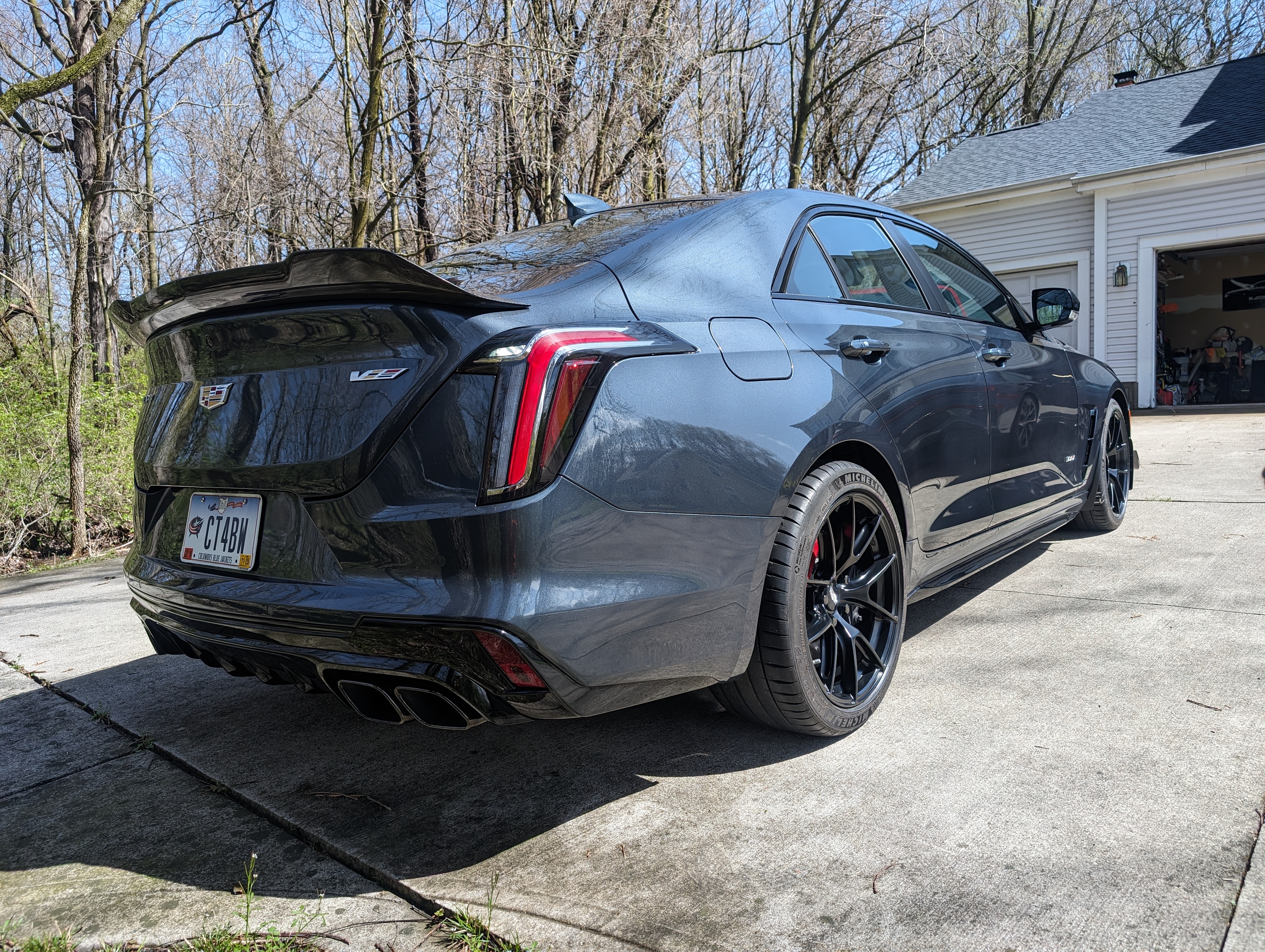

I have no idea where Tapout's rear spoiler is made, but it's identical to OEM and just as solid. I literally held it up to the OEM on their car before I bought mine. I'm using OEM front pieces but using the Tapout rear spoiler.
The photo of the spoilers is the OEM non-CF on the left after removal, and the Tapout CF on the right. I added foam seals around the studs to mimic the OEM foam gasket to reduce the chances of water entering the stud holes. It already had the black foam gasket around the edges, but is not sticky like OEM.

have to ask--
what lug nuts do you run with your VS-5RS wheels??
this was the only thing holding me back from making the swap to my summer set last weekend (but mine are brushed clear)

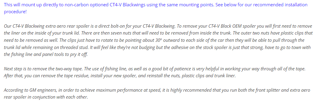

Is removing the factory non-CF wing hard to remove? I thought they were all held on by mounting tape only.
adhesive and 7 nuts on the underside of the spoiler
see installation directions from Tapout below:

I used the stock lug nuts. They are 60 degrees as are the wheels, and they confirmed they would work. I just installed them today with my original summer tires.

It is a PITA to remove. there are other threads discussing it. If you look at mine closely you'll see the effect of teh sticky tape. Use fishing line, don't pry EVER, and good luck with that outer stud that slides into a clip that doesn't release and impossible to get to.
