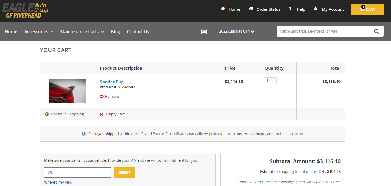

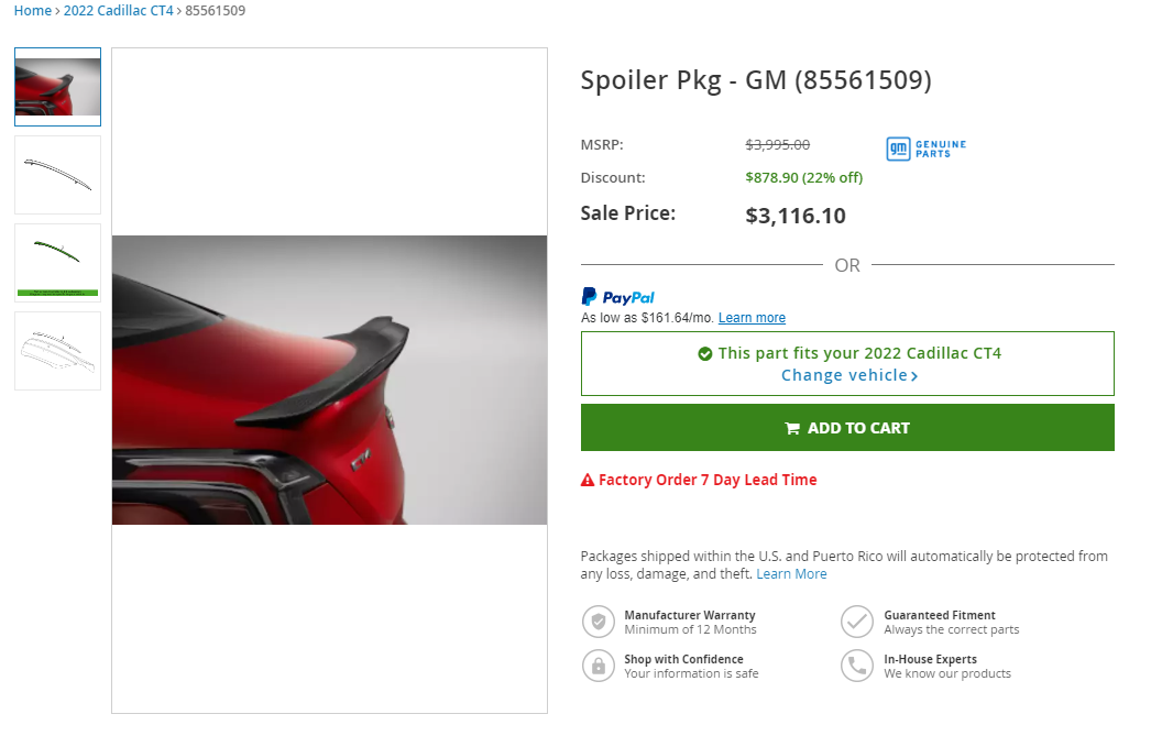

I checked that number 85561509 on a couple sites and it successfully added to the cart. Do they take the order but then respond it isn't available? gmpartswarehouse warns there is a 7-day factory lead time.
Emailed GMPartsWarehouse and they said the part number has been replaced with this - 86543474 - but Cadillac hasn't released it yet, and so there's nothing until they do.

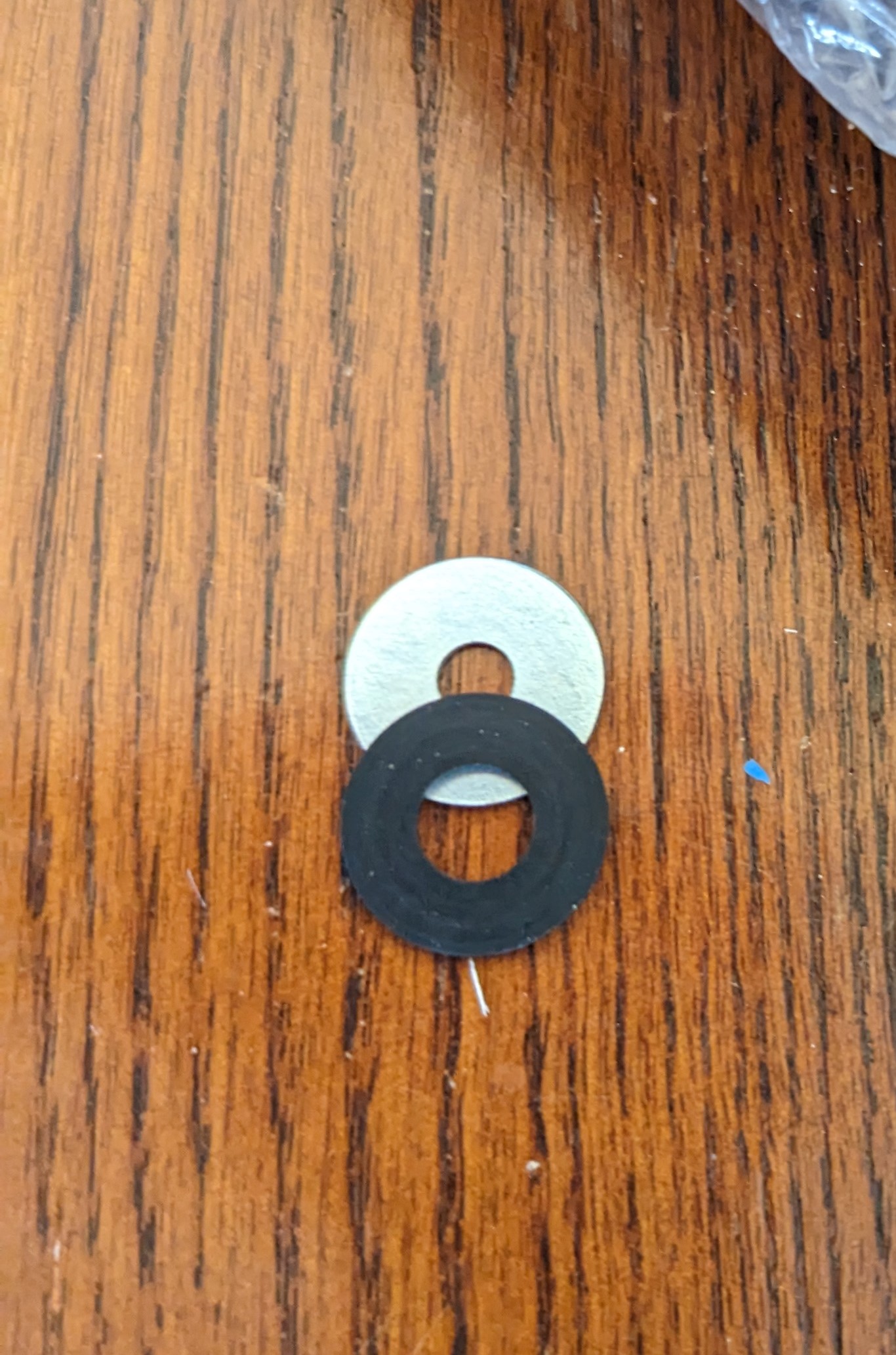

The OEM spoiler nuts are nylon lock nuts. Integral washers if I recall. I reused all four of those, and added two with large fender washers with rubber washer underneath on the outer that the factory used that irritating plastic clip that won't release.
You're right about the potential for distorting the trunk sheet metal. The factory spoiler gasket runs around the studs so there is support, but the repro carbon only has a gasket on the outer edge, so tightening the nut can dimple the metal around the stud. I added a foam gasket around each stud of similar thickness and density to the outer edge, and only tightened the nuts until they had snugged down.
The dark nuts in the photo are the re-used factory nuts.

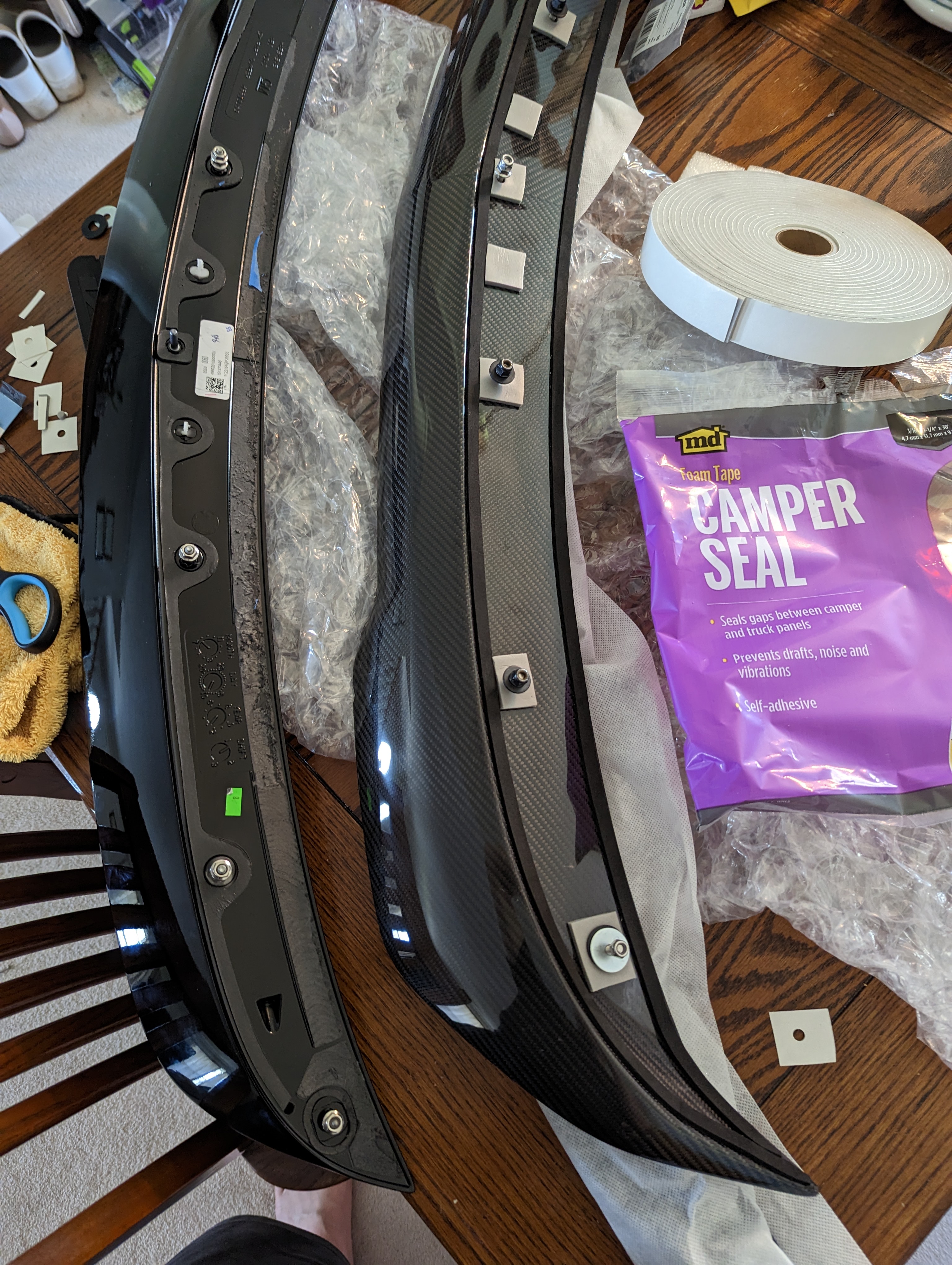

Update #2.
Successfully installed the second wing that Tapout gave me after I cracked the other one at their shop, and hung the cracked one as a trophy. As a reminder, I had to find weatherstripping for this. Pays to live near a McMaster-Carr.
Used 1/4" foam rubber stripping on the forward of the wing, and 1/8" on the rear. Would've used 1/8" all around, but there was the smallest gap at the front when the front had 1/8", so better safe than sorry. Shot the wing with a hose on jet setting, and FINALLY no water.
