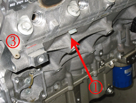

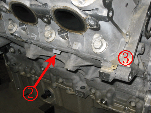

Inspect the position of the head gasket locating tabs, to determine if the head gasket(s) has been possibly installed backwards.
Per the attached pictures, the head gasket locating tabs for both of the engine cylinder banks should be toward the front of the engine.
#PIP5212C: Concern Of An Engine Thermostat Tick Noise And/Or Running Hot - (Mar 30, 2021)
1. Bank 1 tab near cylinder 3
2. Bank 2 tab near cylinder 4
3. Is the front of the engine
If the head gasket locating tabs are found to be closer to cylinders 5 or 6, this indicates the head gaskets were installed incorrectly restricting the engine coolant flow.
Replace the head gasket to repair for this concern.
Note: GEN5+ engines (L82, L84, L87 all model years).
