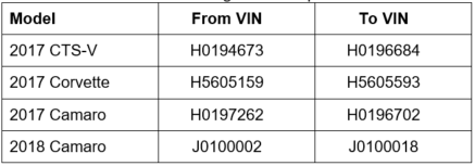

This condition has the following VIN breakpoints:

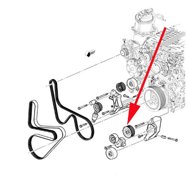

If the pulley sound is found, replace the idler pulley assembly. (Fig. 12)
Fig. 12
