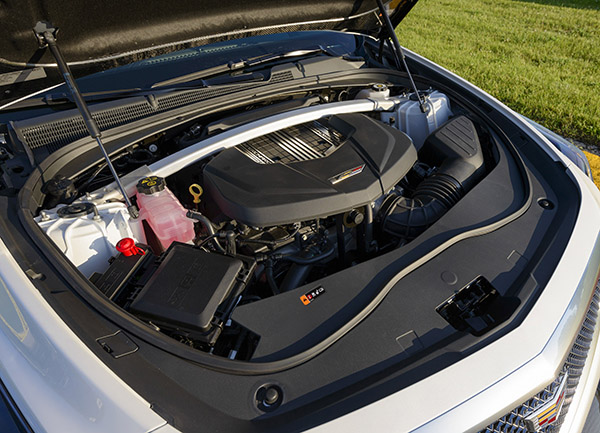

A surge or misfire sensation during steady-state highway driving may be felt on some 2014 - 2016 Corvette and 2016 Camaro and Cadillac CTS-V models (Fig. 11) equipped with the 6.2L V8 engine (RPOs LT1, LT4) and the 8-speed automatic transmission (RPO MU5). The sensation may be noticed most often in 6th, 7th, or 8th gear, in manual or automatic mode, with an engine speed between 1,000 and 2,500 rpm under load. The Torque Converter Clutch (TCC) will be engaged and there will not be any misfire data or P0300 (Engine Misfire) DTCs set.
