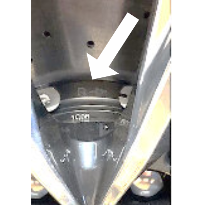

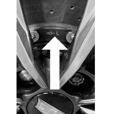

- Inspect the left and right front brake rotors for proper installation. They are marked with a directional arrow as well as a letter indicator (L or R). This inspection can be performed by looking between the spokes of the wheel, no disassembly or wheel removal is required.
Right Rotor Example
Left Rotor Example
- If the rotors are installed properly, L on the left side of the vehicle and R on the right side of the vehicle, no further action is required.
- If the rotors are installed in the incorrect location, proceed to step #2.
- Remove the left and right front brake rotors and install them on the correct side of the vehicle. Refer to Front Brake Rotor Replacement (J57) in SI.
