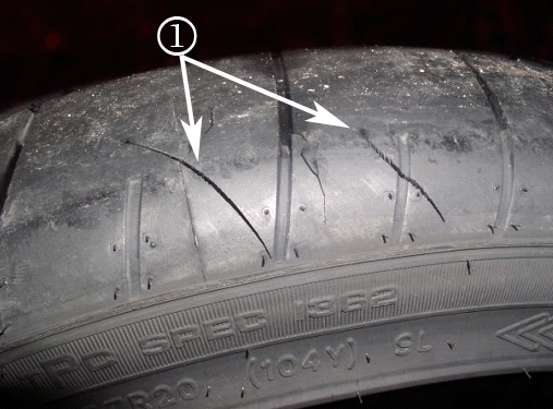

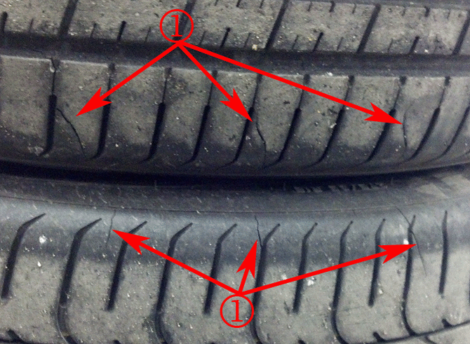

Many General Motors high performance models come factory equipped with tires that are optimized for maximum dry and wet road performance while still retaining satisfactory tread life, excellent durability and low noise levels. In winter climates where snowfall may occur these tires may be found to provide less traction. Winter tires are a viable alternative that may greatly enhance winter driving. Cold Weather Operation Important: Customers need to know that their vehicle is equipped with a high performance summer tire that will have reduced traction performance at temperatures below approximately 5°C (40°F). It is recommended that suitable winter tires (if available) be installed below this temperature. All of these tires are not intended to be driven on snow or icy road surfaces. The rubber used in these tires loses flexibility and may develop surface cracks (1) in the tire tread/shoulder area at colder temperatures. Refer to the photos below for examples. Important: While the cracking will not result in air loss, it is damaging to the tire. Tires that have been used in cold climates and exhibit tread cracks should be discarded. This is not a warrantable item if the customer has driven the car in temperatures below approximately 5°C (40°F). Tire Surface Cracks
 Surface cracks are cosmetic and will not result in a loss of air, however special tread and compounds used on these performance tires will cause a decrease in performance in cold climates. Driving with high performance summer tires on snow, ice or cold road surfaces may cause loss of control. Refer to the latest version of Corporate Bulletin Number 04-03-10-013: Driving Characteristics of Rear Wheel Drive Vehicles and Available Winter Tires for further information on available replacement winter tires for cold climate operation. Additionally, dealers in the United States may call the GM Tire Program at 877-728-4737 for help with late season tire availability or substitutions.
