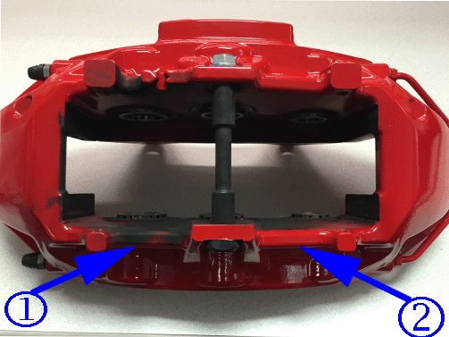

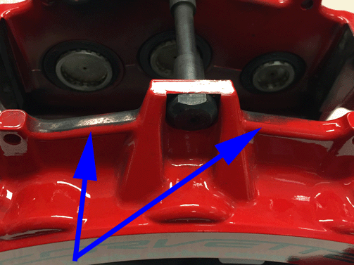

![]() Some customers may comment on a discoloration or black stain on the paint of the brake calipers. |
Cause |
This may be caused by high brake pad temperatures during aggressive driving or track event tarnishing the caliper paint. |
Correction
Important: Do NOT replace the brake calipers for this condition.
This is not a defect in the paint or the caliper.
(1) Not cleaned using mild polishing compound (2) Cleaned using mild polishing compound If the customer wishes to have the black stain removed, a very mild polishing compound can be used to remove the stain.
Important: Do NOT use harsh chemicals or brake cleaner to attempt to remove the stain. This could damage the paint on the caliper.
