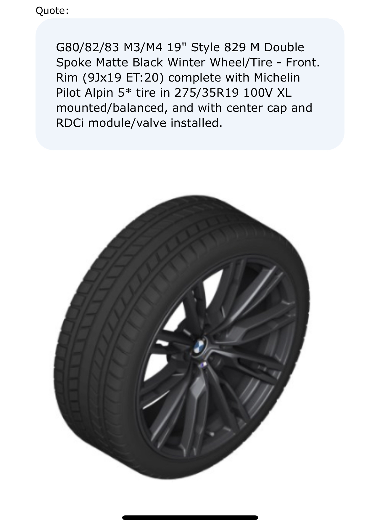

I got all excited before bc i thought my g80 bmw winter set would work but at the very end i realized the bolt patterns are different. The 5bw is 5x120 right?
BMW 5x120 should work pattern wise. Kicker is whether or not they'll clear the brakes. The fronts will be about 12mm sunken in and rear will be about the same as the stock wheels poke wise with those 19x9 +20. Overall tire diameter will be about the same. Just toss some hubcentric rings on those wheels since the hub bore is smaller on the Cadillac.
