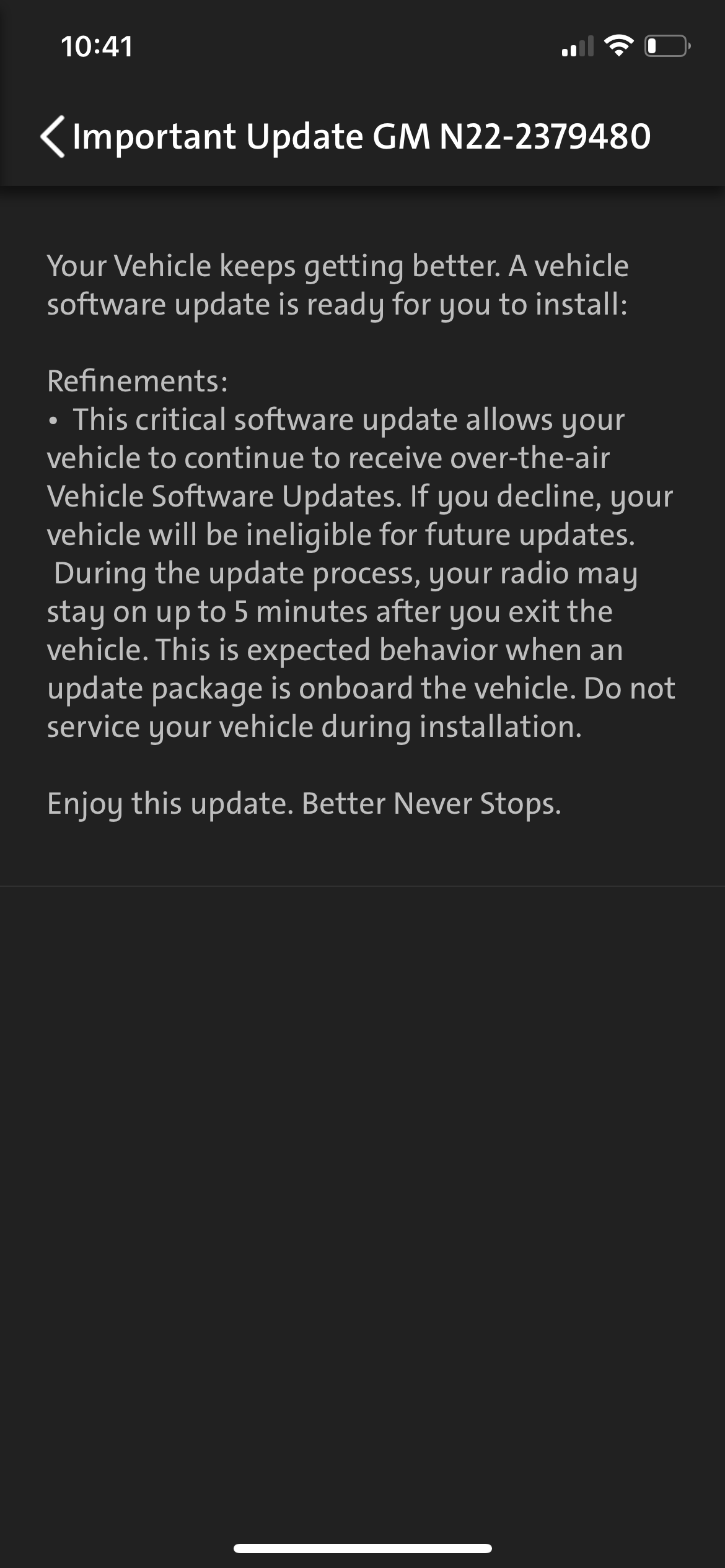

I just got a notification for this update....I don't have the car with me....did anyone try it yet?
I got the same notice this morning. Haven't had time to do yet.

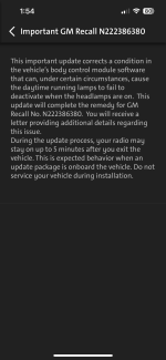

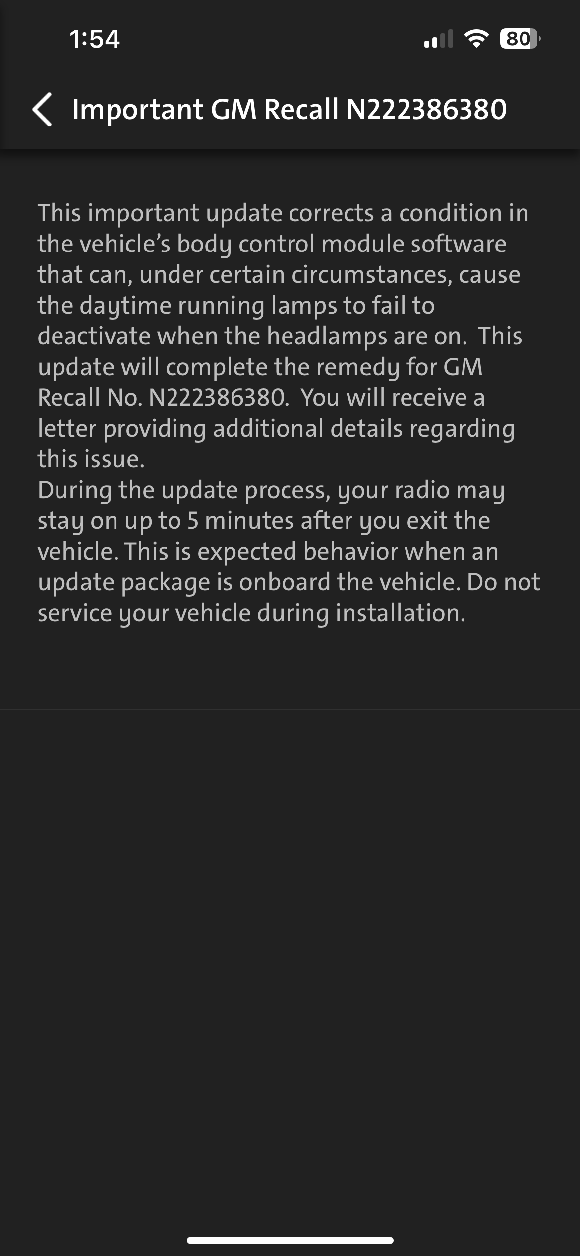

I just installed it. The description is the DRL recall but the app is still showing the recall is needed. Maybe that takes time to update...

The dealer did mine last week Thursday or Friday, and said it takes a few days to update in the system. My Cadillac App still shows 'Non-Compliance Recall'. I find this stupid and likely human related. If the data is input, the system should be updated.

The recall warning is now gone from the app too. Makes me happy. I didn't want to do the 50+ mile roundtrip to the dealer just for an update that can be done with a flash drive.

I did the DRL recall update on Friday afternoon and the notice in the app didn't clear until the following day.

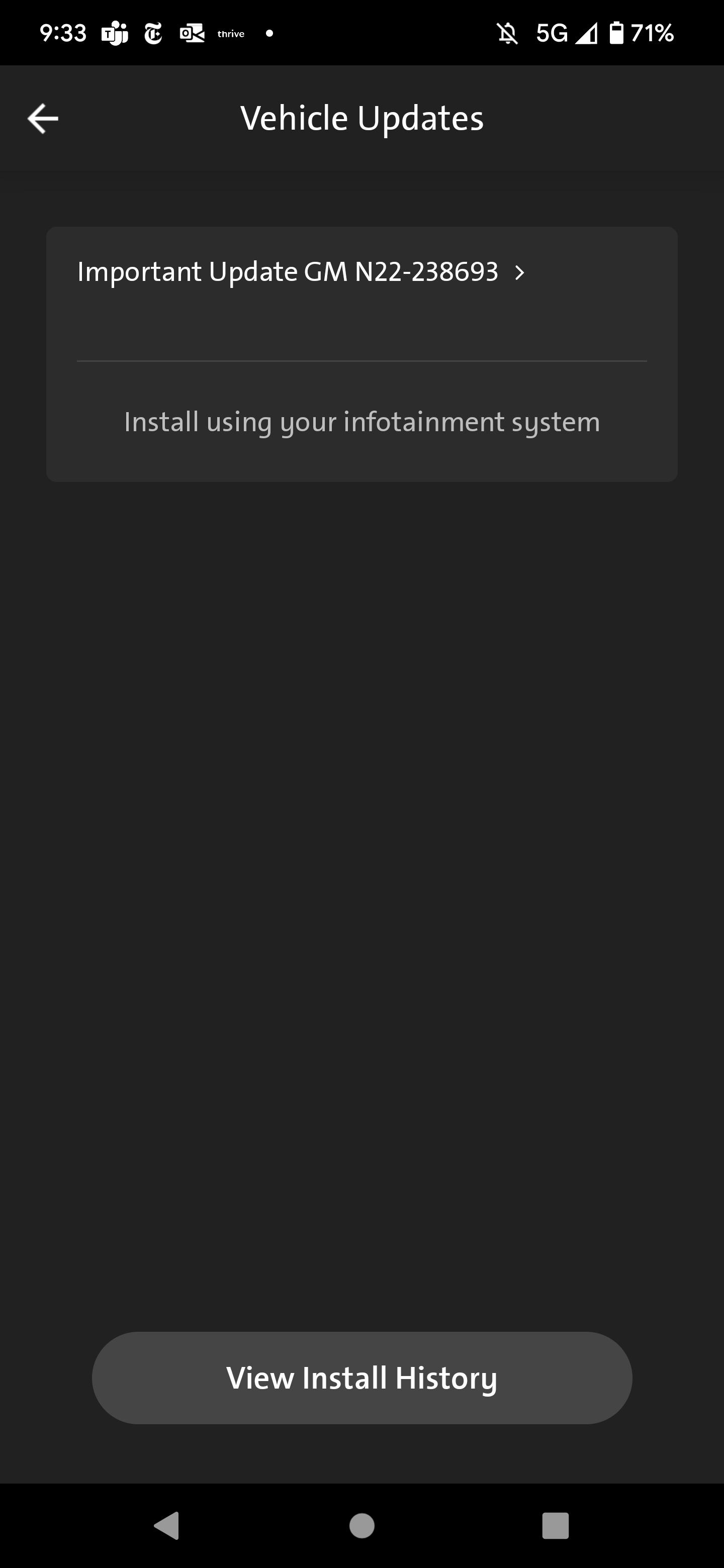

Did mine today as well. "GM N22-238693" - "A variety of software improvements to make your in-vehicle experience better." Sounds like an infotainment update.

LOL, tried the GM N22-238693 update today (popped up as available yesterday) and got a failure. Tried several times with same result. One time it said something like the car was not in a state where the update could be done (whatever that means). Eventually, it said if the problem continued, see the dealer. Then, it acted like there was no update to do and when I asked it to look for updates, it said there were none to be found. I'll let some time go by and see what it does.
Did the update today. The car will be disabled for up to one hour while the update occurs. It looks like the update needs to be manually confirmed before it will install.
I have found that updates often fail when I am parked in the garage even with excellent WiFi connection. But leaving the car outside in the driveway for the update has never failed. Seems that some form of connectivity to GM cell/satellite network is required where weak or no signal will cause it to fail. At least in my experience.
