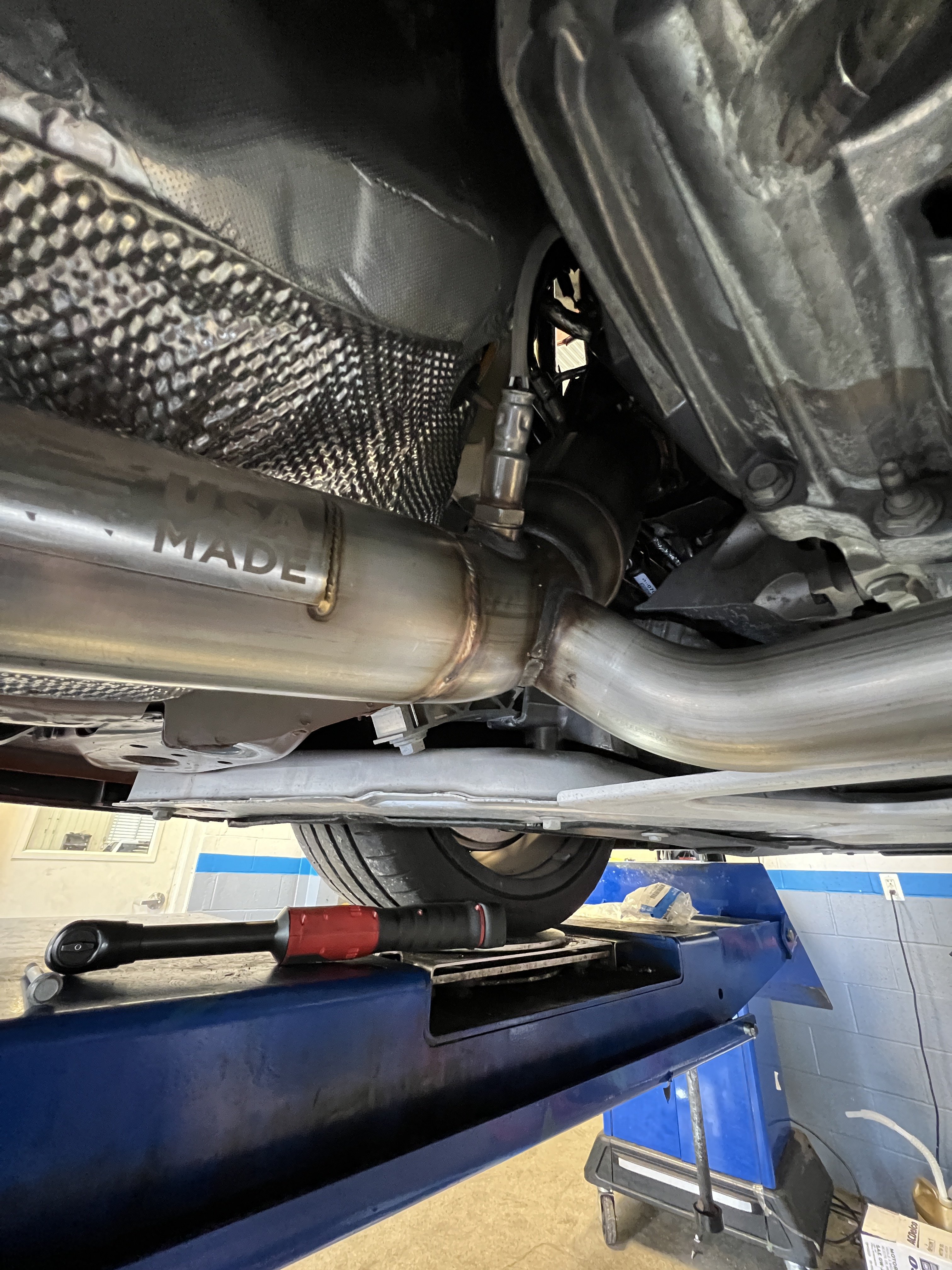

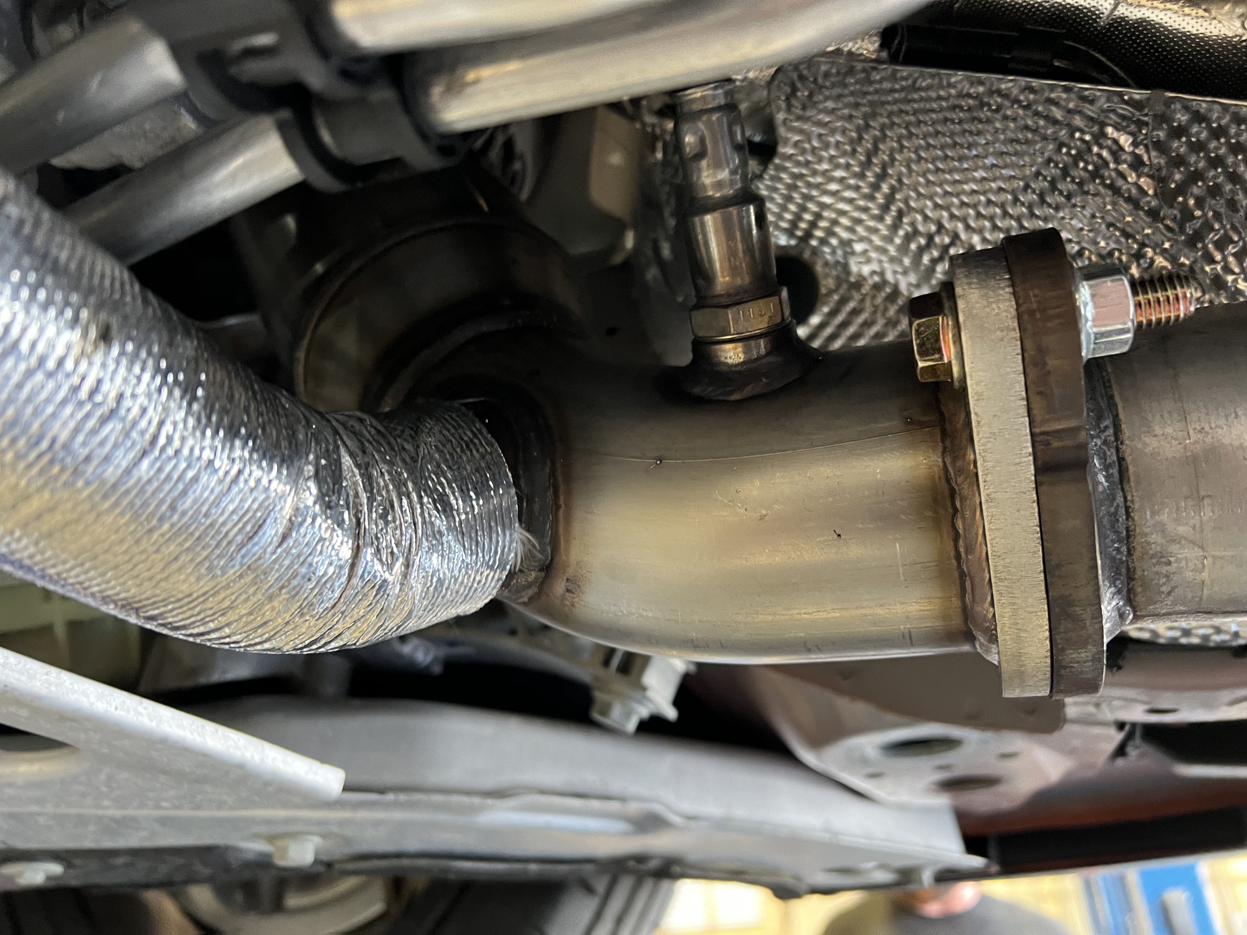

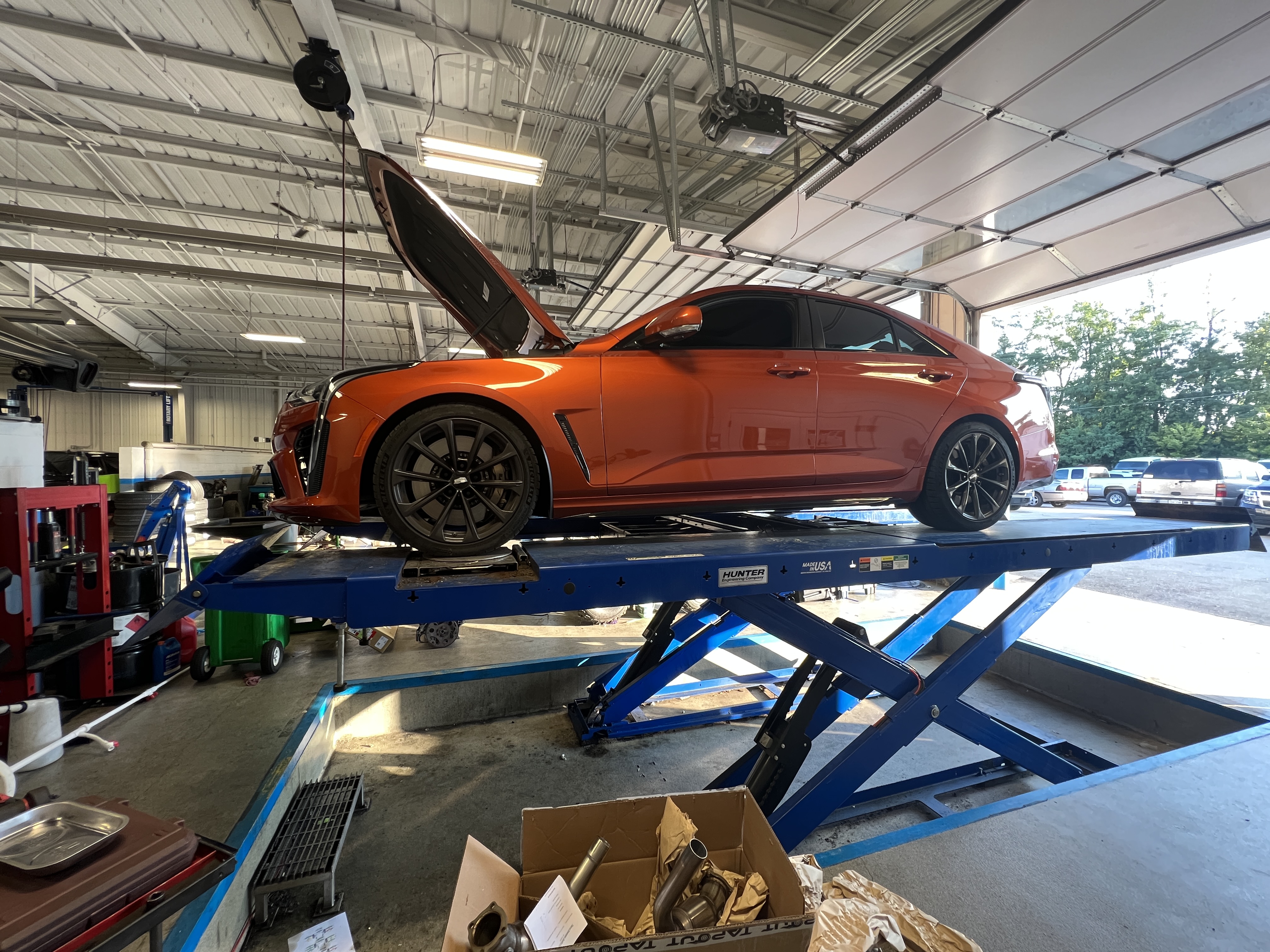

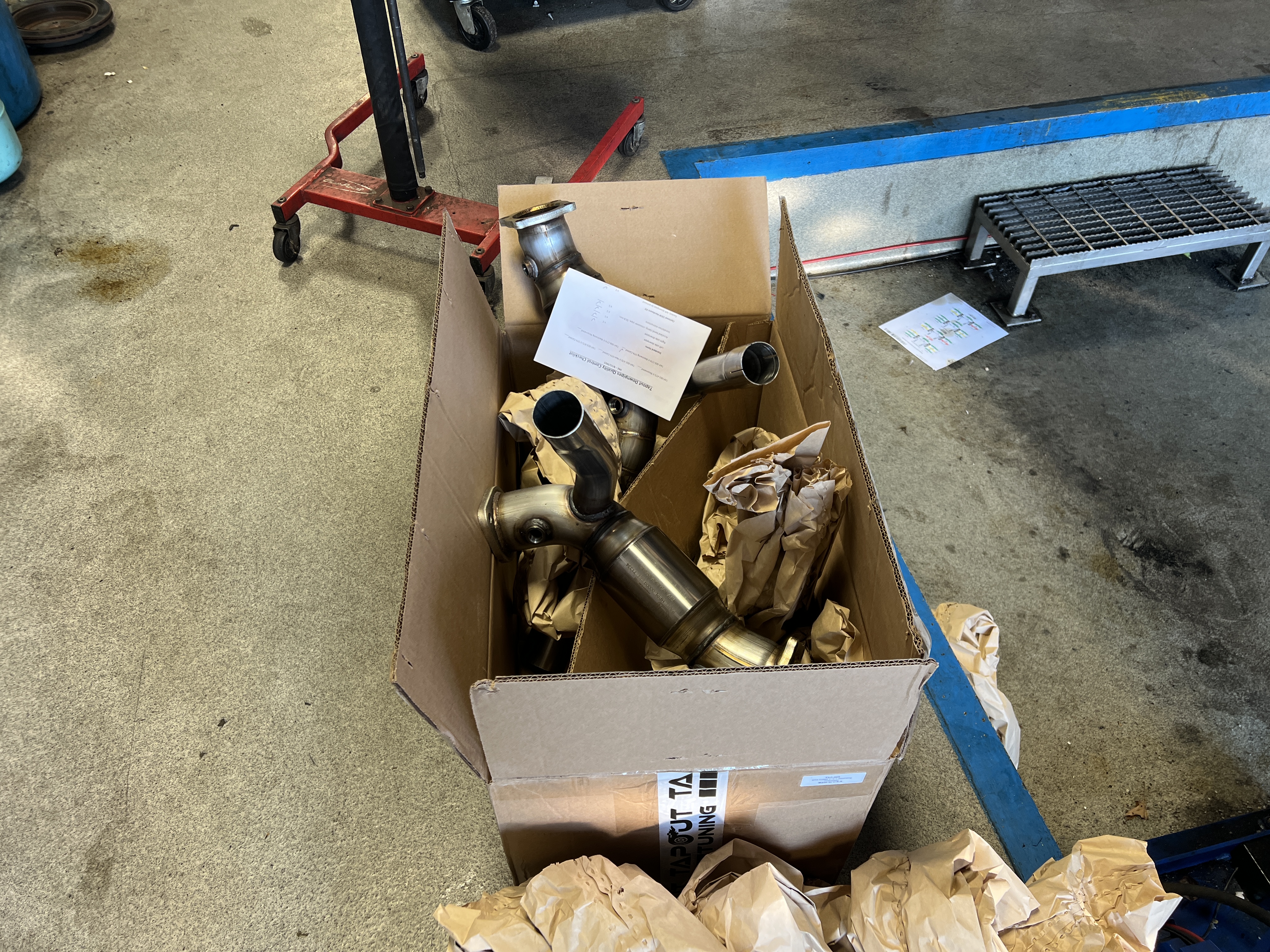

Was able to install on Saturday, fit and finish was great. No Cel light etc...
I'll try to get some better video/audio in the next week or so, drivebys etc....
Imo I'd say they're about 50% louder then stock fully open, but you can definitely hear the turbos now.

View attachment 12221View attachment 12222View attachment 12223View attachment 12224
How was the bending of the transmission lines, that part has me a little spooked and can you post an update after 200 miles on whether the cel light comes on?

I don't think it was that bad. My Master tech did pretty much everything. He said the hardest part was getting to the o2 sensor underneath the car. It took him about 2 hours, it would have taken me double.....I don't have the patience.
I'll definitely update after a couple hundred miles.
