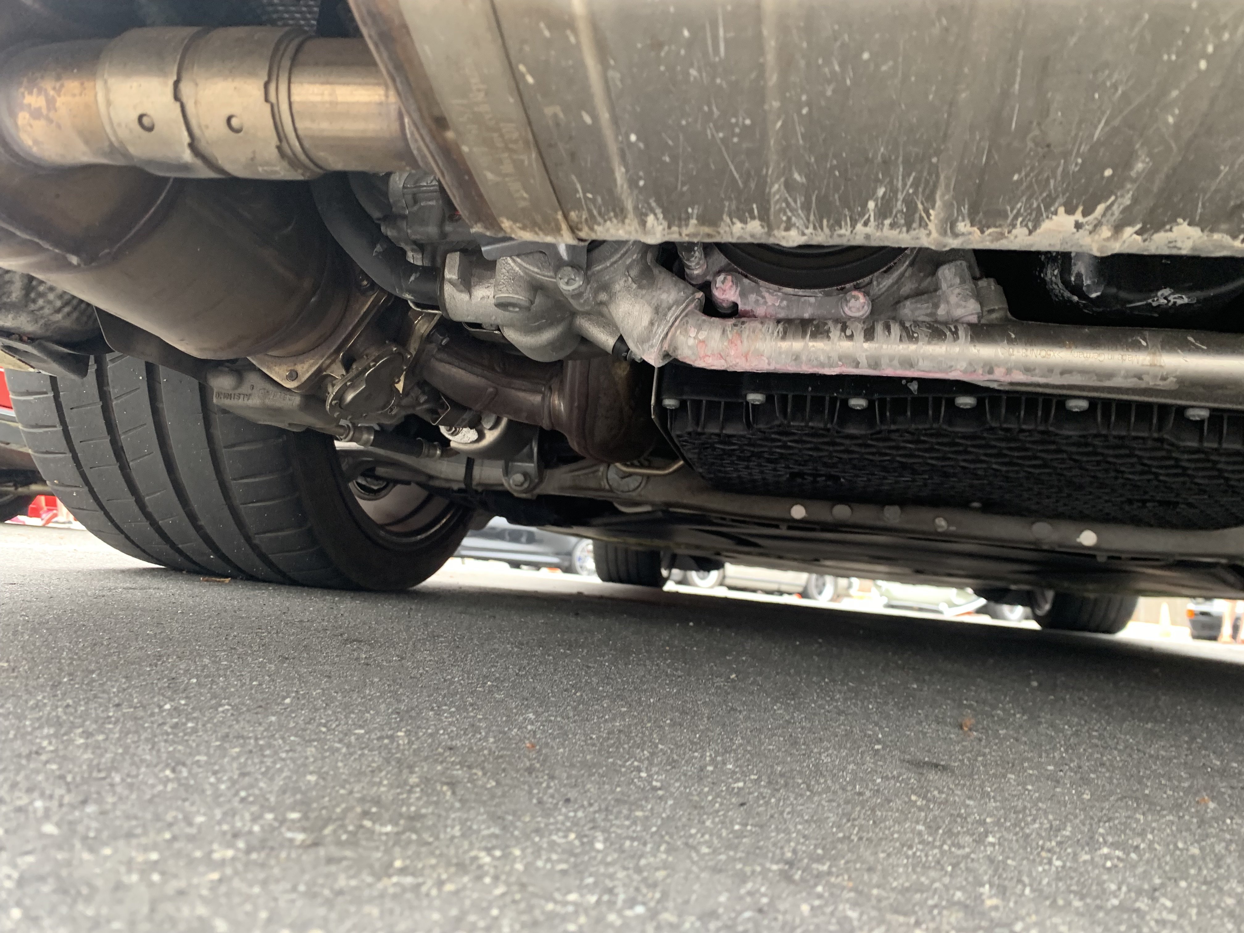

1640 miles and I got a CEL with a "Reduced Power, drive with care". Coolant all over the engine bay. I'm not sure how serious this or if it caused any damage since I only drove it for another few mins till I could pull off the road. Time for a tow.

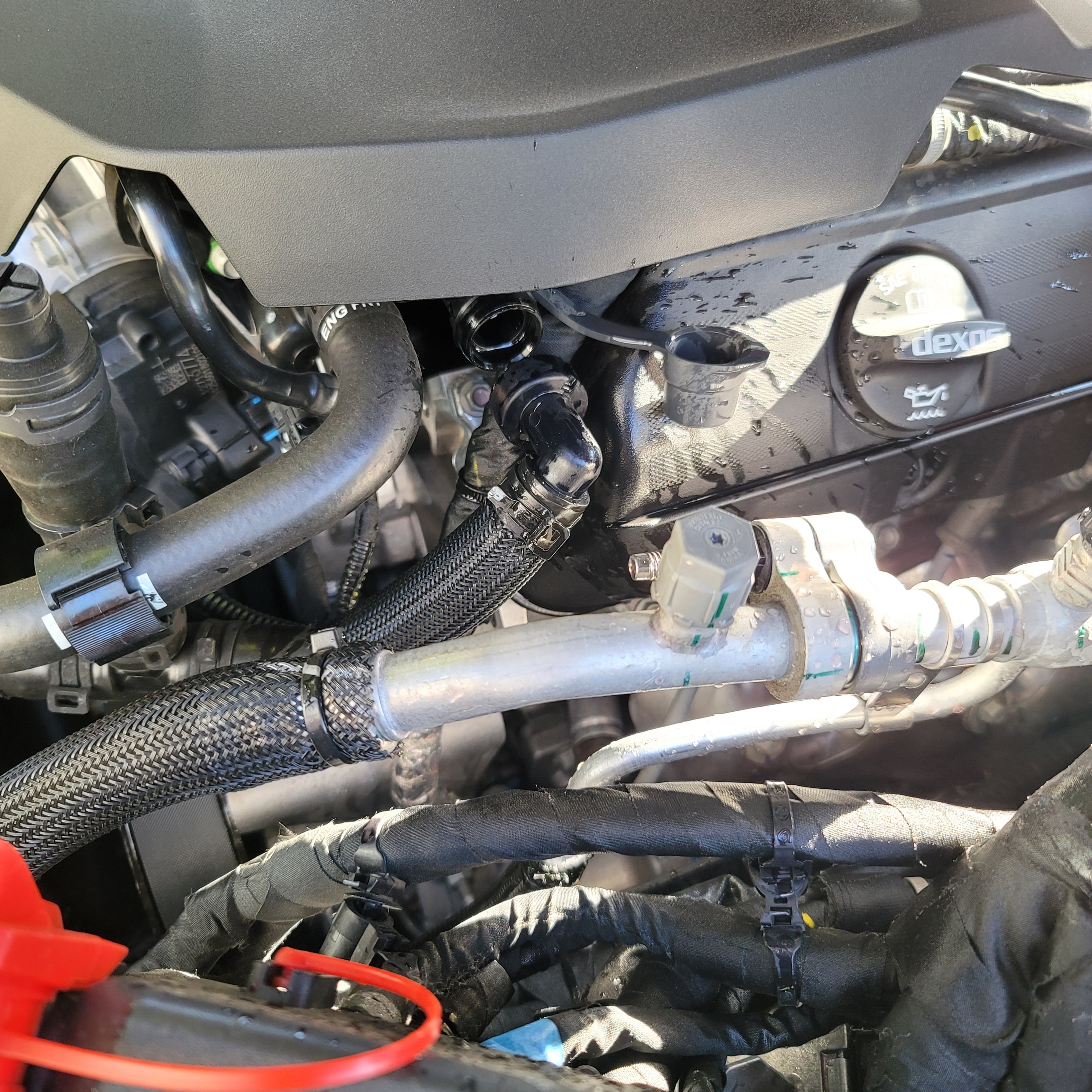

Why does it look like a cap right next to the connection that failed?
I think that cap covers the Charge Air Cooler fill port. It must have blown off along with breaking the pipe. What could have caused that much pressure is what I'm concerned about.

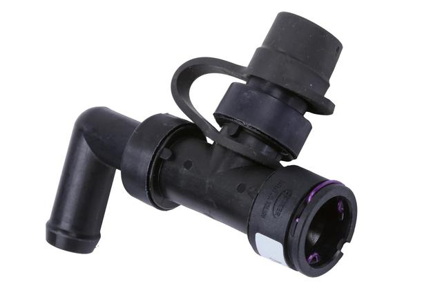

Folks, I got my car back last night and here was the culprit... Fitting - GM (84318275). Same $67 part found in the V3. 🤦🏻
This particular replacement part has a white USA sticker on it.

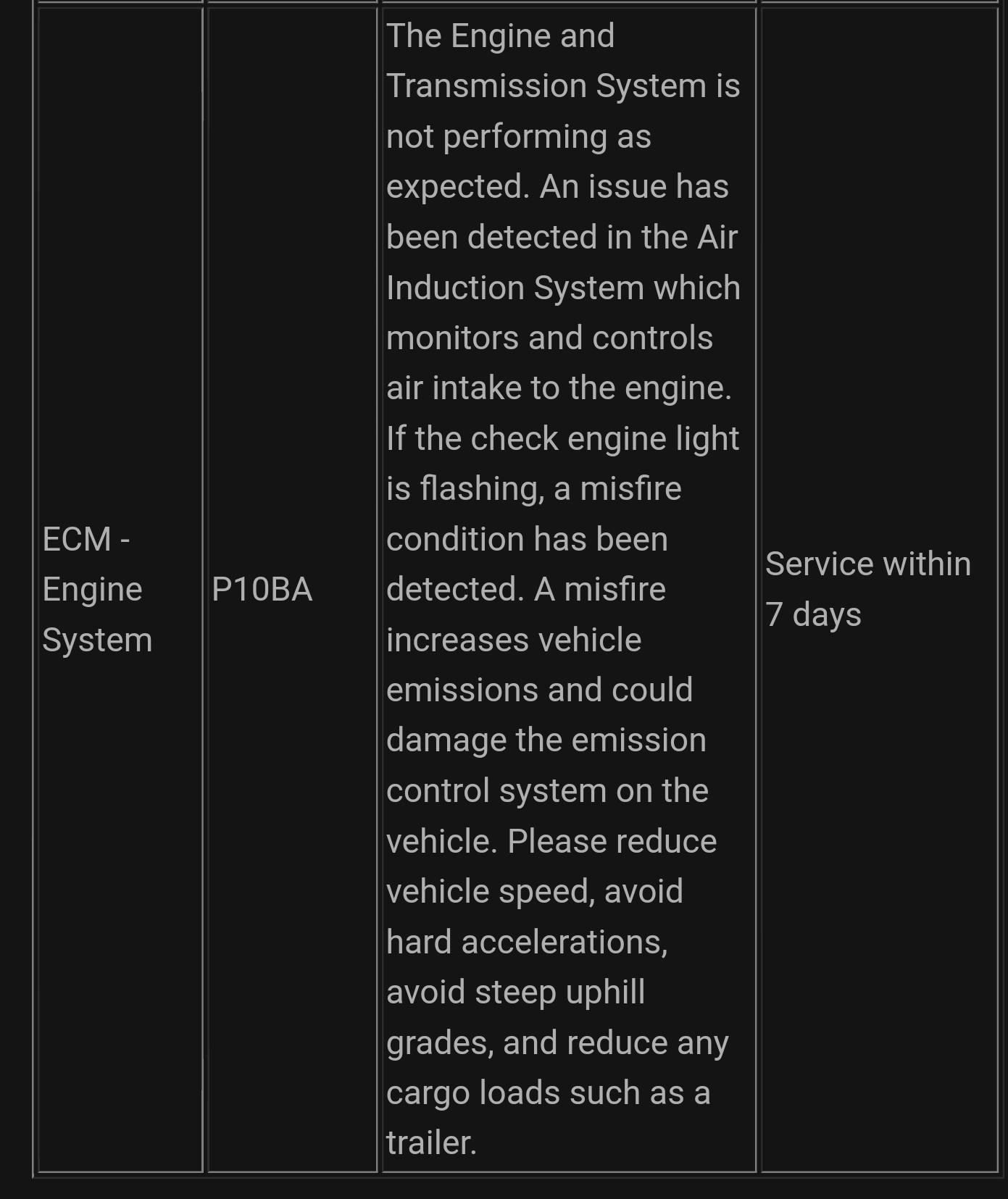

I just got the same CEL while on highway.
Called OnStar; they emailed me this:
