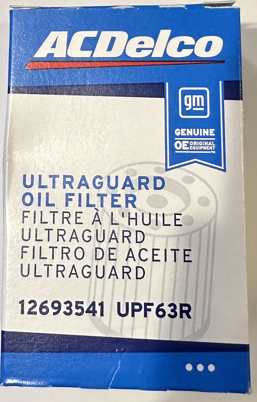

I suggest that you use UPF63R - Part #12693541, it is the better filter. And while you are at it, make sure that the oil is Mobil 1 Supercar 0W-40. You will need 7 Quarts. Of course the case is sold with 6 quarts. This stuff is hard to find.
Filter online @ AutoZone
Oil online @ Speedway Motors
Just make sure that if you use an independent service shop, or a GM dealer that they will use your parts.

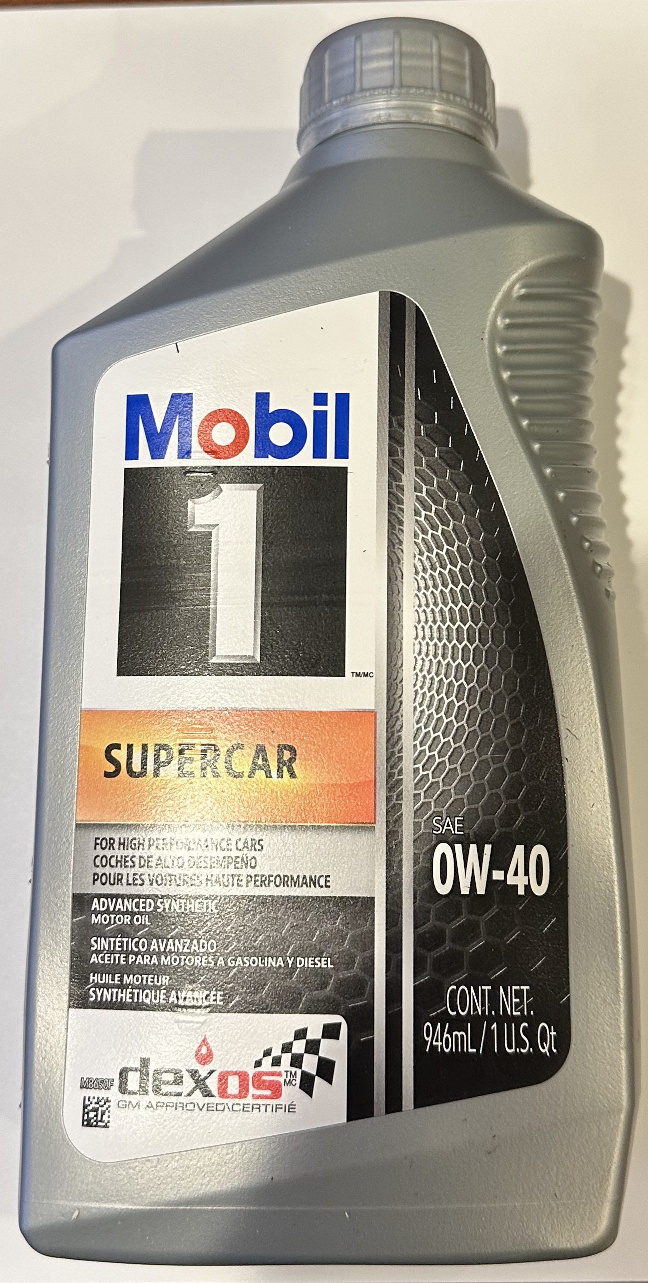

Owner's manual and oil fill say 5W-30 weight oil, not 0W-40. I do have some PF63 coming from Summit Racing that are in Delco's "Gold" filter line. Don
The 5W-30 grade is the minimum spec. 0W-40 grade oil provides a wider range of operating temps, as in it's a better oil that the minimum required. The Cadillac V-Club had a presentation from Mobil-1 earlier this year. They provided a bunch of info. Including the fact that GM changed the specification which led to dexOS R versus the old desOS 2 - reference gmdexos.com There is only one certified oi Mobil 1 Supercar 0W-40 or 5W-50. Since you are in Texas, you can use either although 5W-50 would be better in the Texas heat.

UPF63R is a Mobil 1 filter with a Delco Gold sticker on it

Do you have a service bulletin or something that says those viscosities are good for use on a 4BW? And from what I can tell, the only diff on the 63R filter is the bypass pressure.

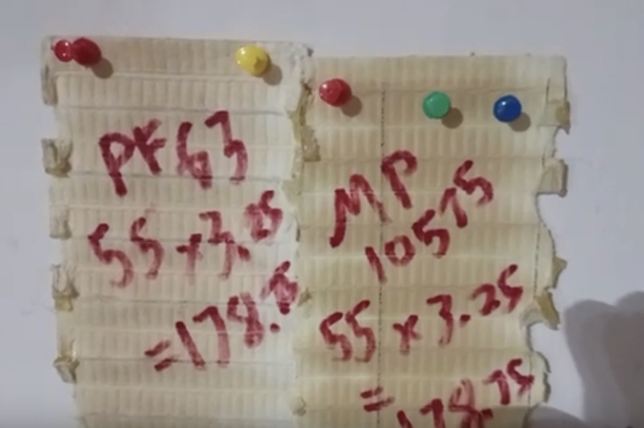

Yeah, couple interesting takeaways worth considering. The thicker body is where the weight comes from, hence the heft.
More importantly for me though, the standard PF63, at least the part number in the manual, actually has MORE filtering surface area than the UPF63R and a nearly identical particle filtration rating, ~30 microns.
UPF63R (per your linked vid) - 45.5" x 2.75" = 121.125 sq in.
PF63 (part# 12707246) - 55" x 2.75" = 151.25 sq in.
These numbers came from a vid on the PF63 but the guy measured the entire width of the filter media @ 3.25" and in the UPF vid the guy measured between the endcaps which IMO is more accurate so I knocked .5" off the measured width of the PF63 for apples/apples.
Aside from the heavier body and higher bypass ratio on the UPF, the only other difference I can see is the thicker rubber base gasket. The filter media is also different but has the same micron rating as the media on the standard PF63 so no clear indication one is better. So clearly this filter is meant for higher pressure operations but whether or not that actually matters when the standard PF63 is good to a rated burst pressure of 253.8psi is for you to decide.
More importantly is whether it is actually a better a filter and not just a heavier duty filter and I dont really see the evidence for that.
