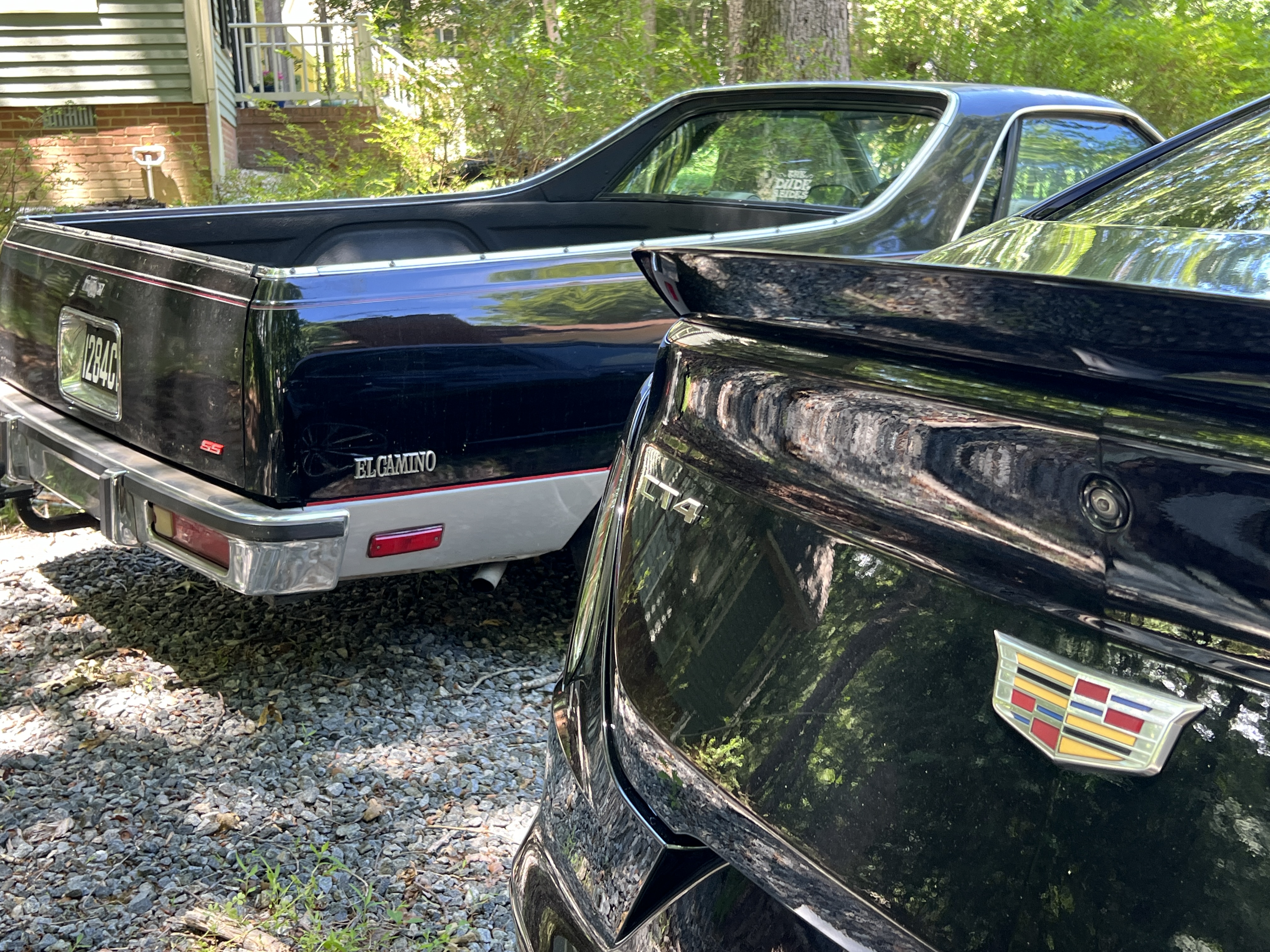

Gawd I know peeps get tired of me going on about my caddy & camino. lol : )
IDK..., I have the $3k seat option in my car, and they are very comfortable, and have every option except for giving me a hand job...., that was an extra $400 . : )
