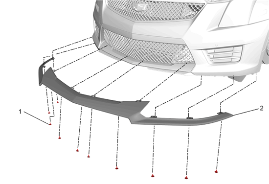

The 2016 ATS-V and CTS-V models have a front spoiler, or splitter, delete option (RPO R6G) available when ordering a vehicle. These V-Series models have a base splitter (RPO C43) (Fig. 1) and an available carbon fiber splitter (RPO CFZ).
attachment.php
Fig. 1
The vehicle pricing includes the base splitter, so dealerships that order any vehicles with the splitter delete option will be supplied with a base splitter that can be installed at the dealership. (Fig. 2)
attachment.php
Fig.2
The Order Guide and other communications will cover this order concern. Overall, the number of V-Series models built and shipped without a splitter will be limited.
