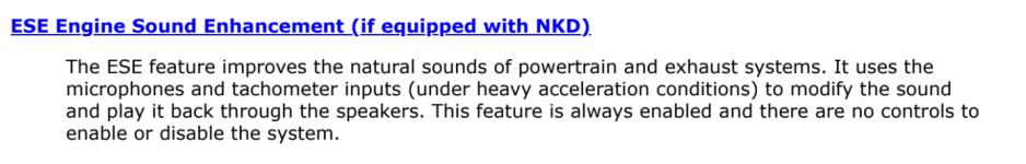

I do not believe the CT5VBW has any extra noise pumped in through the speakers. I installed an amp and sub, and dove pretty deep into the wiring diagrams. I see no microphone, and the RPO code for engine sound enhancement isn't on CT5VBWs.
there's a mic that picks up the actual engine noise coming from the car and puts it through the speakers.
I checked every wiring diagram and wiring harness diagram in the factory service manual, and there is no microphone other than the 3 ANC mics and the 2 mics for phones. The RPO code for engine sound enhancement is not installed on the blackwings.
After an exhaustive search, I only see NKD as an option on the CT6.
Savage Geese mentioned it was piped in noise, but Throttle House said it was not and complained about how you couldn't hear the glorious noises in the cabin.
