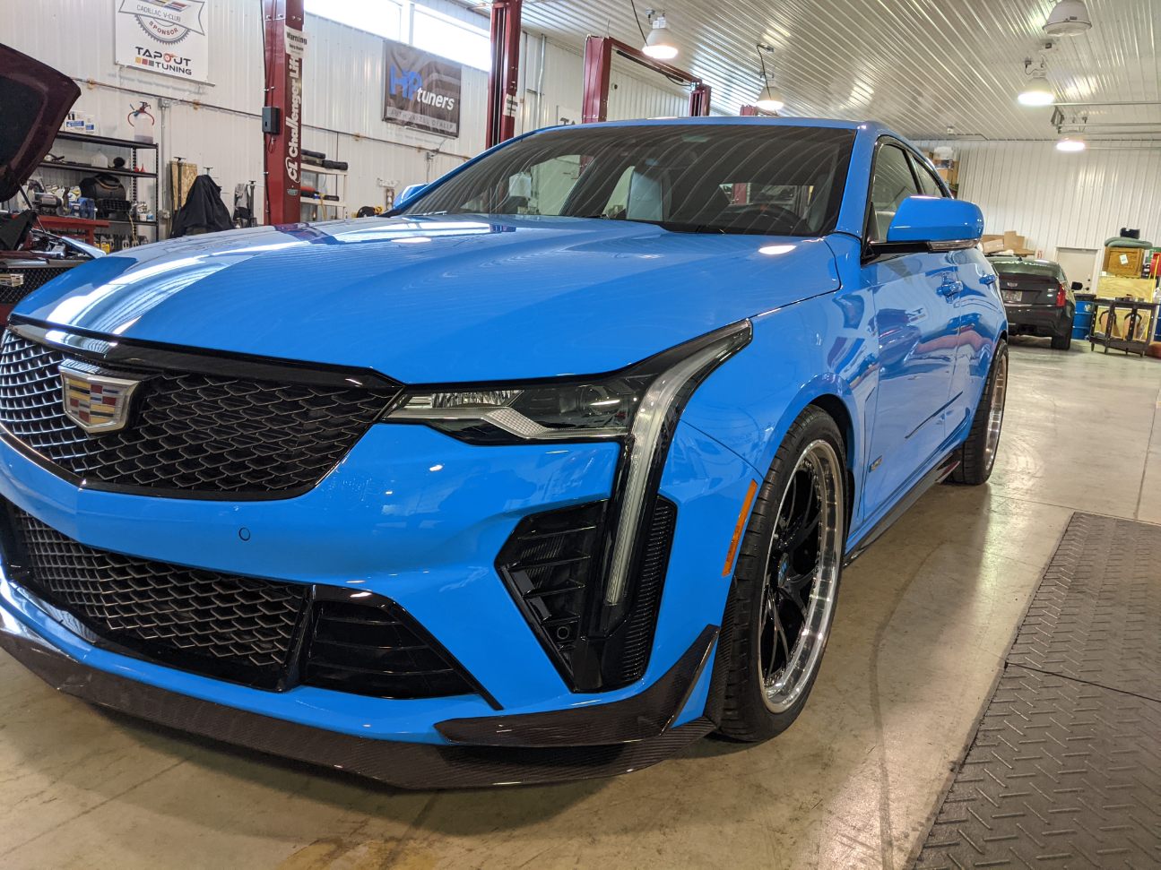

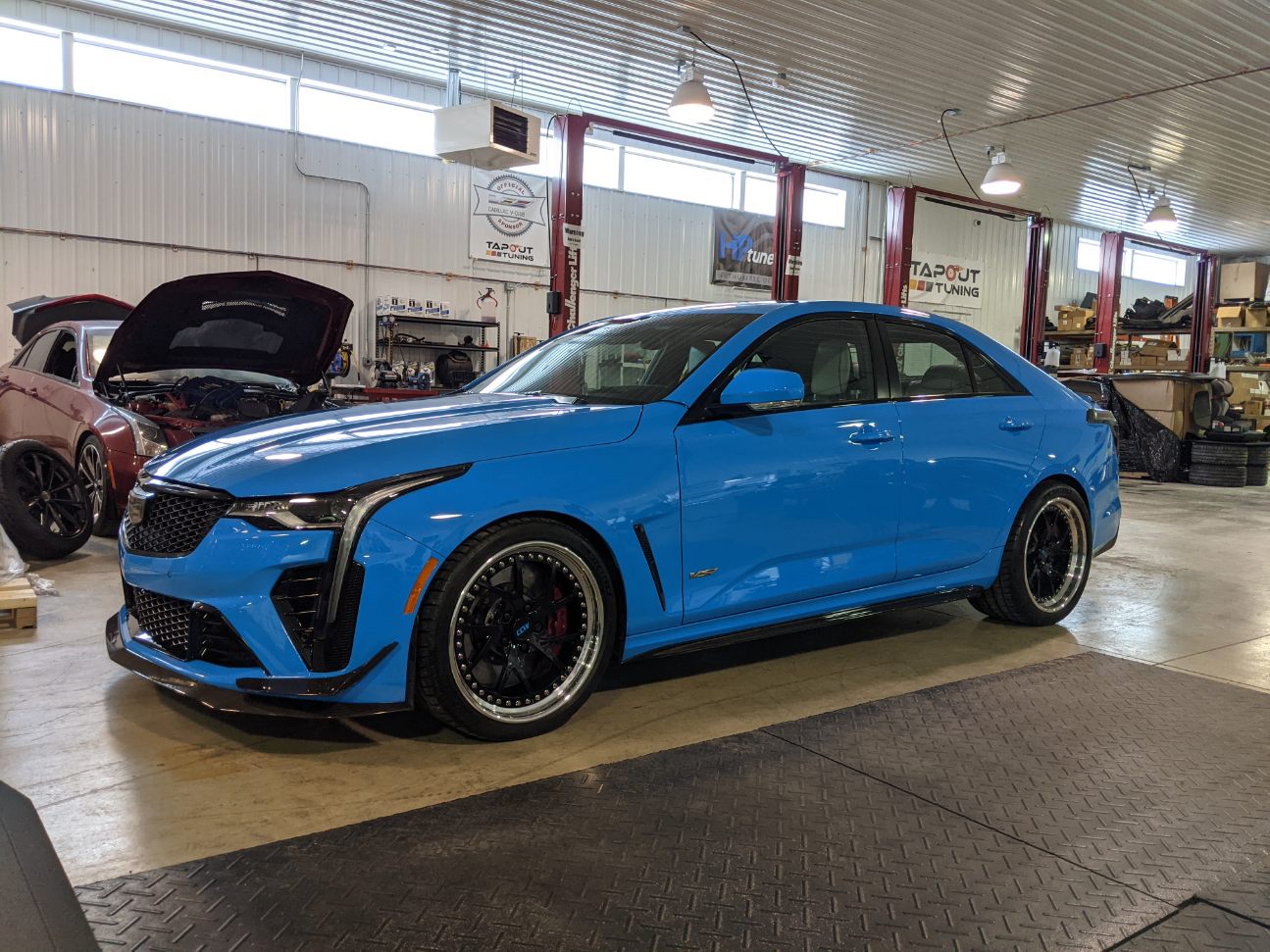

I had some custom ATS-V wheels that I was able to make fit via the use of longer wheel studs and some spacers.

I'm running P275/30ZR19 on the front, and P305/30ZR19 on the rear. I love how these fit the car!

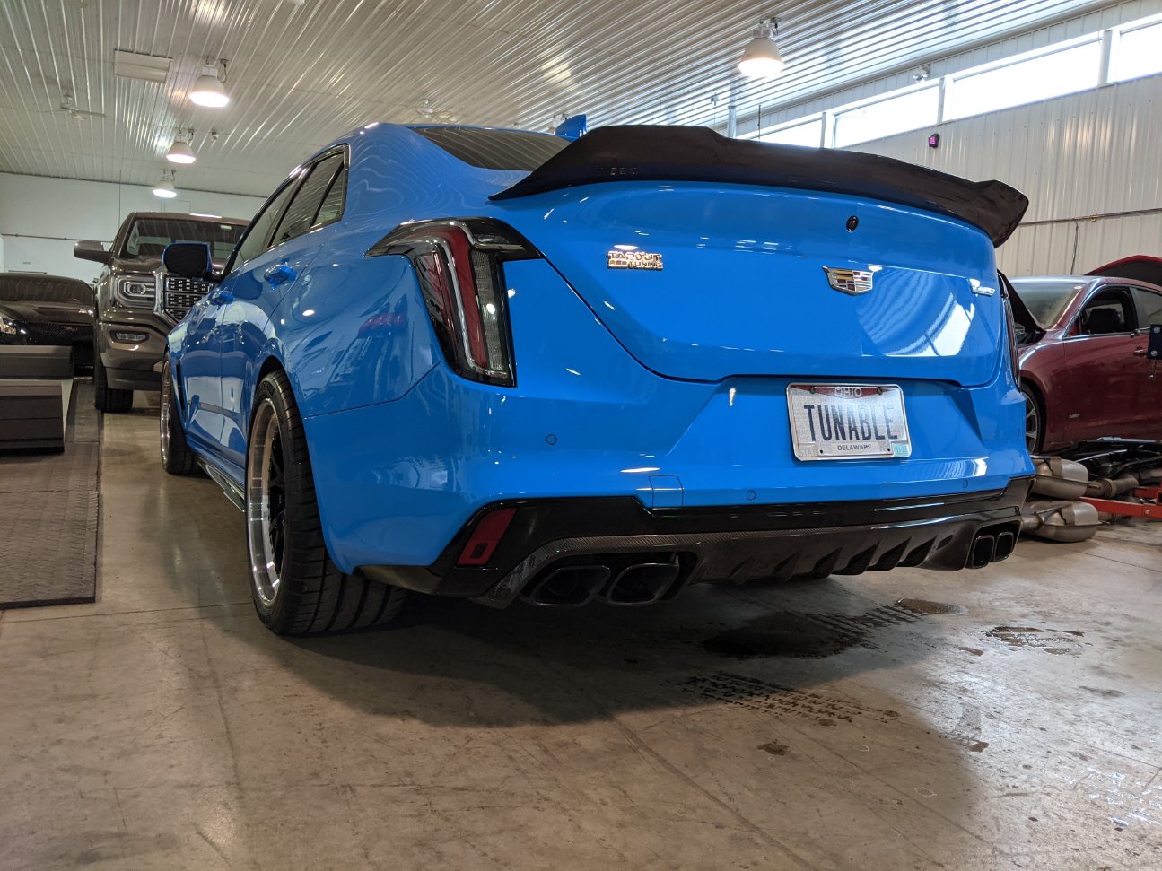

The front sits perfect, but (personal opinion) I think the rear sticks out a 1/2" too far.
I am also wondering if there is enough room inboard in the rear to tuck a wheel in and still be able to run the 295s I want to run with less poke than you have.

My sizes and offsets aren't perfect, since we retrofitted wheels and tires from another application.
On the front we used 19 x 9.5" (+24), with 1/8" wheel spacers. On the rear we used 19 x 11" (+55), with 3/8" spacers. So our final sizes, including total offset work out to be 19 x 9.5" (+21) and 19 x 11" (+45).
You could use those numbers as your starting point. But I would still recommend working with a wheel specialist on this.

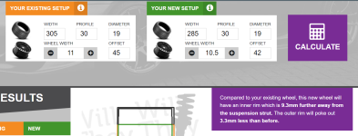

I'm looking at a 10.5" rear with a +42. Overall would tuck me in 3.3mm more than yours is in the back. I was going for flush, but I cant get that with concave. I guess I figured with a 1/2" less width and 3mm less offset I'd tuck more than that, I guess not. Here's my comparison to yours. 3mm is not even noticeable. I may bail on that size.
