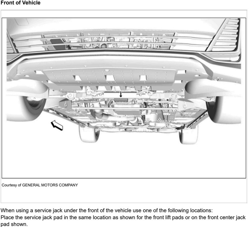

Grooved hockey puck and a regular floor jack. Use the groove on the rear chassis brace, and as a regular pad on the front flat.Instead of starting a new thread, I am piggy backing this.

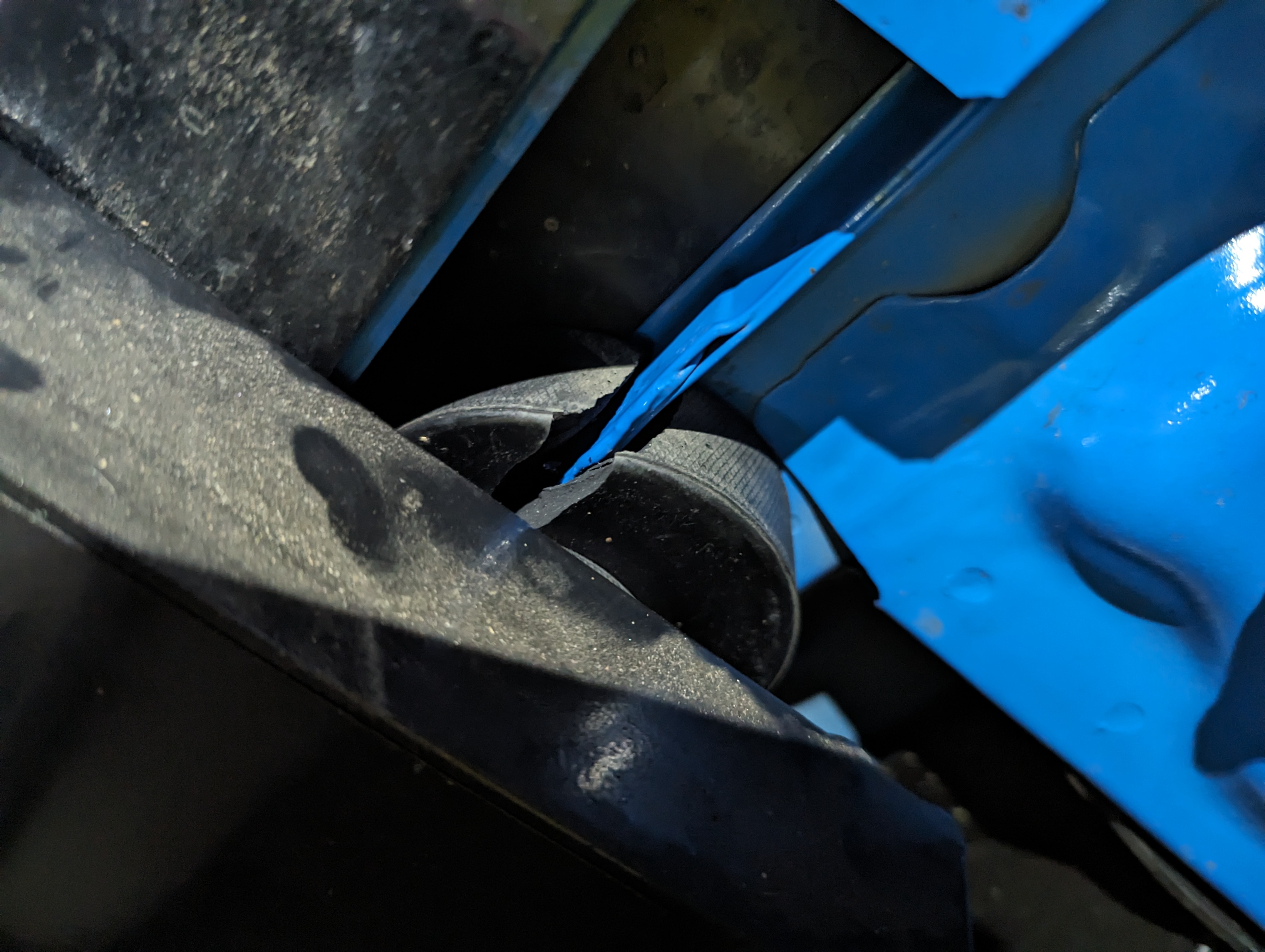

While at Spring Mountain I asked about a safe jacking and support location. They said they lift the C8 by the aluminum subframe in the front and that it would likely be safe to do the same on the CT5 BW. Well, it didn't work for me. Tried to lift in one place, slightly bent. Tried to support...www.cadillacvnet.comJacking up your Blackwing

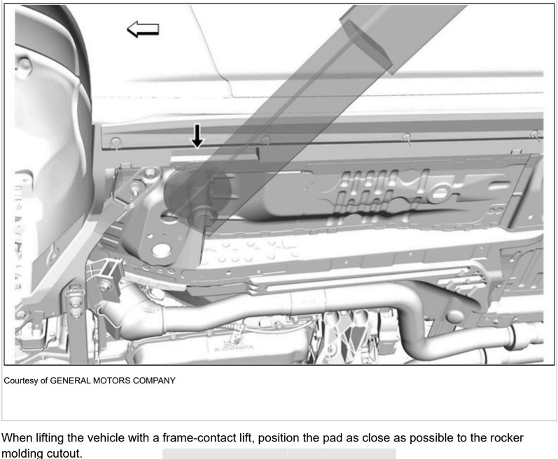

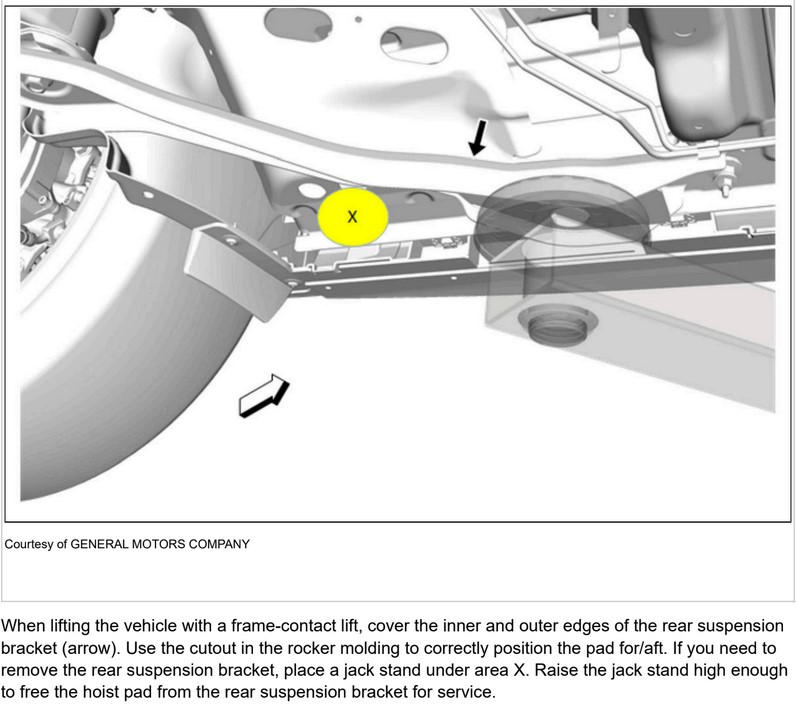

IRT CT4 in general, Mirza did provide a pretty detailed description of where to lift from
https://www.cadillacvnet.com/forums/threads/jacking-up-your-blackwing.2554/page-19#post-87315
https://www.cadillacvnet.com/forums/threads/jacking-up-your-blackwing.2554/page-19#post-88160
I'll guarantee you will get crushing if you jack on those spots only. My local dealer unwittingly proved that on my car.Dunno about that, this ATS looks awful completed to me but I agree it looks to be supported in multiple places
