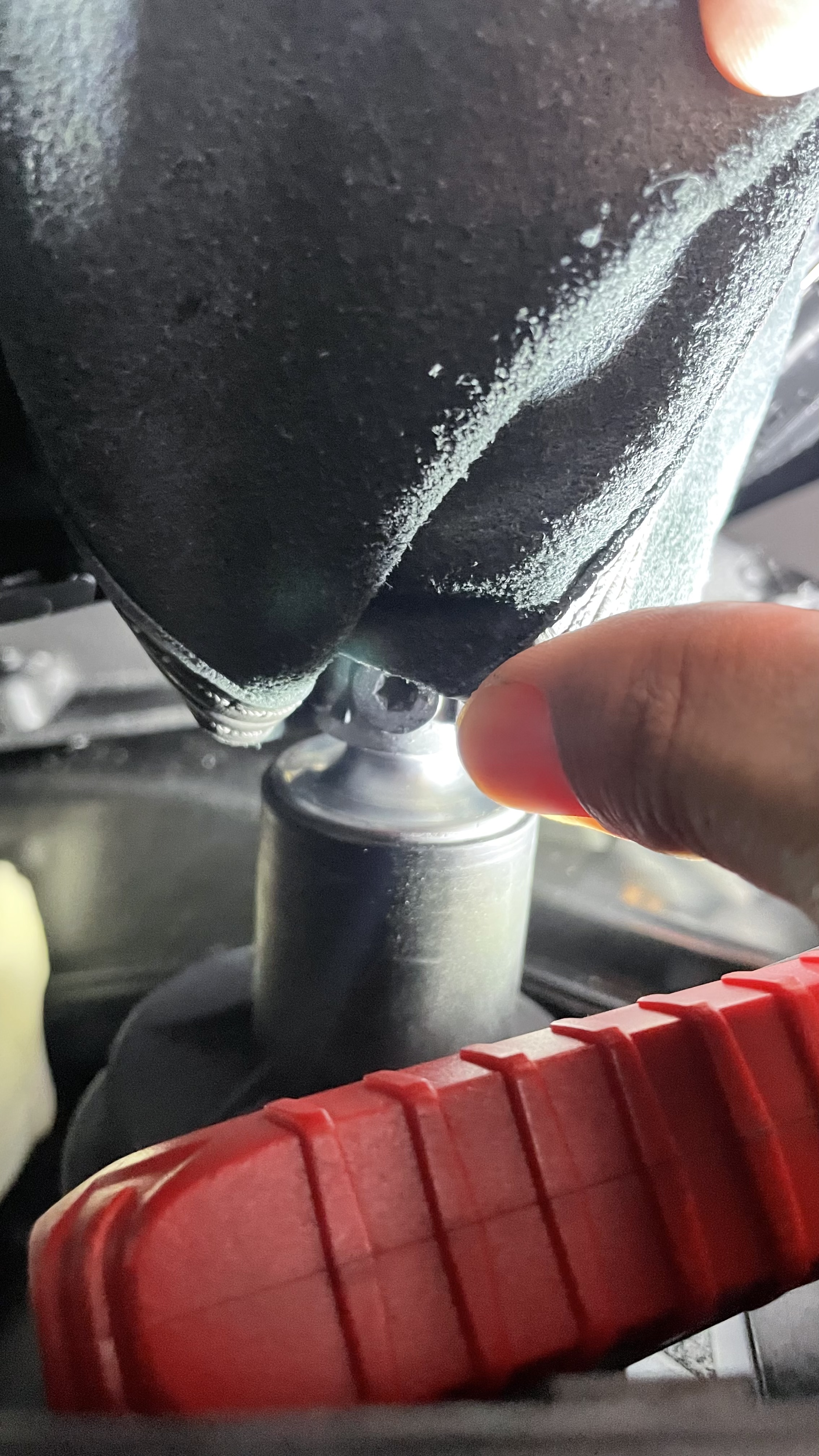

If its the same as 5BWs, theres a T20 or 25 torx holding the shift knob in place. Didnt mess around too much on how to separate the knob from the boot.
Do you have a pic of where? I’m not seeing any exposed set screws on mine

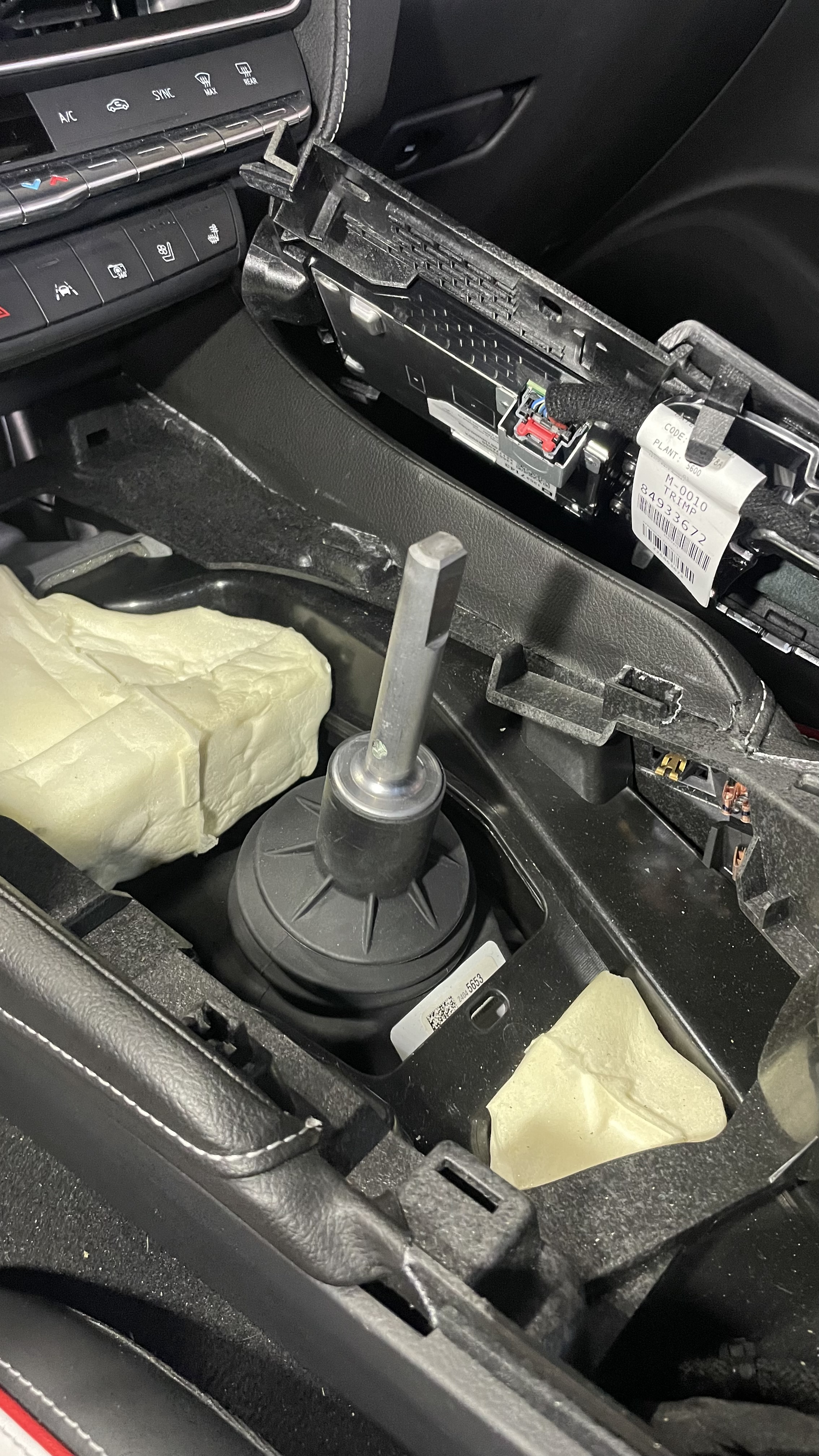

Anyone able to provide a step-by-step on how to remove the trim to access the torx screw? I'm going to switch my alcantara one to leather as it annoys the piss out of me.
Here I used the forum search feature. I have removed the trim panel and shifter assembly from my 5BW and I can assure you the attachment is the same as the Camaro. I'm not sure the knob can be separated from the boot, but good luck.
